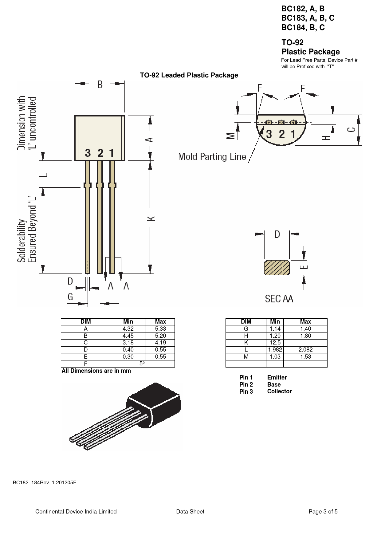

Pages / Page5 / 3 — BC182, A, B BC183, A, B, C BC184, B, C. TO-92 Plastic Package. TO-92 …
File Format / SizePDF / 116 Kb
BC182, A, B BC183, A, B, C BC184, B, C. TO-92 Plastic Package. TO-92 Leaded Plastic Package. DIM. Min. Max
BC182, A, B BC183, A, B, C BC184, B, C TO-92 Plastic Package TO-92 Leaded Plastic Package DIM Min Max
For Lead Free Parts, Device Part # will be Prefixed with "T"
Pin 1: Cathode Pin 3: Anode
DIM Min Max DIM Min Max
A 4.32 5.33 G 1.14 1.40 B 4.45 5.20 H 1.20 1.80 C 3.18 4.19 K 12.5 D 0.40 0.55 L 1.982 2.082 E 0.30 0.55 M 1.03 1.53 F 5º
All Dimensions are in mm Pin 1 Emitter Pin 2 Base Pin 3 Collector
