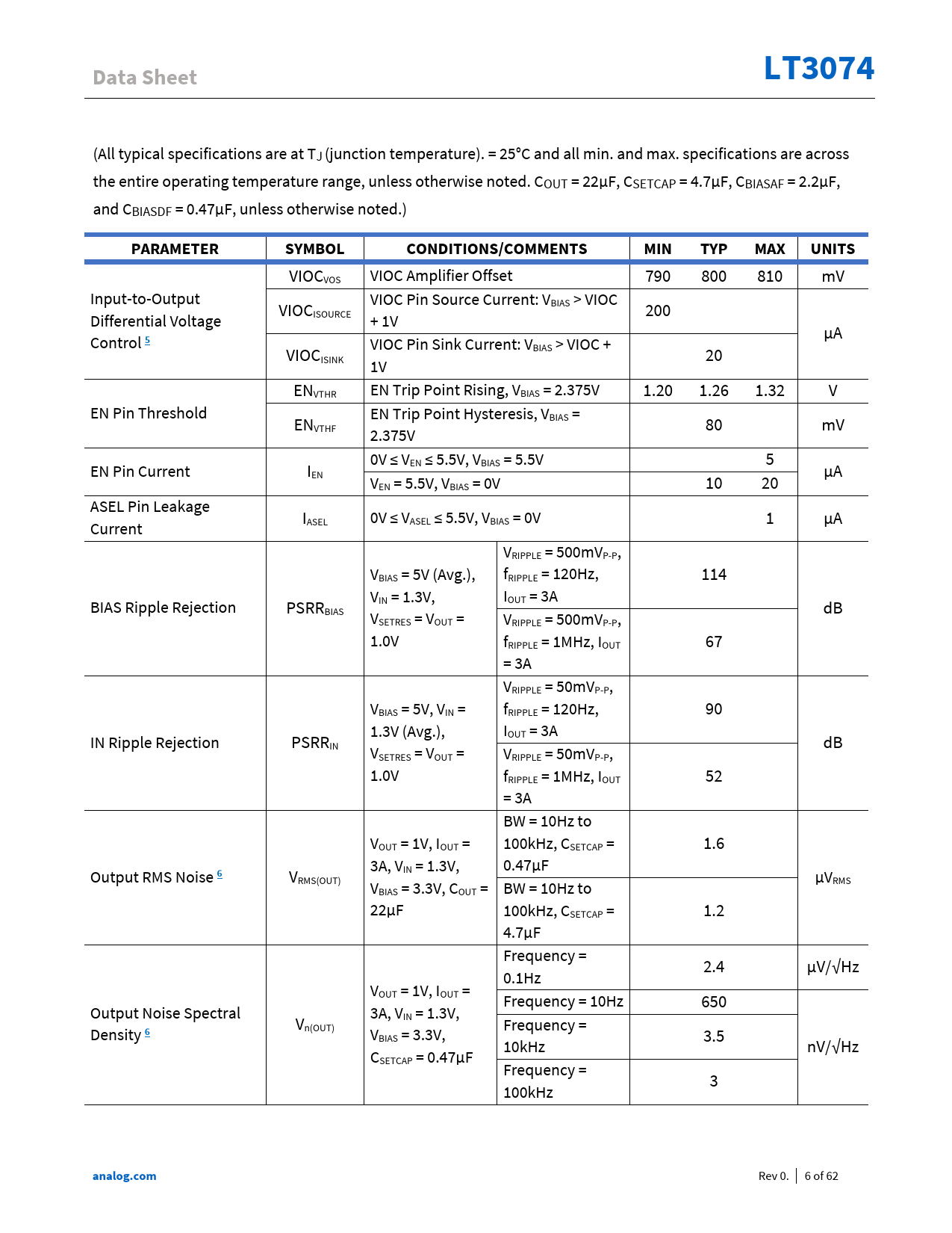

Data Sheet LT3074
(All typical specifications are at TJ (junction temperature). = 25°C and all min. and max. specifications are across the entire operating temperature range, unless otherwise noted. COUT = 22µF, CSETCAP = 4.7µF, CBIASAF = 2.2µF, and CBIASDF = 0.47µF, unless otherwise noted.)
PARAMETER SYMBOL CONDITIONS/COMMENTS MIN TYP MAX UNITS
VIOCVOS VIOC Amplifier Offset 790 800 810 mV Input-to-Output VIOC Pin Source Current: V VIOC BIAS > VIOC 200 Differential Voltage ISOURCE + 1V Control µA
5
VIOC Pin Sink Current: V VIOC BIAS > VIOC + ISINK 20 1V ENVTHR EN Trip Point Rising, VBIAS = 2.375V 1.20 1.26 1.32 V EN Pin Threshold EN Trip Point Hysteresis, V EN BIAS = VTHF 80 mV 2.375V 0V ≤ V EN Pin Current I EN ≤ 5.5V, VBIAS = 5.5V 5 EN µA VEN = 5.5V, VBIAS = 0V 10 20 ASEL Pin Leakage I Current ASEL 0V ≤ VASEL ≤ 5.5V, VBIAS = 0V 1 µA VRIPPLE = 500mVP-P, VBIAS = 5V (Avg.), fRIPPLE = 120Hz, 114 V I BIAS Ripple Rejection PSRR IN = 1.3V, OUT = 3A BIAS dB VSETRES = VOUT = VRIPPLE = 500mVP-P, 1.0V fRIPPLE = 1MHz, IOUT 67 = 3A VRIPPLE = 50mVP-P, VBIAS = 5V, VIN = fRIPPLE = 120Hz, 90 1.3V (Avg.), I IN Ripple Rejection PSRR OUT = 3A IN dB VSETRES = VOUT = VRIPPLE = 50mVP-P, 1.0V fRIPPLE = 1MHz, IOUT 52 = 3A BW = 10Hz to VOUT = 1V, IOUT = 100kHz, CSETCAP = 1.6 3A, V 0.47µF Output RMS Noise
6
V IN = 1.3V, RMS(OUT) µV V RMS BIAS = 3.3V, COUT = BW = 10Hz to 22µF 100kHz, CSETCAP = 1.2 4.7µF Frequency = 2.4 µV/√Hz 0.1Hz VOUT = 1V, IOUT = Frequency = 10Hz 650 Output Noise Spectral 3A, V V IN = 1.3V, Frequency = Density
6
n(OUT) VBIAS = 3.3V, 3.5 10kHz nV/√Hz CSETCAP = 0.47µF Frequency = 3 100kHz
