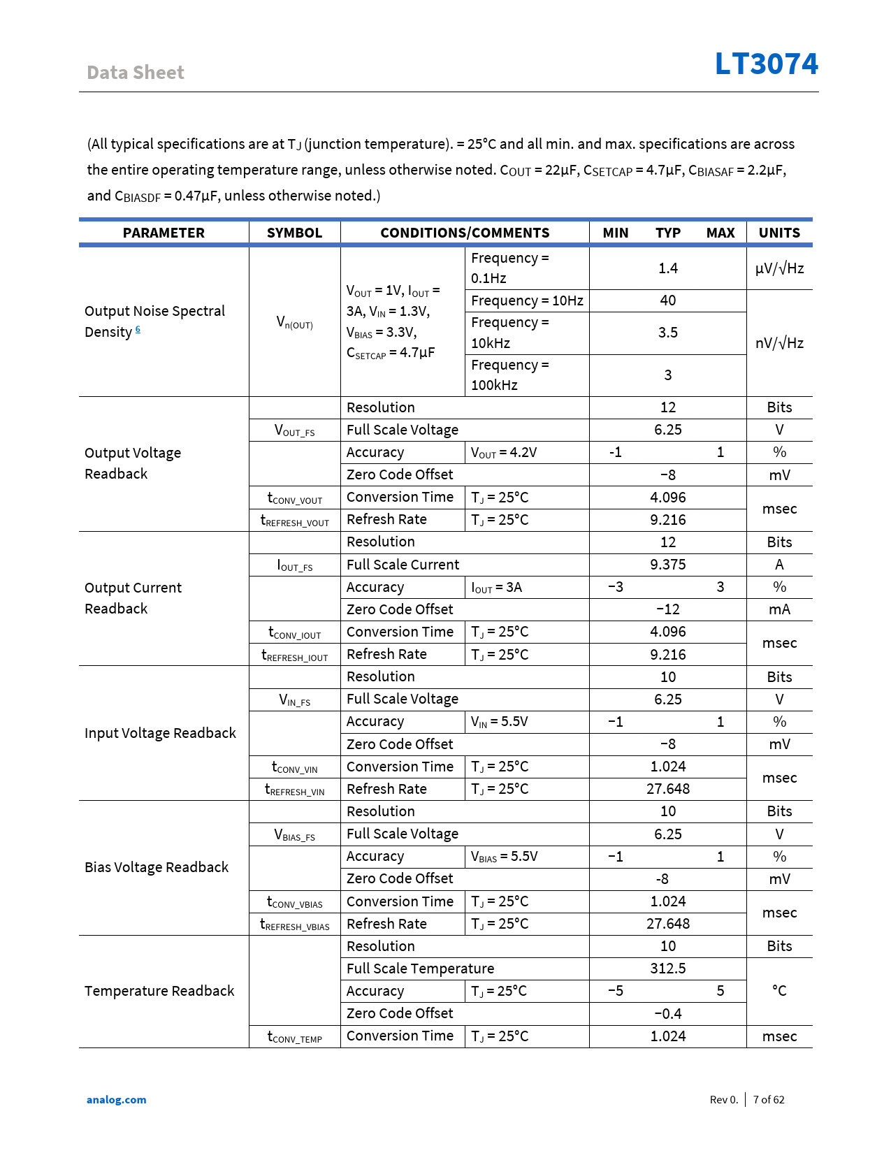

(All typical specifications are at TJ (junction temperature). = 25°C and all min. and max. specifications are across the entire operating temperature range, unless otherwise noted. COUT = 22µF, CSETCAP = 4.7µF, CBIASAF = 2.2µF, and CBIASDF = 0.47µF, unless otherwise noted.)
PARAMETER SYMBOL CONDITIONS/COMMENTS MIN TYP MAX UNITS
Frequency = 1.4 µV/√Hz 0.1Hz VOUT = 1V, IOUT = Frequency = 10Hz 40 Output Noise Spectral 3A, V V IN = 1.3V, Frequency = Density
6
n(OUT) VBIAS = 3.3V, 3.5 10kHz nV/√Hz CSETCAP = 4.7µF Frequency = 3 100kHz Resolution 12 Bits VOUT_FS Full Scale Voltage 6.25 V Output Voltage Accuracy V OUT = 4.2V -1 1 % Readback Zero Code Offset −8 mV tCONV_VOUT Conversion Time TJ = 25°C 4.096 msec tREFRESH_VOUT Refresh Rate TJ = 25°C 9.216 Resolution 12 Bits IOUT_FS Full Scale Current 9.375 A Output Current Accuracy I OUT = 3A −3 3 % Readback Zero Code Offset −12 mA tCONV_IOUT Conversion Time TJ = 25°C 4.096 msec tREFRESH_IOUT Refresh Rate TJ = 25°C 9.216 Resolution 10 Bits VIN_FS Full Scale Voltage 6.25 V Accuracy V Input Voltage Readback IN = 5.5V −1 1 % Zero Code Offset −8 mV tCONV_VIN Conversion Time TJ = 25°C 1.024 msec tREFRESH_VIN Refresh Rate TJ = 25°C 27.648 Resolution 10 Bits VBIAS_FS Full Scale Voltage 6.25 V Accuracy V Bias Voltage Readback BIAS = 5.5V −1 1 % Zero Code Offset -8 mV tCONV_VBIAS Conversion Time TJ = 25°C 1.024 msec tREFRESH_VBIAS Refresh Rate TJ = 25°C 27.648 Resolution 10 Bits Full Scale Temperature 312.5 Temperature Readback Accuracy TJ = 25°C −5 5 °C Zero Code Offset −0.4 tCONV_TEMP Conversion Time TJ = 25°C 1.024 msec
