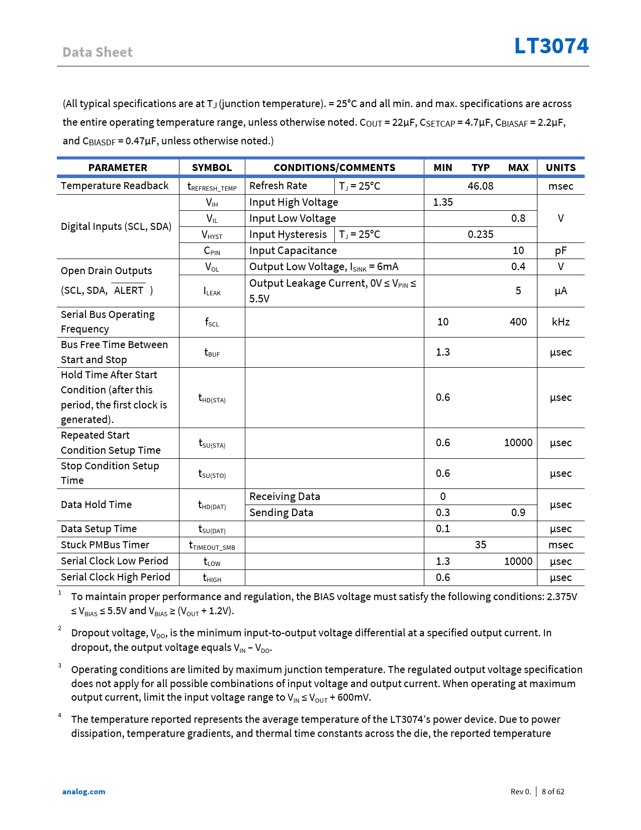

(All typical specifications are at TJ (junction temperature). = 25°C and all min. and max. specifications are across the entire operating temperature range, unless otherwise noted. COUT = 22µF, CSETCAP = 4.7µF, CBIASAF = 2.2µF, and CBIASDF = 0.47µF, unless otherwise noted.)
PARAMETER SYMBOL CONDITIONS/COMMENTS MIN TYP MAX UNITS
Temperature Readback tREFRESH_TEMP Refresh Rate TJ = 25°C 46.08 msec VIH Input High Voltage 1.35 VIL Input Low Voltage 0.8 V Digital Inputs (SCL, SDA) VHYST Input Hysteresis TJ = 25°C 0.235 CPIN Input Capacitance 10 pF Open Drain Outputs VOL Output Low Voltage, ISINK = 6mA 0.4 V Output Leakage Current, 0V ≤ V (SCL, SDA, ALERT ) I PIN ≤ LEAK 5 µA 5.5V Serial Bus Operating f Frequency SCL 10 400 kHz Bus Free Time Between t Start and Stop BUF 1.3 µsec Hold Time After Start Condition (after this t period, the first clock is HD(STA) 0.6 µsec generated). Repeated Start t Condition Setup Time SU(STA) 0.6 10000 µsec Stop Condition Setup t Time SU(STO) 0.6 µsec Receiving Data 0 Data Hold Time tHD(DAT) µsec Sending Data 0.3 0.9 Data Setup Time tSU(DAT) 0.1 µsec Stuck PMBus Timer tTIMEOUT_SMB 35 msec Serial Clock Low Period tLOW 1.3 10000 µsec Serial Clock High Period tHIGH 0.6 µsec .1 To maintain proper performance and regulation, the BIAS voltage must satisfy the following conditions: 2.375V ≤ VBIAS ≤ 5.5V and VBIAS ≥ (VOUT + 1.2V). 2 Dropout voltage, VDO, is the minimum input-to-output voltage differential at a specified output current. In dropout, the output voltage equals VIN – VDO. 3 Operating conditions are limited by maximum junction temperature. The regulated output voltage specification does not apply for all possible combinations of input voltage and output current. When operating at maximum output current, limit the input voltage range to VIN ≤ VOUT + 600mV. 4 The temperature reported represents the average temperature of the LT3074’s power device. Due to power dissipation, temperature gradients, and thermal time constants across the die, the reported temperature
