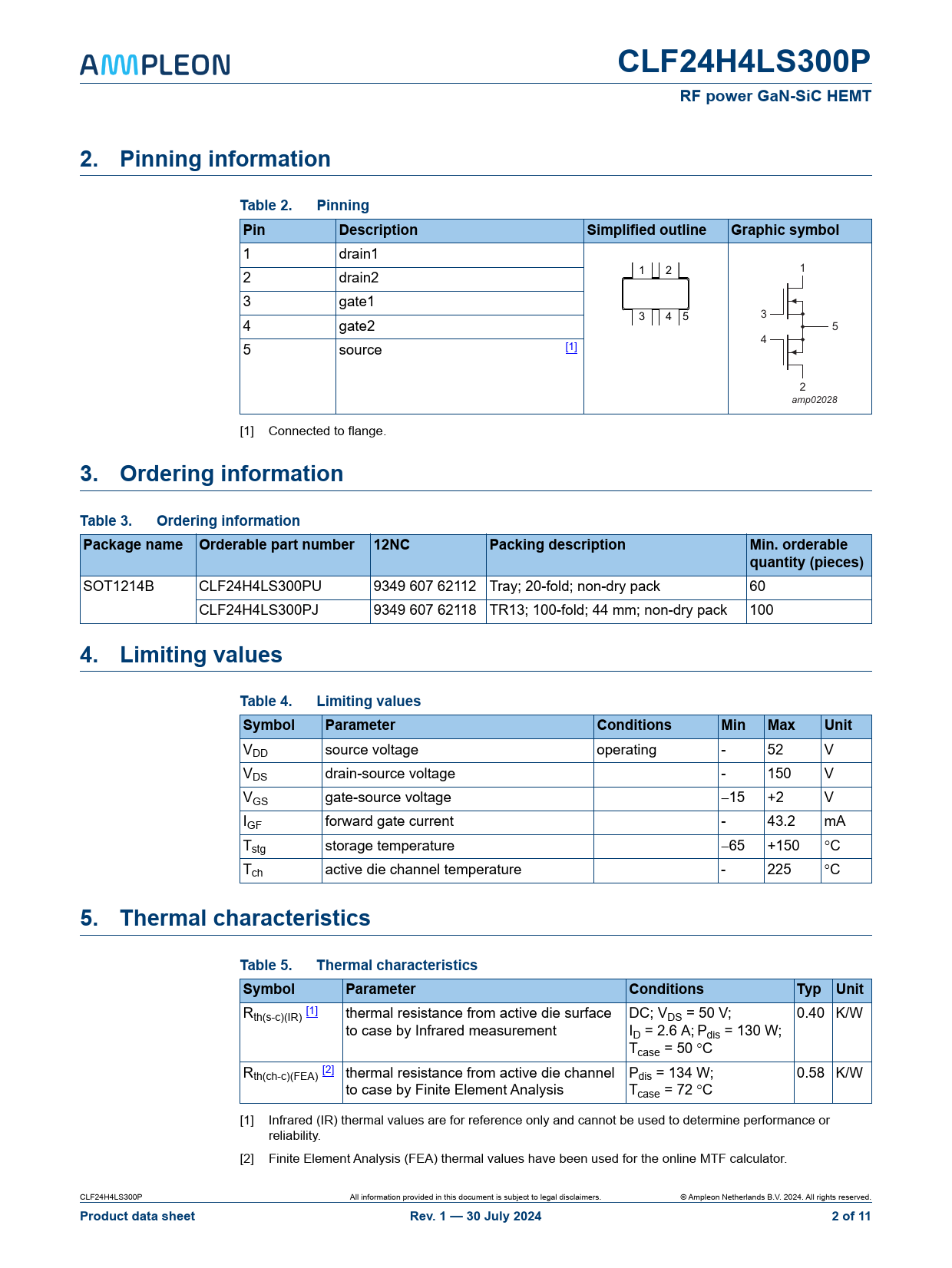

CLF24H4LS300P. RF power GaN-SiC HEMT. 2. Pinning. information. Table 2. Pinning. Pin. Description. Simplified outline. Graphic symbol
link to page 2 link to page 2 link to page 2
CLF24H4LS300P RF power GaN-SiC HEMT 2. Pinning information Table 2. Pinning Pin Description Simplified outline Graphic symbol
1 drain1 1 2 drain2 1 2 3 gate1 3 4 gate2 3 4 5 5 4 5 source [1] 2 amp02028 [1] Connected to flange.
3. Ordering information Table 3. Ordering information Package name Orderable part number 12NC Packing description Min. orderable quantity (pieces)
SOT1214B CLF24H4LS300PU 9349 607 62112 Tray; 20-fold; non-dry pack 60 CLF24H4LS300PJ 9349 607 62118 TR13; 100-fold; 44 mm; non-dry pack 100
4. Limiting values Table 4. Limiting values Symbol Parameter Conditions Min Max Unit
VDD source voltage operating - 52 V VDS drain-source voltage - 150 V VGS gate-source voltage 15 +2 V IGF forward gate current - 43.2 mA Tstg storage temperature 65 +150 C Tch active die channel temperature - 225 C
5. Thermal characteristics Table 5. Thermal characteristics Symbol Parameter Conditions Typ Unit
Rth(s-c)(IR) [1] thermal resistance from active die surface DC; VDS = 50 V; 0.40 K/W to case by Infrared measurement ID = 2.6 A; Pdis = 130 W; Tcase = 50 C Rth(ch-c)(FEA) [2] thermal resistance from active die channel Pdis = 134 W; 0.58 K/W to case by Finite Element Analysis Tcase = 72 C [1] Infrared (IR) thermal values are for reference only and cannot be used to determine performance or reliability. [2] Finite Element Analysis (FEA) thermal values have been used for the online MTF calculator. CLF24H4LS300P All information provided in this document is subject to legal disclaimers. © Ampleon Netherlands B.V. 2024. All rights reserved.
Product data sheet Rev. 1 — 30 July 2024 2 of 11
