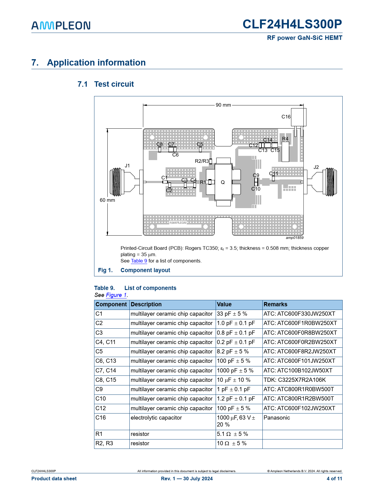

CLF24H4LS300P. RF power GaN-SiC HEMT. 7. Application. information. 7.1 Test circuit. Fig 1. Component layout. Table 9. List of co
CLF24H4LS300P RF power GaN-SiC HEMT 7 Application information 7.1 Test circuit Fig 1 Component layout Table 9 List of co
link to page 4 link to page 4
CLF24H4LS300P RF power GaN-SiC HEMT 7. Application information 7.1 Test circuit
90 mm C16 C14 R4 C8 C7 C5 C12 C13 C15 C6 R2/R3 J1 J2 C9 C11 C1 C3 C4 R1 Q C2 C10 60 mm amp01859 Printed-Circuit Board (PCB): Rogers TC350; r = 3.5; thickness = 0.508 mm; thickness copper plating = 35 m. See Table 9 for a list of components.
Fig 1. Component layout Table 9. List of co mponents
See Figure 1.
Component Description Value Remarks
C1 multilayer ceramic chip capacitor 33 pF  5 % ATC: ATC600F330JW250XT C2 multilayer ceramic chip capacitor 1.0 pF  0.1 pF ATC: ATC600F1R0BW250XT C3 multilayer ceramic chip capacitor 0.8 pF  0.1 pF ATC: ATC600F0R8BW250XT C4, C11 multilayer ceramic chip capacitor 0.2 pF  0.1 pF ATC: ATC600F0R2BW250XT C5 multilayer ceramic chip capacitor 8.2 pF  5 % ATC: ATC600F8R2JW250XT C6, C13 multilayer ceramic chip capacitor 100 pF  5 % ATC: ATC600F101JW250XT C7, C14 multilayer ceramic chip capacitor 1000 pF  5 % ATC: ATC100B102JW50XT C8, C15 multilayer ceramic chip capacitor 10 F  10 % TDK: C3225X7R2A106K C9 multilayer ceramic chip capacitor 1 pF  0.1 pF ATC: ATC800R1R0BW500T C10 multilayer ceramic chip capacitor 1.2 pF  0.1 pF ATC: ATC800R1R2BW500T C12 multilayer ceramic chip capacitor 100 pF  5 % ATC: ATC600F102JW250XT C16 electrolytic capacitor 1000 F, 63 V  Panasonic 20 % R1 resistor 5.1  5 % R2, R3 resistor 10  5 % CLF24H4LS300P All information provided in this document is subject to legal disclaimers. © Ampleon Netherlands B.V. 2024. All rights reserved.
