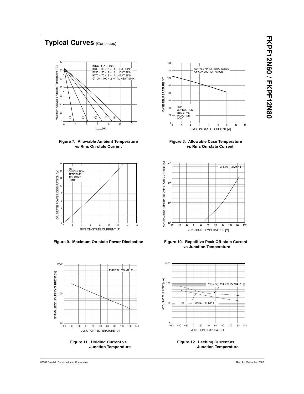

FKPF12N60 / FKPF12N80. Typical Curves. Figure 7. Allowable Ambient Temperature. Figure 8. Allowable Case Temperature
FKPF12N60 / FKPF12N80 Typical Curves Figure 7 Allowable Ambient Temperature Figure 8 Allowable Case Temperature
(Continues) 140 160 ] ① NO HEAT SINK ℃ ② 30 × 30 × 2 ㎜ AL HEAT SINK CURVES APPLY REGARDLESS 120 140 re [ ③ 50 × 50 × 2 ㎜ AL HEAT SINK OF CONDUCTION ANGLE tu ④ 70 × 70 × 2 ㎜ AL HEAT SINK a ] er 100 ⑤ 100 × 100 × 2 ㎜ AL HEAT SINK 120 p ℃ m [ e E R t T 100 80 n bie ATU m 80 60 e A PER bl a 60 w 40 lo Al SE TEM 40 360° m CONDUCTION u CA 20 RESISTIVE, im x 20 INDUCTIVE a ① ② ③ ④ ⑤ M LOAD 0 0 0 2 4 6 8 10 12 0 2 4 6 8 10 12 14 16 I [A] T(RMS) RMS ON-STATE CURRENT [A]
Figure 7. Allowable Ambient Temperature Figure 8. Allowable Case Temperature vs Rms On-state Current vs Rms On-state Current
5
16 %
10
[ T TYPICAL EXAMPLE 360° ] 14 EN CONDUCTION [W R RESISTIVE, R N U INDUCTIVE O 12 LOAD E C ATI T
4
A
10
IP 10 -ST ISS F D 8 R OF E E IT W 6 IV O P
3 10
PET E 4 ATE R T S ED 2 N IZ O AL M 0
2
R
10
0 2 4 6 8 10 12 14 16 O
-60 -40 -20 0 20 40 60 80 100 120 140
N RMS ON-STATE CURRENT [A] JUNCTION TEMPERATURE [V]
Figure 9. Maximum On-state Power Dissipation Figure 10. Repetitive Peak Off-state Current vs Junction Temperature
1000 1000 TYPICAL EXAMPLE ] T [% N ] E [mA 100 T2(+), G(-) TYPICAL EXEMPLE URR T N C E ING 100 D URR L C G HO D 10 T2(± ), G(+) TYPICAL EXEMPLE IZE TCHIN L A A L M R NO 10 1 -60 -40 -20 0 20 40 60 80 100 120 140 -60 -40 -20 0 20 40 60 80 100 120 140 JUNCTION TEMPERATURE [℃] JUNCTION TEMPERATURE
Figure 11. Holding Current vs Figure 12. Laching Current vs Junction Temperature Junction Temperature
