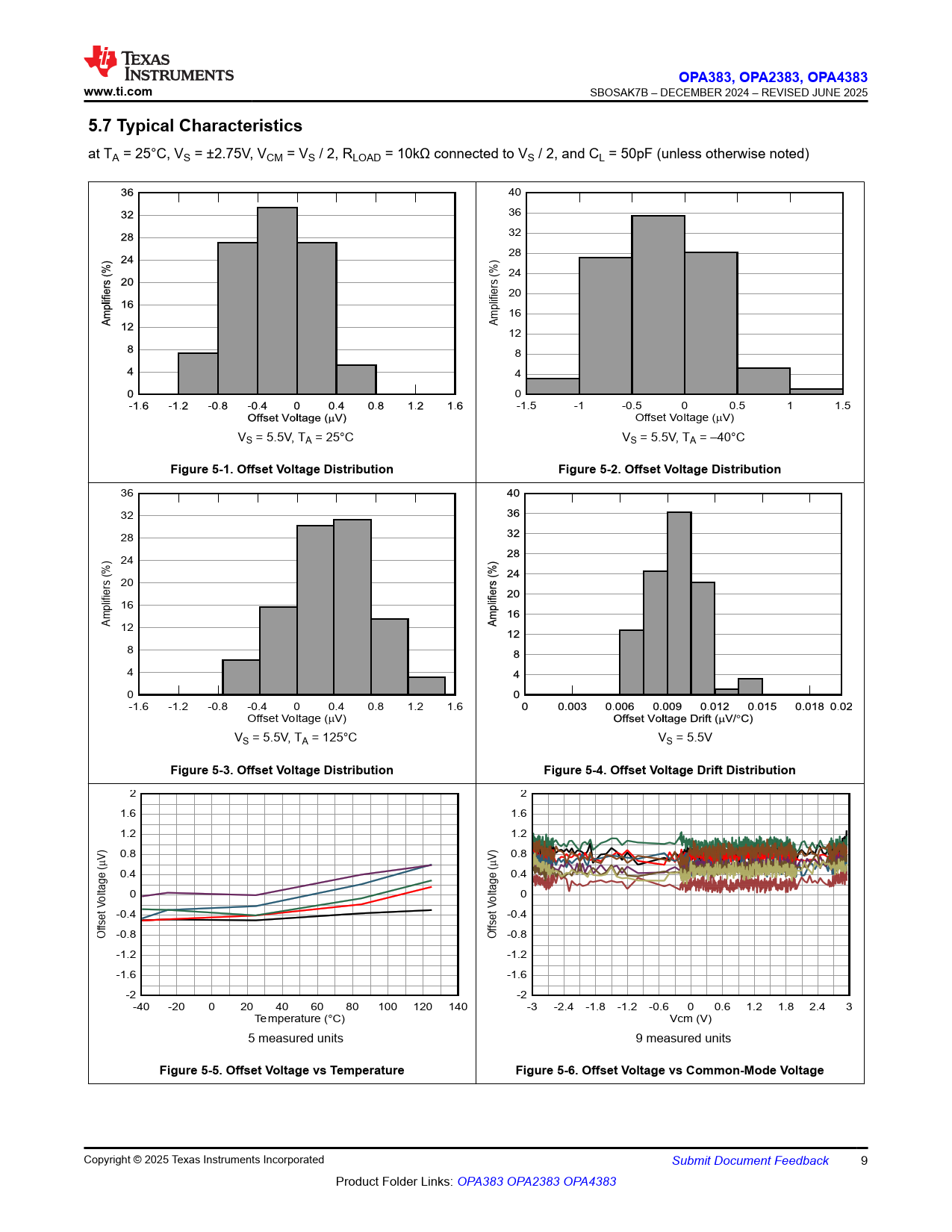

5.7 Typical Characteristics
at TA = 25°C, VS = ±2.75V, VCM = VS / 2, RLOAD = 10kΩ connected to VS / 2, and CL = 50pF (unless otherwise noted) 40 36 32 28 ) 24 20 plifiers (% m 16 A 12 8 4 0 -1.5 -1 -0.5 0 0.5 1 1.5 Offset Voltage (V) VS = 5.5V, TA = 25°C VS = 5.5V, TA = –40°C
Figure 5-1. Offset Voltage Distribution Figure 5-2. Offset Voltage Distribution
36 32 28 ) 24 20 plifiers (% 16 m A 12 8 4 0 -1.6 -1.2 -0.8 -0.4 0 0.4 0.8 1.2 1.6 Offset Voltage (V) VS = 5.5V, TA = 125°C VS = 5.5V
Figure 5-3. Offset Voltage Distribution Figure 5-4. Offset Voltage Drift Distribution
2 2 1.6 1.6 1.2 1.2 ) 0.8 ) 0.8 0.4 0.4 0 0 -0.4 -0.4 ffset Voltage (V ffset Voltage (V O -0.8 O -0.8 -1.2 -1.2 -1.6 -1.6 -2 -2 -40 -20 0 20 40 60 80 100 120 140 -3 -2.4 -1.8 -1.2 -0.6 0 0.6 1.2 1.8 2.4 3 Te mperature (C) Vcm (V) 5 measured units 9 measured units
Figure 5-5. Offset Voltage vs Temperature Figure 5-6. Offset Voltage vs Common-Mode Voltage
