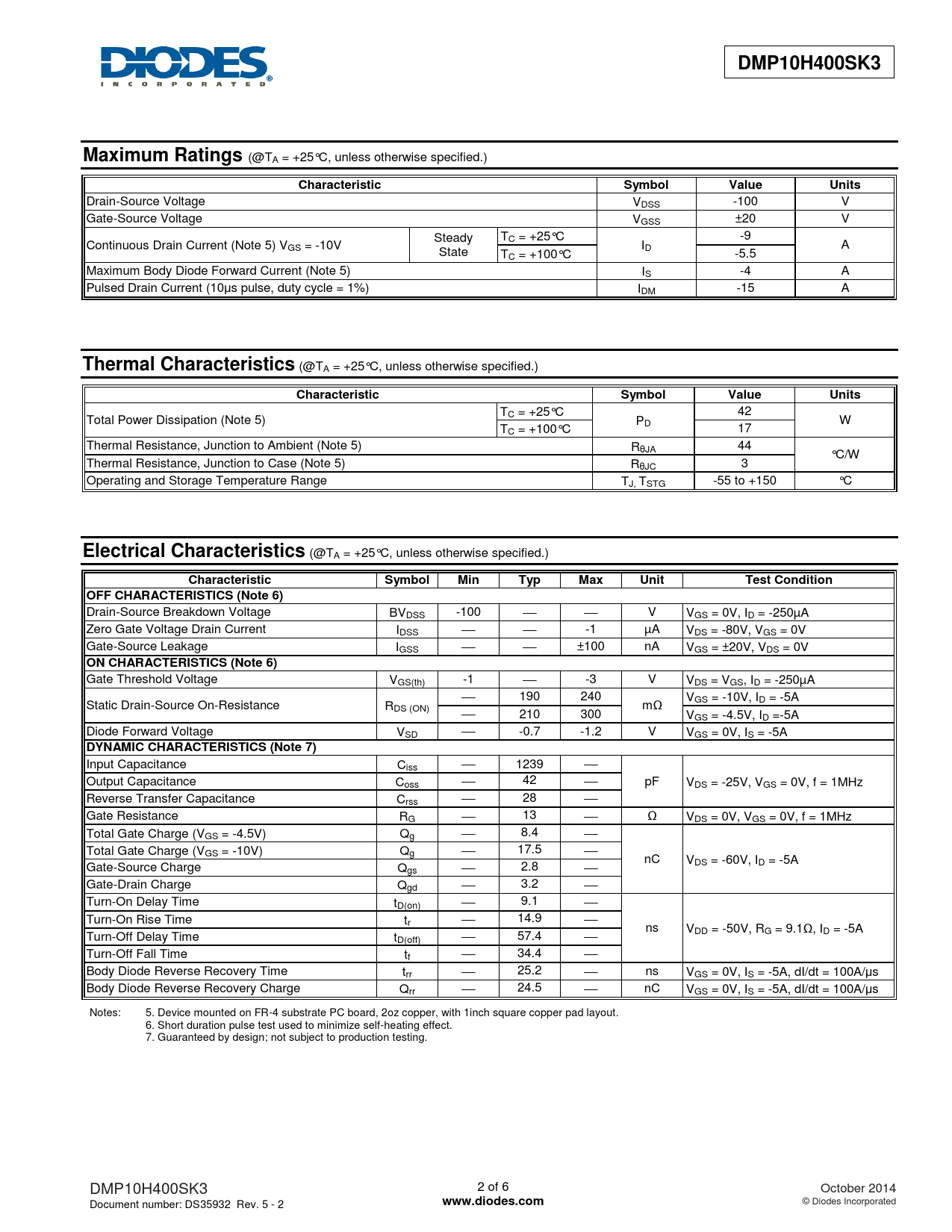

DMP10H400SK3. Maximum Ratings. Characteristic. Symbol. Value. Units. Thermal Characteristics. E N. Electrical Characteristics. Min. Typ. Max
DMP10H400SK3 Maximum Ratings Characteristic Symbol Value Units Thermal Characteristics E N Electrical Characteristics Min Typ Max
(@TA = +25°C, unless otherwise specified.)
Drain-Source Voltage VDSS -100 V Gate-Source Voltage VGSS ±20 V T -9
T
Steady C = +25°C Continuous Drain Current (Note 5) VGS = -10V I A State D
C
TC = +100°C -5.5
U
Maximum Body Diode Forward Current (Note 5) IS -4 A
D
Pulsed Drain Current (10μs pulse, duty cycle = 1%) IDM -15 A
O R P W Thermal Characteristics
E N Characteristic Symbol Value Units
T 42 Total Power Dissipation (Note 5) C = +25°C PD W TC = +100°C 17 Thermal Resistance, Junction to Ambient (Note 5) RθJA 44 °C/W Thermal Resistance, Junction to Case (Note 5) RθJC 3 Operating and Storage Temperature Range TJ, TSTG -55 to +150 °C
Characteristic Symbol Min Typ Max Unit Test Condition OFF CHARACTERISTICS (Note 6)
Drain-Source Breakdown Voltage BVDSS -100   V VGS = 0V, ID = -250µA Zero Gate Voltage Drain Current IDSS   -1 µA VDS = -80V, VGS = 0V Gate-Source Leakage IGSS   ±100 nA VGS = ±20V, VDS = 0V
ON CHARACTERISTICS (Note 6)
Gate Threshold Voltage VGS(th) -1  -3 V VDS = VGS, ID = -250µA  190 240 V Static Drain-Source On-Resistance GS = -10V, ID = -5A RDS (ON) mΩ  210 300 VGS = -4.5V, ID =-5A Diode Forward Voltage VSD  -0.7 -1.2 V VGS = 0V, IS = -5A
DYNAMIC CHARACTERISTICS (Note 7)
Input Capacitance Ciss  1239  Output Capacitance Coss  42  pF VDS = -25V, VGS = 0V, f = 1MHz Reverse Transfer Capacitance Crss  28  Gate Resistance RG  13  Ω VDS = 0V, VGS = 0V, f = 1MHz Total Gate Charge (VGS = -4.5V) Qg  8.4  Total Gate Charge (VGS = -10V) Qg  17.5  nC VDS = -60V, ID = -5A Gate-Source Charge Qgs  2.8  Gate-Drain Charge Qgd  3.2  Turn-On Delay Time tD(on)  9.1  Turn-On Rise Time tr  14.9  ns VDD = -50V, RG = 9.1Ω, ID = -5A Turn-Off Delay Time tD(off)  57.4  Turn-Off Fall Time tf  34.4  Body Diode Reverse Recovery Time trr  25.2  ns VGS = 0V, IS = -5A, dI/dt = 100A/μs Body Diode Reverse Recovery Charge Qrr  24.5  nC VGS = 0V, IS = -5A, dI/dt = 100A/μs Notes: 5. Device mounted on FR-4 substrate PC board, 2oz copper, with 1inch square copper pad layout. 6. Short duration pulse test used to minimize self-heating effect. 7. Guaranteed by design; not subject to production testing. DMP10H400SK3 2 of 6 October 2014 Document number: DS35932 Rev. 5 - 2
