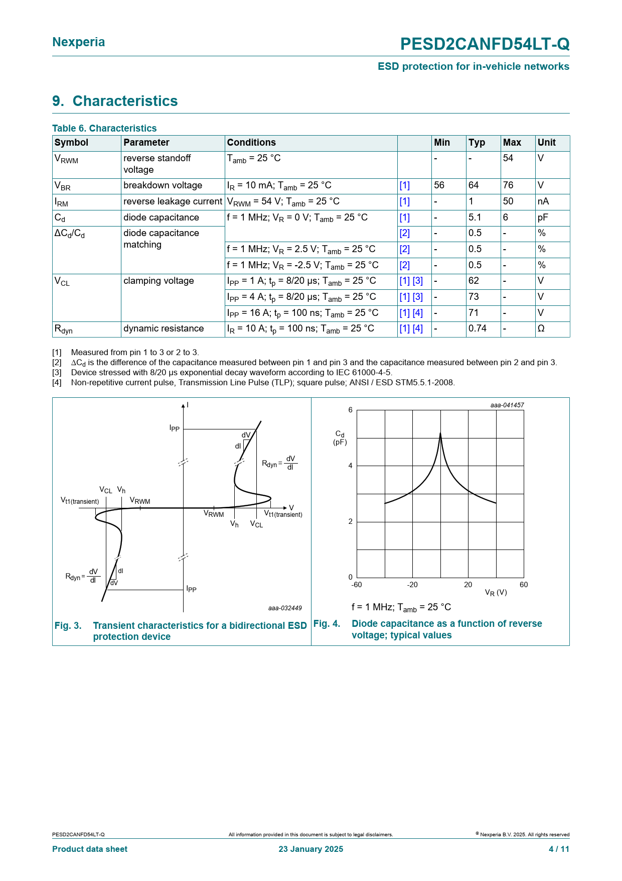

Nexperia. PESD2CANFD54LT-Q. ESD protection for in-vehicle networks. 9. Characteristics Table 6. Characteristics. Symbol
Nexperia PESD2CANFD54LT-Q ESD protection for in-vehicle networks 9 Characteristics Table 6 Characteristics Symbol
link to page 4 link to page 4 link to page 4 link to page 4 link to page 4 link to page 4 link to page 4 link to page 4 link to page 4 link to page 4 link to page 4 link to page 4 link to page 4 link to page 4
Nexperia PESD2CANFD54LT-Q ESD protection for in-vehicle networks 9. Characteristics Table 6. Characteristics Symbol Parameter Conditions Min Typ Max Unit
VRWM reverse standof Tamb = 25 °C - - 54 V voltage VBR breakdown voltage IR = 10 mA; Tamb = 25 °C [1] 56 64 76 V IRM reverse leakage current VRWM = 54 V; Tamb = 25 °C [1] - 1 50 nA Cd diode capacitance f = 1 MHz; VR = 0 V; Tamb = 25 °C [1] - 5.1 6 pF ΔCd/Cd diode capacitance [2] - 0.5 - % matching f = 1 MHz; VR = 2.5 V; Tamb = 25 °C [2] - 0.5 - % f = 1 MHz; VR = -2.5 V; Tamb = 25 °C [2] - 0.5 - % VCL clamping voltage IPP = 1 A; tp = 8/20 µs; Tamb = 25 °C [1] [3] - 62 - V IPP = 4 A; tp = 8/20 µs; Tamb = 25 °C [1] [3] - 73 - V IPP = 16 A; tp = 100 ns; Tamb = 25 °C [1] [4] - 71 - V Rdyn dynamic resistance IR = 10 A; tp = 100 ns; Tamb = 25 °C [1] [4] - 0.74 - Ω [1] Measured from pin 1 to 3 or 2 to 3. [2] ∆Cd is the dif erence of the capacitance measured between pin 1 and pin 3 and the capacitance measured between pin 2 and pin 3. [3] Device stressed with 8/20 μs exponential decay waveform according to IEC 61000-4-5. [4] Non-repetitive current pulse, Transmission Line Pulse (TLP); square pulse; ANSI / ESD STM5.5.1-2008. I aaa-041457 6 IPP dV Cd dI (pF) dV Rdyn = dI 4 VCL Vh Vt1(transient) VRWM V VRWM Vt1(transient) Vh VCL 2 dV dI Rdyn = dI 0 dV I -60 -20 20 60 PP VR (V) aaa-032449 f = 1 MHz; Tamb = 25 °C
Fig. 3. Transient characteristics for a bidirectional ESD Fig. 4. Diode capacitance as a function of reverse protection device voltage; typical values
