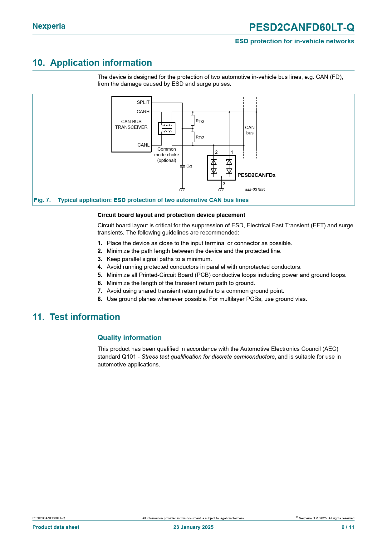

The device is designed for the protection of two automotive in-vehicle bus lines, e.g. CAN (FD), from the damage caused by ESD and surge pulses. SPLIT CANH CAN BUS RT/2 TRANSCEIVER CAN bus RT/2 CANL Common 2 1 mode choke (optional) CG
PESD2CANFDx
3 aaa-031991
Fig. 7. Typical application: ESD protection of two automotive CAN bus lines Circuit board layout and protection device placement
