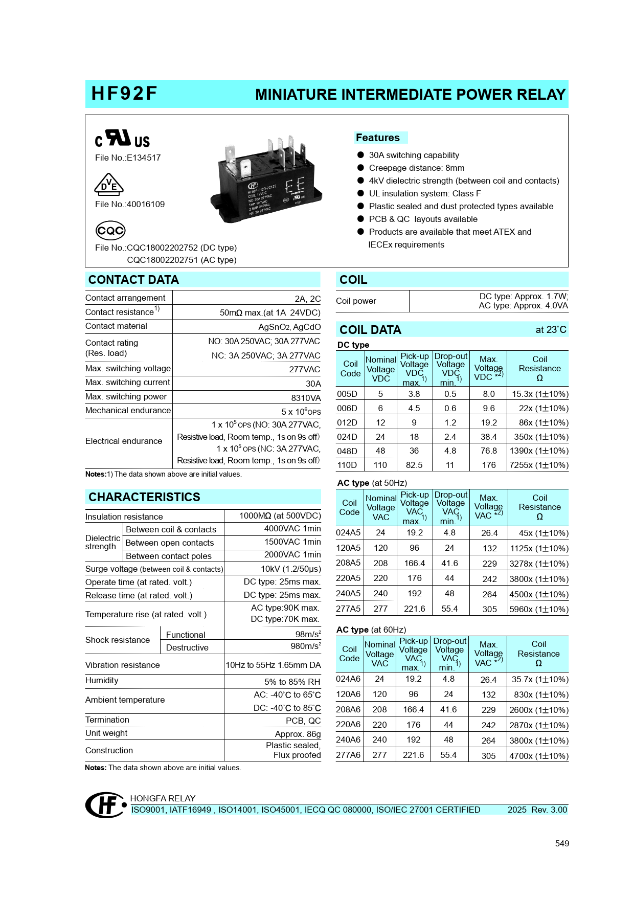

1003063. 1003063. 1003063. 1003063. 2025-08-20. 2025-08-20. 2025-08-20. 2025-08-20. 1003063. 1003063. 1003063. 1003063. HF92F. MINIATURE
1003063 1003063 1003063 1003063 2025-08-20 2025-08-20 2025-08-20 2025-08-20 1003063 1003063 1003063 1003063 HF92F MINIATURE INTERMEDIATE POWER RELAY 2025-08-20 2025-08-20 2025-08-20 2025-08-20 Features File No.:E134517 ● 30A switching capability ● Creepage distance: 8mm ● V 4kV dielectric strength (between coil and contacts) D E ● UL insulation system: Class F File No.:40016109 ● Plastic sealed and dust protected types available ● PCB & QC layouts available ● Products are available that meet ATEX and File No.:CQC18002202752 (DC type) IECEx requirements CQC18002202751 (AC type) 1003063 1003063 1003063 1003063 CONTACT DATA COIL Contact arrangement DC type: Approx. 1.7W; 2A, 2C Coil power AC type: Approx. 4.0VA Contact resistance1) 50m max.(at 1A 24VDC) 2025-08-20 2025-08-20 2025-08-20 2025-08-20 Contact material AgSnO2, AgCdO COIL DATA at 23 Contact rating NO: 30A 250VAC; 30A 277VAC DC type (Res. load) NC: 3A 250VAC; 3A 277VAC Nominal Pick-up Drop-out Max. Coil Max. switching voltage Coil Voltage Voltage 277VAC Voltage Voltage Resistance Code VDC VDC VDC *2) Max. switching current VDC 30A max.1) min.1) Max. switching power 8310VA 005D 5 3.8 0.5 8.0 15.3x (1 10%) Mechanical endurance 5 x 106 006D 6 4.5 0.6 9.6 22x (1 10%) OPS 012D 12 9 1.2 19.2 86x (1 10%) 1 x 105 OPS (NO: 30A 277VAC, Resistive load, Room temp., 1s on 9s off) 024D 24 18 2.4 38.4 350x (1 10%) Electrical endurance 1 x 105 OPS (NC: 3A 277VAC, 048D 48 36 4.8 76.8 1390x (1 10%) Resistive load, Room temp., 1s on 9s off) 110D 110 82.5 11 176 7255x (1 10%) Notes:1) The data shown above are initial values. 1003063 1003063 AC type (at 50Hz) 1003063 1003063 CHARACTERISTICS Nominal Pick-up Drop-out Max. Coil Coil Voltage Voltage Voltage Voltage Resistance Code VAC VAC Insulation resistance 1000M (at 500VDC) VAC VAC *2) max.1) min.1) Between coil & contacts 4000VAC 1min 024A5 2025-08-20 2025-08-20 24 19.2 4.8 2025-08-20 45x (1 10%) 2025-08-20 Dielectric 26.4 Between open contacts 1500VAC 1min strength 120A5 120 96 24 132 1125x (1 10%) Between contact poles 2000VAC 1min 208A5 208 166.4 41.6 229 3278x (1 10%) Surge voltage (between coil & contacts) 10kV (1.2/50µs) 220A5 220 176 44 242 3800x (1 10%) Operate time (at rated. volt.) DC type: 25ms max. Release time (at rated. volt.) DC type: 25ms max. 240A5 240 192 48 264 4500x (1 10%) AC type:90K max. 277A5 277 221.6 55.4 305 5960x (1 10%) Temperature rise (at rated. volt.) DC type:70K max. AC type (at 60Hz) Functional 98m/s2 Shock resistance Pick-up Drop-out Destructive 980m/s2 Nominal Max. Coil Coil Voltage Voltage Voltage Voltage Resistance Code VAC VAC Vibration resistance 10Hz to 55Hz 1.65mm DA VAC VAC *2) max.1) min.1) Humidity 024A6 24 19.2 4.8 26.4 35.7x (1 10%) 5% to 85% RH AC: -40 to 65 120A6 120 96 24 132 830x (1 10%) 1003063 Ambient temperature 1003063 1003063 1003063 DC: -40 to 85 208A6 208 166.4 41.6 229 2600x (1 10%) Termination PCB, QC 220A6 220 176 44 242 2870x (1 10%) Unit weight Approx. 86g 240A6 240 192 48 Plastic sealed, 264 3800x (1 10%) 2025-08-20 2025-08-20 2025-08-20 2025-08-20 Construction Flux proofed 277A6 277 221.6 55.4 305 4700x (1 10%) Notes: The data shown above are initial values. HONGFA RELAY ISO9001, IATF16949 , ISO14001, ISO45001, IECQ QC 080000, ISO/IEC 27001 CERTIFIED 2025 Rev. 3.00 549 1003063 1003063 1003063 1003063 2025-08-20 2025-08-20 2025-08-20 2025-08-20
