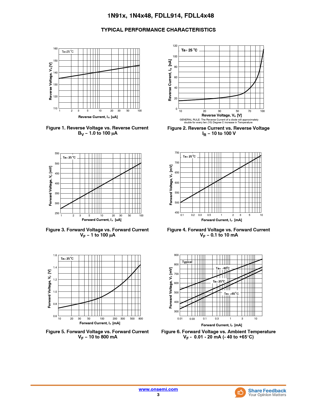

1N91x, 1N4x48, FDLL914, FDLL4x48. TYPICAL PERFORMANCE CHARACTERISTICS. Ta= 25 oC. [V]. V R. , I R. tage,. rent. se Cur. Reverse Vol. Rever

1N91x, 1N4x48, FDLL914, FDLL4x48 TYPICAL PERFORMANCE CHARACTERISTICS

GENERAL RULE: The Reverse Current of a diode will approximately double for every ten (10) Degree C increase in Temperature
Figure 1. Reverse Voltage vs. Reverse Current Figure 2. Reverse Current vs. Reverse Voltage BV − 1.0 to 100 mA IR − 10 to 100 V

Forward Current, IF [uA] Forward Current, IF [mA] Figure 3. Forward Voltage vs. Forward Current Figure 4. Forward Voltage vs. Forward Current VF − 1 to 100 mA VF − 0.1 to 10 mA

Forward Current, IF [mA] Forward Current, IF [mA] Figure 5. Forward Voltage vs. Forward Current Figure 6. Forward Voltage vs. Ambient Temperature VF − 10 to 800 mA VF - 0.01 - 20 mA (- 40 to +65
