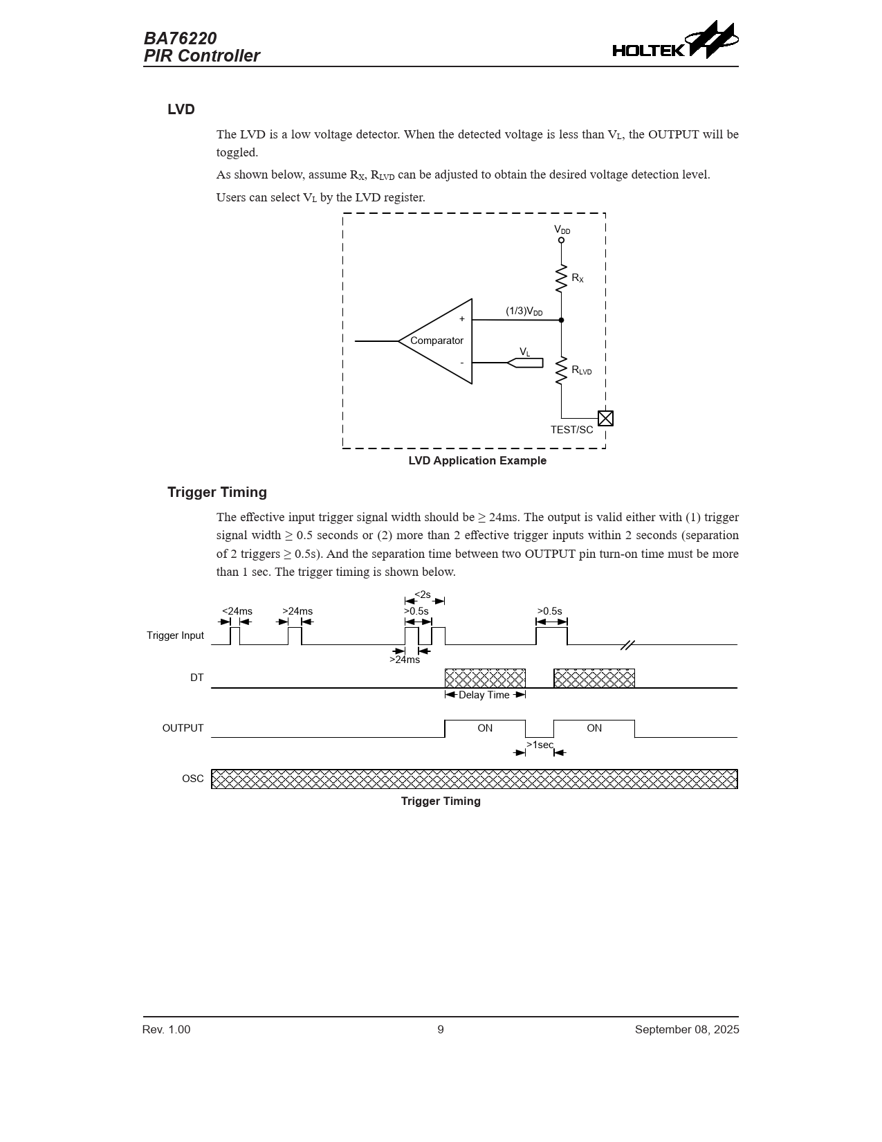

BA76220 PIR Controller LVD
The LVD is a low voltage detector. When the detected voltage is less than VL, the OUTPUT will be toggled. As shown below, assume RX, RLVD can be adjusted to obtain the desired voltage detection level. Users can select VL by the LVD register. VDD RX (1/3)VDD + Comparator VL - RLVD TEST/SC
LVD Application Example Trigger Timing
The effective input trigger signal width should be ≥ 24ms. The output is valid either with (1) trigger signal width ≥ 0.5 seconds or (2) more than 2 effective trigger inputs within 2 seconds (separation of 2 triggers ≥ 0.5s). And the separation time between two OUTPUT pin turn-on time must be more than 1 sec. The trigger timing is shown below. <2s <24ms >24ms >0.5s >0.5s Trigger Input >24ms DT Delay Time OUTPUT ON ON >1sec OSC
