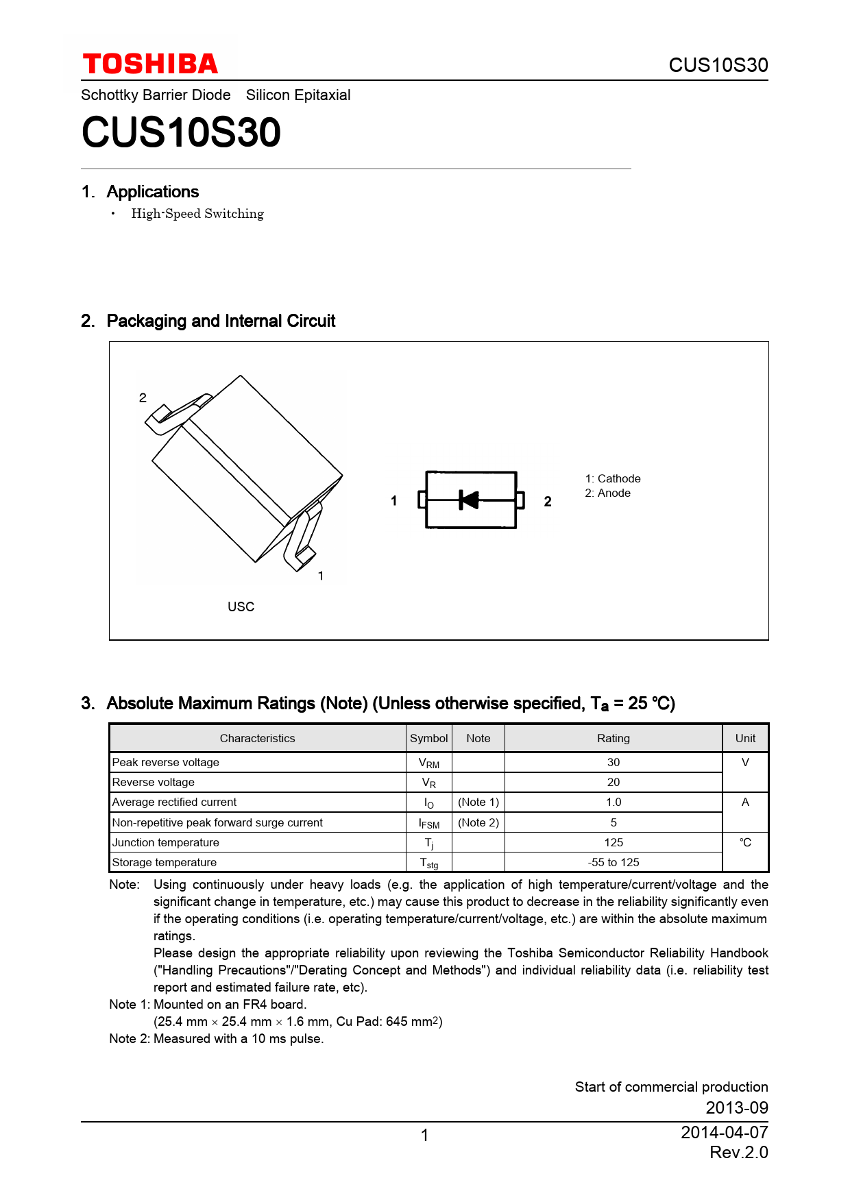

CUS10S30. Schottky. Barrier. Diode. Silicon. Epitaxial. CUS10S30. 1. Applications. •. High-Speed. Switching. 2. Packaging. and. Internal. Circuit. 1:
Datasheet CUS10S30 Toshiba
CUS10S30 Schottky Barrier Diode Silicon Epitaxial CUS10S30 1. Applications • High-Speed Switching 2. Packaging and Internal Circuit 1: Cathode 2: Anode USC 3. Absolute Maximum Ratings (Note) (Unless otherwise specified, Ta = 25 ) Characteristics Symbol Note Rating Unit Peak reverse voltage VRM 30 V Reverse voltage VR 20 Average rectified current IO (Note 1) 1.0 A Non-repetitive peak forward surge current IFSM (Note 2) 5 Junction temperature Tj 125 Storage temperature Tstg -55 to 125 Note: Using continuously under heavy loads (e.g. the application of high temperature/current/voltage and the significant change in temperature, etc.) may cause this product to decrease in the reliability significantly even if the operating conditions (i.e. operating temperature/current/voltage, etc.) are within the absolute maximum ratings. Please design the appropriate reliability upon reviewing the Toshiba Semiconductor Reliability Handbook ("Handling Precautions"/"Derating Concept and Methods") and individual reliability data (i.e. reliability test report and estimated failure rate, etc). Note 1: Mounted on an FR4 board. (25.4 mm × 25.4 mm × 1.6 mm, Cu Pad: 645 mm2) Note 2: Measured with a 10 ms pulse. Start of commercial production 2013-09 1 2014-04-07 Rev.2.0
