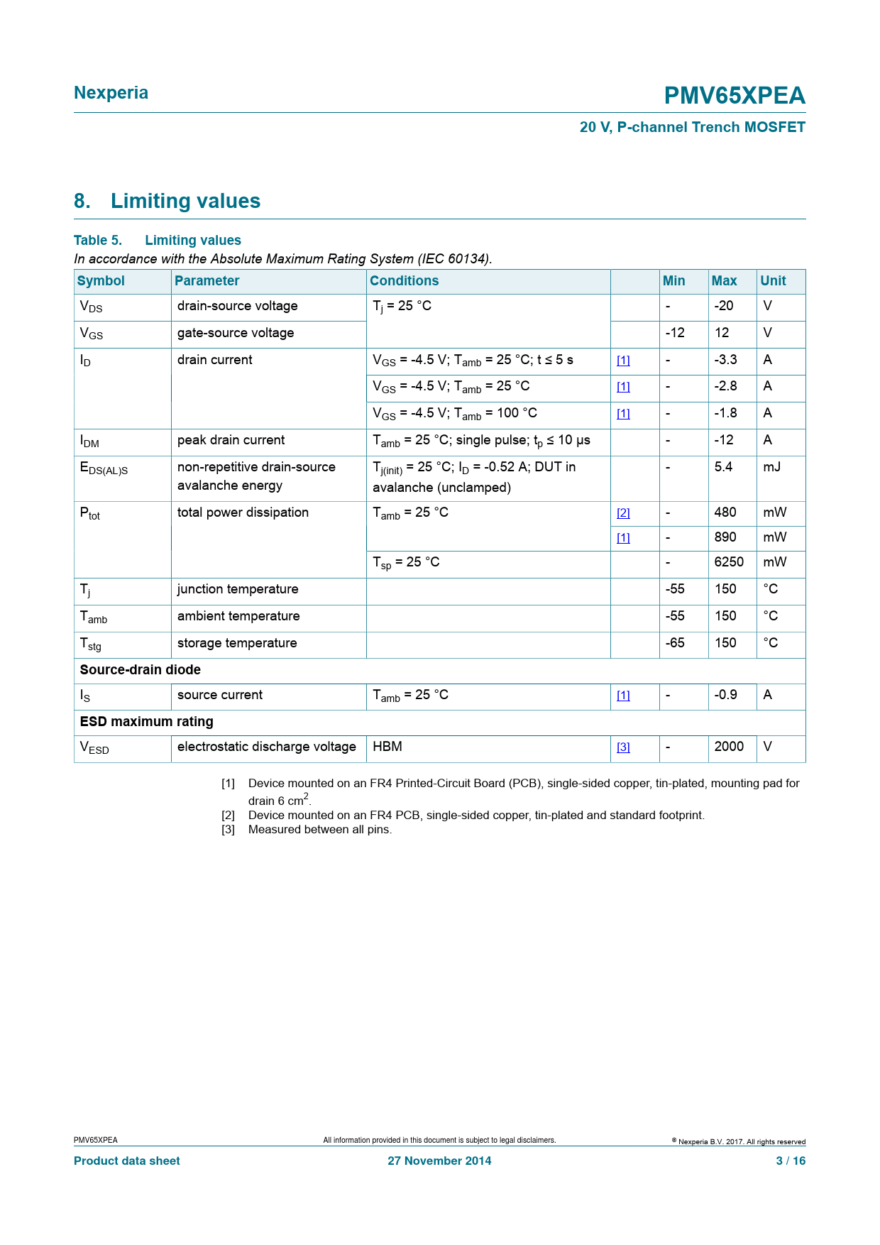

Nexperia PMV65XPEA 20 V, P-channel Trench MOSFET 8. Limiting values Table 5. Limiting values
In accordance with the Absolute Maximum Rating System (IEC 60134).
Symbol Parameter Conditions Min Max Unit
VDS drain-source voltage Tj = 25 °C - -20 V VGS gate-source voltage -12 12 V ID drain current VGS = -4.5 V; Tamb = 25 °C; t ≤ 5 s [1] - -3.3 A VGS = -4.5 V; Tamb = 25 °C [1] - -2.8 A VGS = -4.5 V; Tamb = 100 °C [1] - -1.8 A IDM peak drain current Tamb = 25 °C; single pulse; tp ≤ 10 µs - -12 A EDS(AL)S non-repetitive drain-source Tj(init) = 25 °C; ID = -0.52 A; DUT in - 5.4 mJ avalanche energy avalanche (unclamped) Ptot total power dissipation Tamb = 25 °C [2] - 480 mW [1] - 890 mW Tsp = 25 °C - 6250 mW Tj junction temperature -55 150 °C Tamb ambient temperature -55 150 °C Tstg storage temperature -65 150 °C
Source-drain diode
IS source current Tamb = 25 °C [1] - -0.9 A
ESD maximum rating
VESD electrostatic discharge voltage HBM [3] - 2000 V [1] Device mounted on an FR4 Printed-Circuit Board (PCB), single-sided copper, tin-plated, mounting pad for drain 6 cm2. [2] Device mounted on an FR4 PCB, single-sided copper, tin-plated and standard footprint. [3] Measured between all pins. PMV65XPEA All information provided in this document is subject to legal disclaimers. © Nexperia B.V. 2017. All rights reserved
