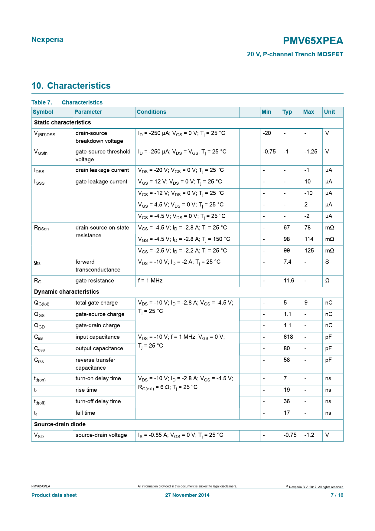

Nexperia. PMV65XPEA. 20 V, P-channel Trench MOSFET. 10. Characteristics. Table 7. Characteristics. Symbol. Parameter. Conditions. Min. Typ
Nexperia PMV65XPEA 20 V, P-channel Trench MOSFET 10 Characteristics Table 7 Characteristics Symbol Parameter Conditions Min Typ
Nexperia PMV65XPEA 20 V, P-channel Trench MOSFET 10. Characteristics Table 7. Characteristics Symbol Parameter Conditions Min Typ Max Unit Static characteristics
V(BR)DSS drain-source ID = -250 µA; VGS = 0 V; Tj = 25 °C -20 - - V breakdown voltage VGSth gate-source threshold ID = -250 µA; VDS = VGS; Tj = 25 °C -0.75 -1 -1.25 V voltage IDSS drain leakage current VDS = -20 V; VGS = 0 V; Tj = 25 °C - - -1 µA IGSS gate leakage current VGS = 12 V; VDS = 0 V; Tj = 25 °C - - 10 µA VGS = -12 V; VDS = 0 V; Tj = 25 °C - - -10 µA VGS = 4.5 V; VDS = 0 V; Tj = 25 °C - - 2 µA VGS = -4.5 V; VDS = 0 V; Tj = 25 °C - - -2 µA RDSon drain-source on-state VGS = -4.5 V; ID = -2.8 A; Tj = 25 °C - 67 78 mΩ resistance VGS = -4.5 V; ID = -2.8 A; Tj = 150 °C - 98 114 mΩ VGS = -2.5 V; ID = -2.2 A; Tj = 25 °C - 99 125 mΩ gfs forward VDS = -10 V; ID = -2 A; Tj = 25 °C - 7.4 - S transconductance RG gate resistance f = 1 MHz - 11.6 - Ω
Dynamic characteristics
QG(tot) total gate charge VDS = -10 V; ID = -2.8 A; VGS = -4.5 V; - 5 9 nC Q T GS gate-source charge j = 25 °C - 1.1 - nC QGD gate-drain charge - 1.1 - nC Ciss input capacitance VDS = -10 V; f = 1 MHz; VGS = 0 V; - 618 - pF C T oss output capacitance j = 25 °C - 80 - pF Crss reverse transfer - 58 - pF capacitance td(on) turn-on delay time VDS = -10 V; ID = -2.8 A; VGS = -4.5 V; - 7 - ns t R r rise time G(ext) = 6 Ω; Tj = 25 °C - 19 - ns td(off) turn-off delay time - 36 - ns tf fall time - 17 - ns
Source-drain diode
VSD source-drain voltage IS = -0.85 A; VGS = 0 V; Tj = 25 °C - -0.75 -1.2 V PMV65XPEA All information provided in this document is subject to legal disclaimers. © Nexperia B.V. 2017. All rights reserved
