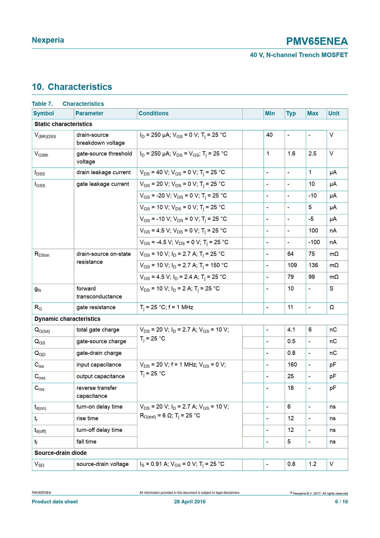

Nexperia. PMV65ENEA. 40 V, N-channel Trench MOSFET. 10. Characteristics. Table 7. Characteristics. Symbol. Parameter. Conditions. Min. Typ
Nexperia PMV65ENEA 40 V, N-channel Trench MOSFET 10 Characteristics Table 7 Characteristics Symbol Parameter Conditions Min Typ
Nexperia PMV65ENEA 40 V, N-channel Trench MOSFET 10. Characteristics Table 7. Characteristics Symbol Parameter Conditions Min Typ Max Unit Static characteristics
V(BR)DSS drain-source ID = 250 µA; VGS = 0 V; Tj = 25 °C 40 - - V breakdown voltage VGSth gate-source threshold ID = 250 µA; VDS = VGS; Tj = 25 °C 1 1.6 2.5 V voltage IDSS drain leakage current VDS = 40 V; VGS = 0 V; Tj = 25 °C - - 1 µA IGSS gate leakage current VGS = 20 V; VDS = 0 V; Tj = 25 °C - - 10 µA VGS = -20 V; VDS = 0 V; Tj = 25 °C - - -10 µA VGS = 10 V; VDS = 0 V; Tj = 25 °C - - 5 µA VGS = -10 V; VDS = 0 V; Tj = 25 °C - - -5 µA VGS = 4.5 V; VDS = 0 V; Tj = 25 °C - - 100 nA VGS = -4.5 V; VDS = 0 V; Tj = 25 °C - - -100 nA RDSon drain-source on-state VGS = 10 V; ID = 2.7 A; Tj = 25 °C - 64 75 mΩ resistance VGS = 10 V; ID = 2.7 A; Tj = 150 °C - 109 136 mΩ VGS = 4.5 V; ID = 2.4 A; Tj = 25 °C - 79 99 mΩ gfs forward VDS = 10 V; ID = 2 A; Tj = 25 °C - 10 - S transconductance RG gate resistance Tj = 25 °C; f = 1 MHz - 11 - Ω
Dynamic characteristics
QG(tot) total gate charge VDS = 20 V; ID = 2.7 A; VGS = 10 V; - 4.1 6 nC Q T GS gate-source charge j = 25 °C - 0.5 - nC QGD gate-drain charge - 0.8 - nC Ciss input capacitance VDS = 20 V; f = 1 MHz; VGS = 0 V; - 160 - pF C T oss output capacitance j = 25 °C - 25 - pF Crss reverse transfer - 18 - pF capacitance td(on) turn-on delay time VDS = 20 V; ID = 2.7 A; VGS = 10 V; - 6 - ns t R r rise time G(ext) = 6 Ω; Tj = 25 °C - 12 - ns td(off) turn-off delay time - 12 - ns tf fall time - 5 - ns
Source-drain diode
VSD source-drain voltage IS = 0.91 A; VGS = 0 V; Tj = 25 °C - 0.8 1.2 V PMV65ENEA All information provided in this document is subject to legal disclaimers. © Nexperia B.V. 2017. All rights reserved
