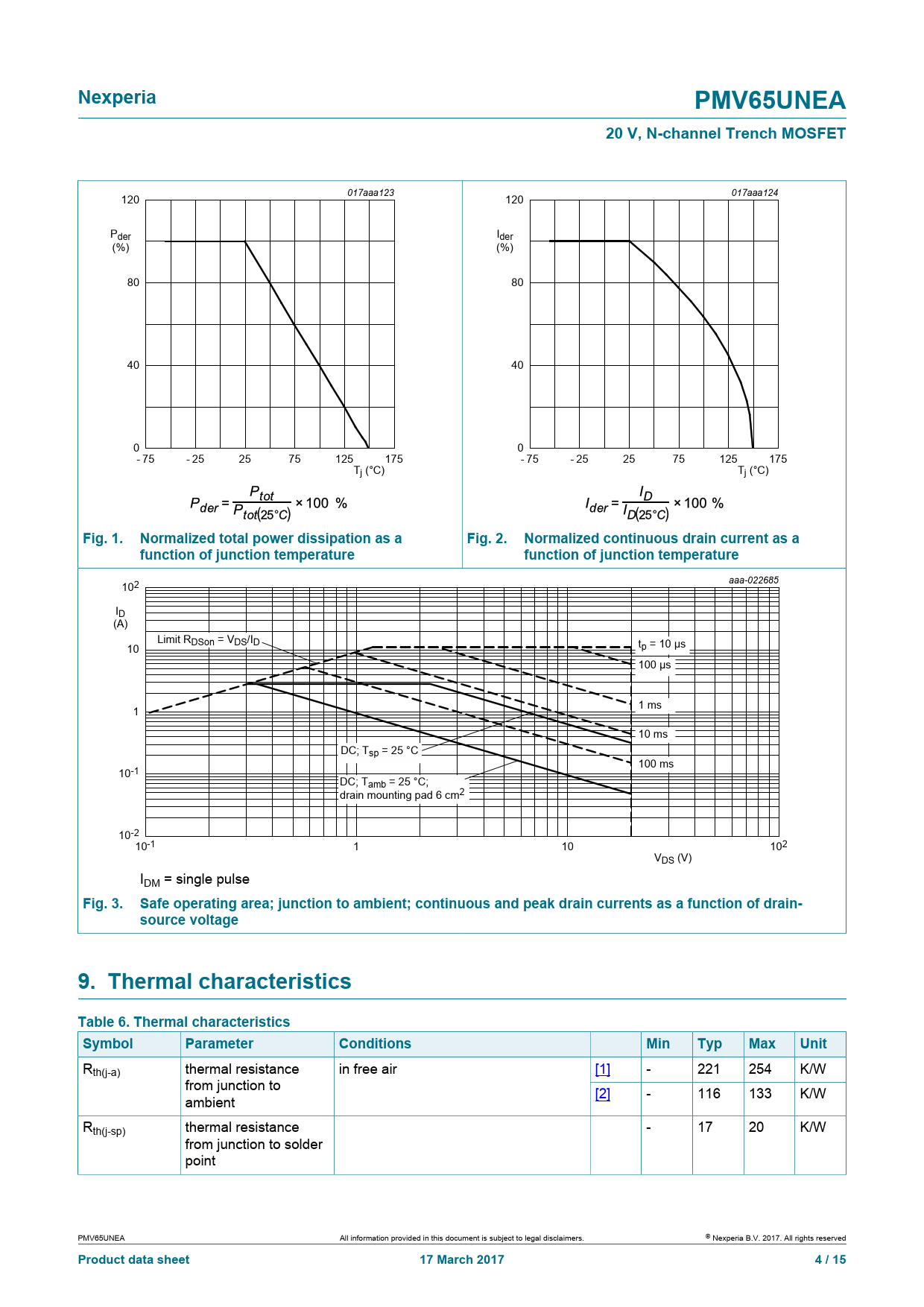

Nexperia. PMV65UNEA. 20 V, N-channel Trench MOSFET. Fig. 1. Normalized total power dissipation as a
Nexperia PMV65UNEA 20 V, N-channel Trench MOSFET Fig 1 Normalized total power dissipation as a
link to page 5 link to page 5
017aaa123 120 017aaa124 120 Pder Ider (%) (%) 80 80 40 40 0 0 - 75 - 25 25 75 125 175 - 75 - 25 25 75 125 175 Tj (°C) Tj (°C)
Fig. 1. Normalized total power dissipation as a Fig. 2. Normalized continuous drain current as a function of junction temperature function of junction temperature
aaa-022685 102 ID (A) Limit R 10 DSon = VDS/ID tp = 10 µs 100 µs 1 1 ms 10 ms DC; Tsp = 25 °C 100 ms 10-1 DC; Tamb = 25 °C; drain mounting pad 6 cm2 10-210-1 1 102 10 VDS (V) IDM = single pulse
Fig. 3. Safe operating area; junction to ambient; continuous and peak drain currents as a function of drain- source voltage 9. Thermal characteristics Table 6. Thermal characteristics Symbol Parameter Conditions Min Typ Max Unit
Rth(j-a) thermal resistance in free air [1] - 221 254 K/W from junction to ambient [2] - 116 133 K/W Rth(j-sp) thermal resistance - 17 20 K/W from junction to solder point PMV65UNEA All information provided in this document is subject to legal disclaimers. © Nexperia B.V. 2017. All rights reserved
