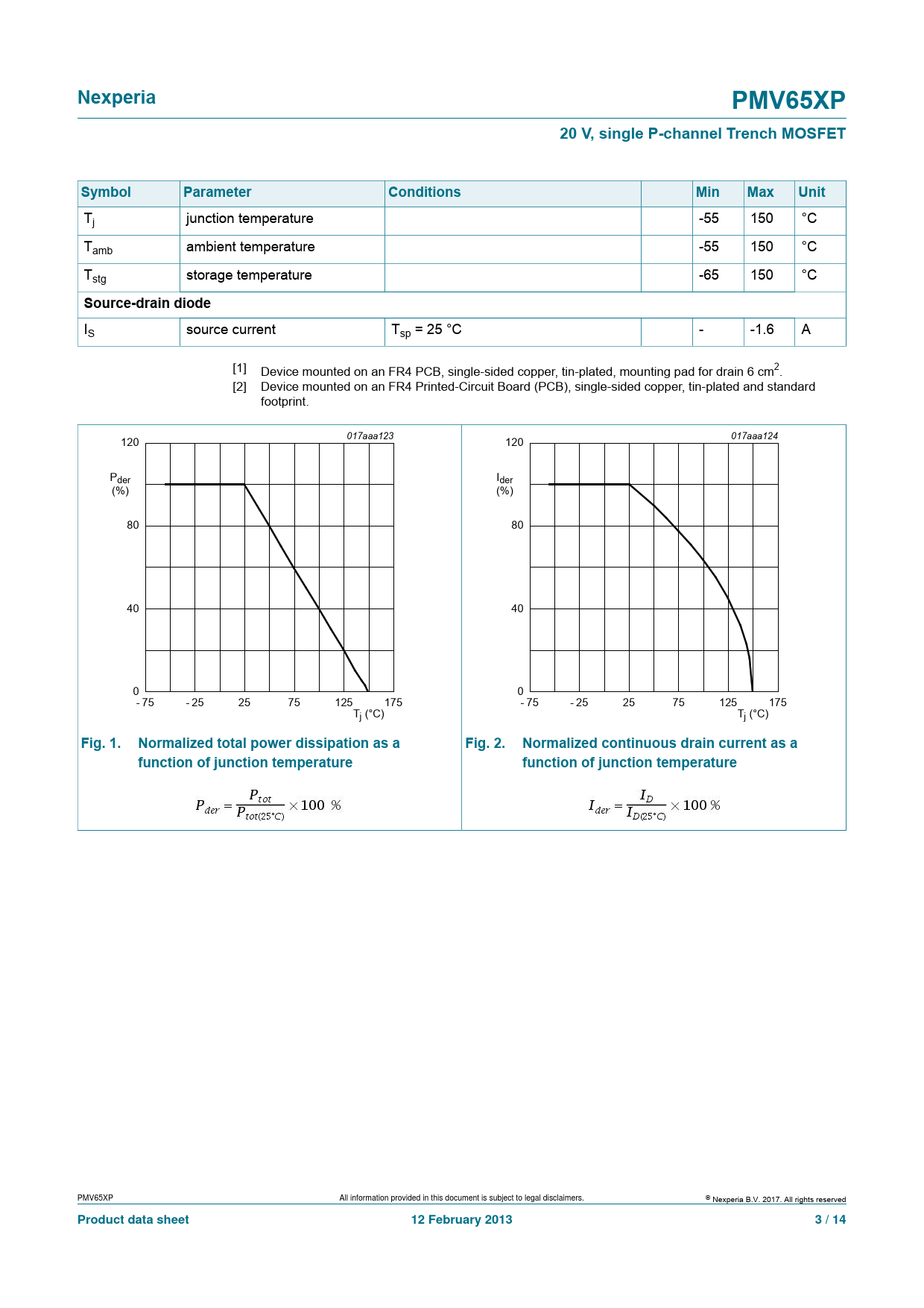

Nexperia. PMV65XP. 20 V, single P-channel Trench MOSFET. Symbol. Parameter. Conditions. Min. Max. Unit. Source-drain diode
Nexperia PMV65XP 20 V, single P-channel Trench MOSFET Symbol Parameter Conditions Min Max Unit Source-drain diode
Tj junction temperature -55 150 °C Tamb ambient temperature -55 150 °C Tstg storage temperature -65 150 °C
Source-drain diode
IS source current Tsp = 25 °C - -1.6 A [1] Device mounted on an FR4 PCB, single-sided copper, tin-plated, mounting pad for drain 6 cm2. [2] Device mounted on an FR4 Printed-Circuit Board (PCB), single-sided copper, tin-plated and standard footprint. 017aaa123 120 017aaa124 120 Pder Ider (%) (%) 80 80 40 40 0 0 - 75 - 25 25 75 125 175 - 75 - 25 25 75 125 175 Tj (°C) Tj (°C)
Fig. 1. Normalized total power dissipation as a Fig. 2. Normalized continuous drain current as a function of junction temperature function of junction temperature
