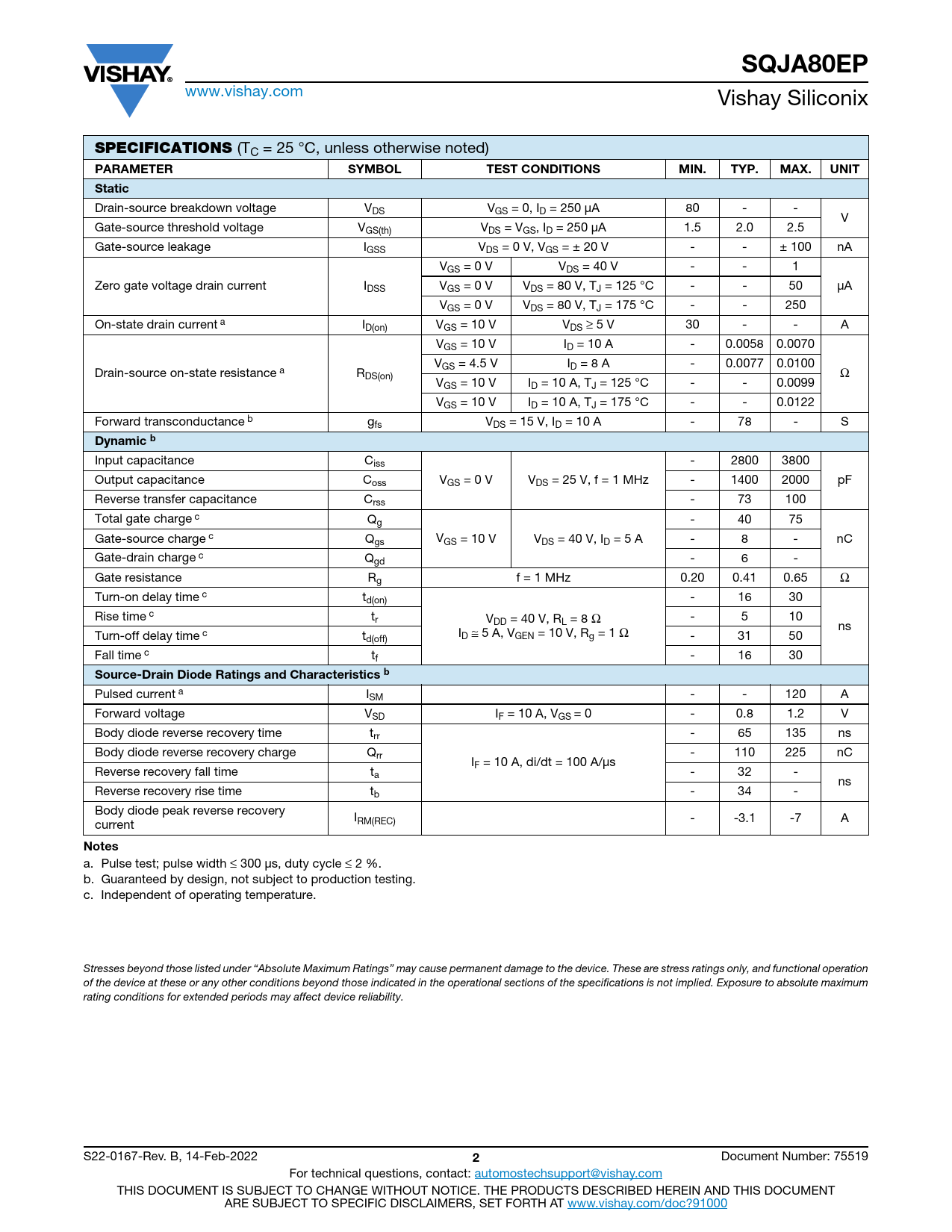

SQJA80EP. SPECIFICATIONS. PARAMETER SYMBOL. TEST. CONDITIONS. MIN. TYP. MAX. UNIT. Static. Dynamic b
SQJA80EP SPECIFICATIONS PARAMETER SYMBOL TEST CONDITIONS MIN TYP MAX UNIT Static Dynamic b
SQJA80EP
SPECIFICATIONS
(TC = 25 °C, unless otherwise noted)
PARAMETER SYMBOL TEST CONDITIONS MIN. TYP. MAX. UNIT Static
Drain-source breakdown voltage VDS VGS = 0, ID = 250 μA 80 - - V Gate-source threshold voltage VGS(th) VDS = VGS, ID = 250 μA 1.5 2.0 2.5 Gate-source leakage IGSS VDS = 0 V, VGS = ± 20 V - - ± 100 nA VGS = 0 V VDS = 40 V - - 1 Zero gate voltage drain current IDSS VGS = 0 V VDS = 80 V, TJ = 125 °C - - 50 μA VGS = 0 V VDS = 80 V, TJ = 175 °C - - 250 On-state drain current a ID(on) VGS = 10 V VDS ≥ 5 V 30 - - A VGS = 10 V ID = 10 A - 0.0058 0.0070 VGS = 4.5 V ID = 8 A - 0.0077 0.0100 Drain-source on-state resistance a RDS(on) Ω VGS = 10 V ID = 10 A, TJ = 125 °C - - 0.0099 VGS = 10 V ID = 10 A, TJ = 175 °C - - 0.0122 Forward transconductance b gfs VDS = 15 V, ID = 10 A - 78 - S
Dynamic b
Input capacitance Ciss - 2800 3800 Output capacitance Coss VGS = 0 V VDS = 25 V, f = 1 MHz - 1400 2000 pF Reverse transfer capacitance Crss - 73 100 Total gate charge c Qg - 40 75 Gate-source charge c Qgs VGS = 10 V VDS = 40 V, ID = 5 A - 8 - nC Gate-drain charge c Qgd - 6 - Gate resistance Rg f = 1 MHz 0.20 0.41 0.65 Ω Turn-on delay time c td(on) - 16 30 Rise time c tr V - 5 10 DD = 40 V, RL = 8 Ω ns I Turn-off delay time c t D ≅ 5 A, VGEN = 10 V, Rg = 1 Ω d(off) - 31 50 Fall time c tf - 16 30
Source-Drain Diode Ratings and Characteristics b
Pulsed current a ISM - - 120 A Forward voltage VSD IF = 10 A, VGS = 0 - 0.8 1.2 V Body diode reverse recovery time trr - 65 135 ns Body diode reverse recovery charge Qrr - 110 225 nC IF = 10 A, di/dt = 100 A/μs Reverse recovery fall time ta - 32 - ns Reverse recovery rise time tb - 34 - Body diode peak reverse recovery I current RM(REC) - -3.1 -7 A
Notes
a. Pulse test; pulse width ≤ 300 μs, duty cycle ≤ 2 %. b. Guaranteed by design, not subject to production testing. c. Independent of operating temperature. Stresses beyond those listed under “Absolute Maximum Ratings” may cause permanent damage to the device. These are stress ratings only, and functional operation of the device at these or any other conditions beyond those indicated in the operational sections of the specifications is not implied. Exposure to absolute maximum rating conditions for extended periods may affect device reliability. S22-0167-Rev. B, 14-Feb-2022
