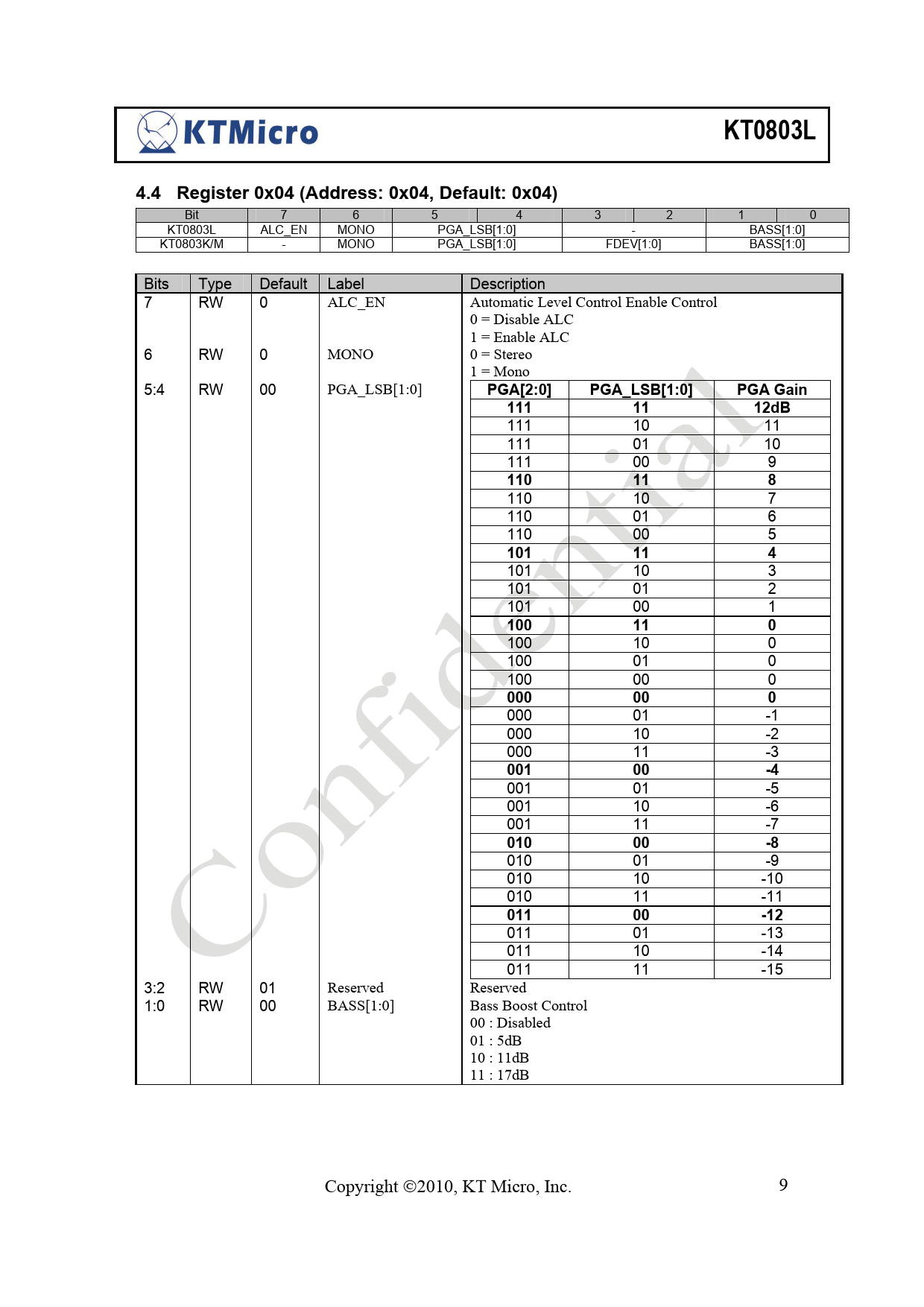

KT0803L. 4.4 Register 0x04 (Address: 0x04, Default: 0x04). PGA[2:0] PGA_LSB[1:0] PGA. Gain. 111 11 12dB. 110 11. 101 11. 100 11. 000 00
![KT0803L 4.4 Register 0x04 (Address: 0x04, Default: 0x04) PGA[2:0] PGA_LSB[1:0] PGA Gain 111 11 12dB 110 11 101 11 100 11 000 00](https://www.rlocman.ru/datasheet/img.php?di=186075&p=8)
Bit 7 6 5 4 3 2 1 0 KT0803L ALC_EN MONO PGA_LSB[1:0] - BASS[1:0] KT0803K/M - MONO PGA_LSB[1:0] FDEV[1:0] BASS[1:0] Bits Type Default Label Description 7 RW 0 ALC_EN Automatic Level Control Enable Control 0 = Disable ALC 1 = Enable ALC 6 RW 0 MONO 0 = Stereo 1 = Mono 5:4 RW 00 PGA_LSB[1:0]
111 10 11 111 01 10 111 00 9
110 11 8
110 10 7 110 01 6 110 00 5
101 11 4
101 10 3 101 01 2 101 00 1
100 11 0
100 10 0 100 01 0 100 00 0
000 00 0
000 01 -1 000 10 -2 000 11 -3
001 00 -4
001 01 -5 001 10 -6 001 11 -7
010 00 -8
010 01 -9 010 10 -10 010 11 -11
011 00 -12
011 01 -13 011 10 -14 011 11 -15 3:2 RW 01 Reserved Reserved 1:0 RW 00 BASS[1:0] Bass Boost Control 00 : Disabled 01 : 5dB 10 : 11dB 11 : 17dB Copyright ©2010, KT Micro, Inc. 9
