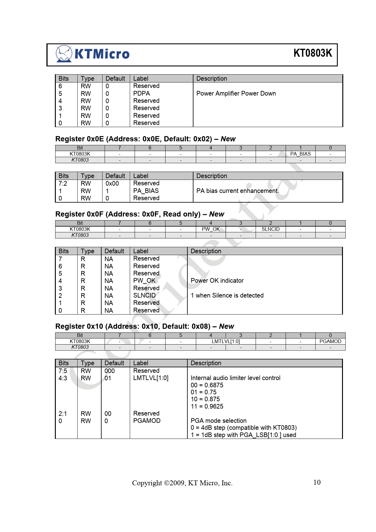

KT0803K. Register 0x0E (Address: 0x0E, Default: 0x02) – New. Register 0x0F (Address: 0x0F, Read only) – New
KT0803K Register 0x0E (Address: 0x0E, Default: 0x02) – New Register 0x0F (Address: 0x0F, Read only) – New
KT0803K
Bits Type Default Label Description 6 RW 0 Reserved 5 RW 0 PDPA Power Amplifier Power Down 4 RW 0 Reserved 3 RW 0 Reserved 1 RW 0 Reserved 0 RW 0 Reserved
Bit 7 6 5 4 3 2 1 0 KT0803K - - - - - - PA_BIAS - KT0803 - - - - - - - - Bits Type Default Label Description 7:2 RW 0x00 Reserved 1 RW 1 PA_BIAS PA bias current enhancement. 0 RW 0 Reserved
Bit 7 6 5 4 3 2 1 0 KT0803K - - - PW_OK - SLNCID - - KT0803 - - - - - - - - Bits Type Default Label Description 7 R NA Reserved 6 R NA Reserved 5 R NA Reserved 4 R NA PW_OK Power OK indicator 3 R NA Reserved 2 R NA SLNCID 1 when Silence is detected 1 R NA Reserved 0 R NA Reserved
Register 0x10 (Address: 0x10, Default: 0x08) – New
Bit 7 6 5 4 3 2 1 0 KT0803K - - - LMTLVL[1:0] - - PGAMOD KT0803 - - - - - - - - Bits Type Default Label Description 7:5 RW 000 Reserved 4:3 RW 01 LMTLVL[1:0] Internal audio limiter level control 00 = 0.6875 01 = 0.75 10 = 0.875 11 = 0.9625 2:1 RW 00 Reserved 0 RW 0 PGAMOD PGA mode selection 0 = 4dB step (compatible with KT0803) 1 = 1dB step with PGA_LSB[1:0 ] used Copyright ©2009, KT Micro, Inc. 10
