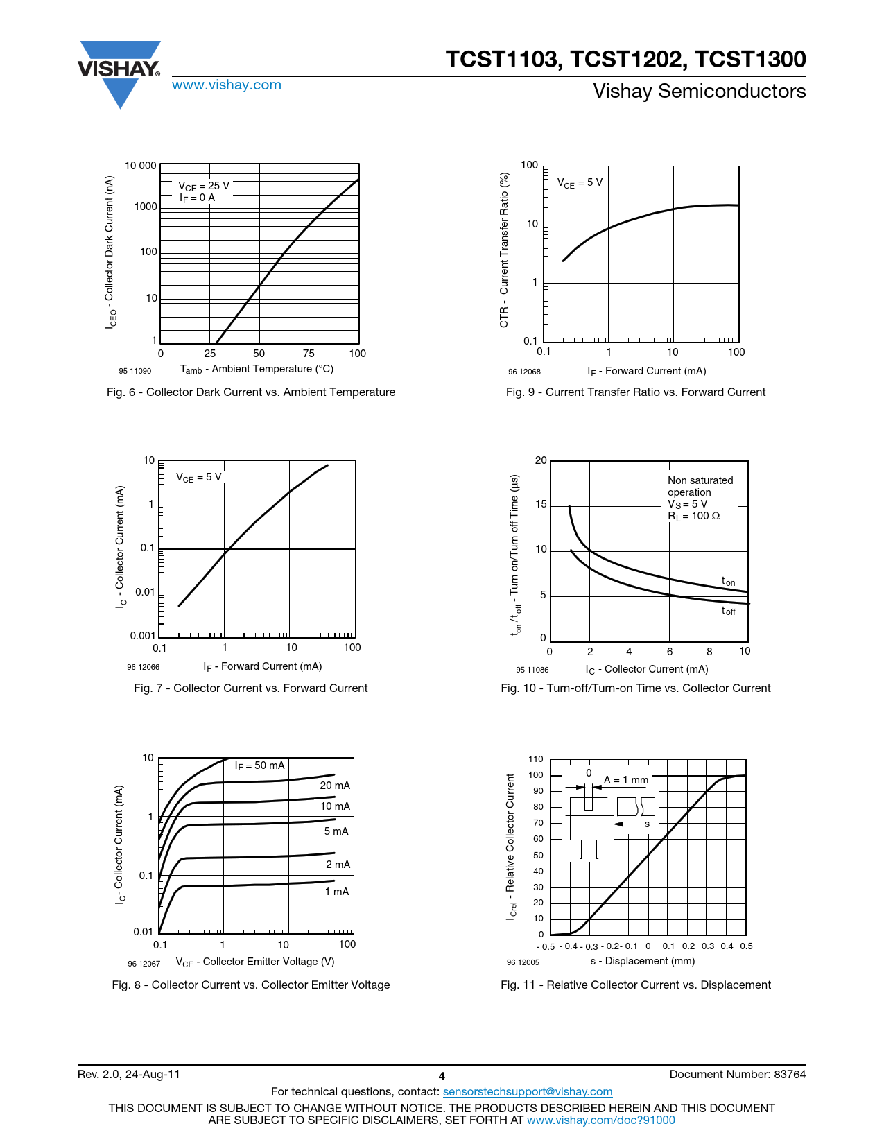

www.vishay.com Vishay Semiconductors 10 000 100 V V CE = 25 V CE = 5 V I F = 0 A 1000 10 100 1 10 - Collector Dark Current (nA) I CEO CTR - Current Transfer Ratio (%) 1 0.1 0 25 50 75 100 0.1 1 10 100 95 11090 T amb - Ambient Temperature (°C) 96 12068 I F - Forward Current (mA) Fig. 6 - Collector Dark Current vs. Ambient Temperature Fig. 9 - Current Transfer Ratio vs. Forward Current 10 20 VCE = 5 V Non saturated operation 1 15 V S = 5 V R L = 100 Ω 0.1 10 /Turn off Time (µs) t on - Collector Current (mA) 0.01 - Turn on 5 I C off t off / t on 0.001 t 0 0.1 1 10 100 0 2 4 6 8 10 96 12066 I F - Forward Current (mA) 95 11086 I C - Collector Current (mA) Fig. 7 - Collector Current vs. Forward Current Fig. 10 - Turn-off/Turn-on Time vs. Collector Current 10 110 I F = 50 mA 100 0 A = 1 mm 20 mA 90 10 mA 80 1 70 s 5 mA 60 50 2 mA 0.1 40 - Collector Current (mA) 30 1 mA - Relative Collector Current I C 20 I Crel 10 0.01 0 0.1 1 10 100 - 0.5 - 0.4 - 0.3 - 0.2- 0.1 0 0.1 0.2 0.3 0.4 0.5 96 12067 V CE - Collector Emitter Voltage (V) 96 12005 s - Displacement (mm) Fig. 8 - Collector Current vs. Collector Emitter Voltage Fig. 11 - Relative Collector Current vs. Displacement Rev. 2.0, 24-Aug-11
