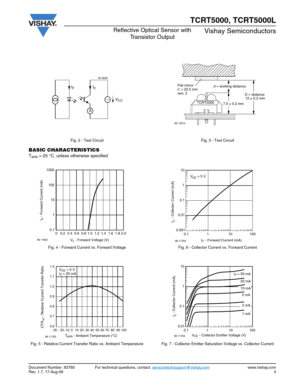

Reflective Optical Sensor with Vishay Semiconductors Transistor Output 94 9226 Flat mirror I d = working distance F IC ∅ = 22.5 mm rem. 2 D = distance V 12 ± 0.2 mm CC TCRT5000 7.0 ± 0.2 mm A 96 12314 Fig. 2 - Test Circuit Fig. 3 - Test Circuit
BASIC CHARACTERISTICS
Tamb = 25 °C, unless otherwise specified 1000 10 V CE = 5 V 100 1 rrent (mA) u rrent (mA) u 10 0.1 ard C w 1 - For 0.01 I F - Collector C I C 0.1 0.001 0 0.2 0.4 0.6 0.8 1.0 1.2 1.4 1.6 1.8 2.0 0.1 1 10 100 96 11862 V - Forward Voltage (V) F 96 11763 I F - Forward Current (mA) Fig. 4 - Forward Current vs. Forward Voltage Fig. 6 - Collector Current vs. Forward Current 1.2 10 V CE = 5 V I F = 20 mA I F = 50 mA 1.1 20 mA 1.0 1 10 mA rrent (mA) u rrent Transfer Ratio 0.9 5 mA u e C v 0.8 0.1 2 mA - Collector C 1 mA - Relati 0.7 I C rel 0.6 CTR 0.01 - 30 - 20 -10 0 10 20 30 40 50 60 70 80 90 100 0.1 1 10 100 T amb - Ambient Temperature (°C) 96 11764 V 96 11762 CE - Collector Emitter Voltage (V) Fig. 5 - Relative Current Transfer Ratio vs. Ambient Temperature Fig. 7 - Collector Emitter Saturation Voltage vs. Collector Current Document Number: 83760 For technical questions, contact: sensorstechsupport@vishay.com www.vishay.com Rev. 1.7, 17-Aug-09 3
