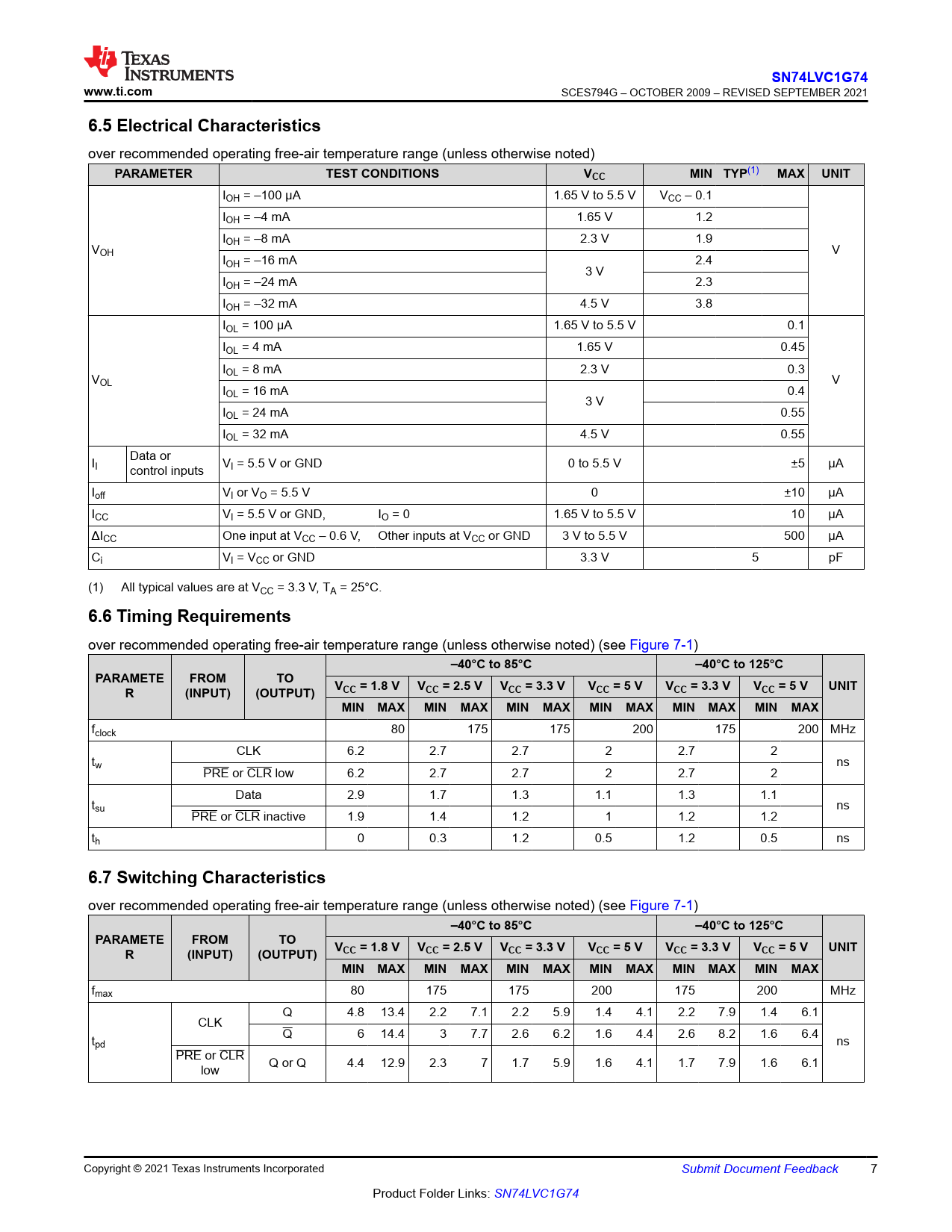

6.5 Electrical Characteristics
over recommended operating free-air temperature range (unless otherwise noted)
PARAMETER TEST CONDITIONS VCC MIN TYP
(1)
MAX UNIT
IOH = –100 µA 1.65 V to 5.5 V VCC – 0.1 IOH = –4 mA 1.65 V 1.2 IOH = –8 mA 2.3 V 1.9 VOH V IOH = –16 mA 2.4 3 V IOH = –24 mA 2.3 IOH = –32 mA 4.5 V 3.8 IOL = 100 µA 1.65 V to 5.5 V 0.1 IOL = 4 mA 1.65 V 0.45 IOL = 8 mA 2.3 V 0.3 VOL V IOL = 16 mA 0.4 3 V IOL = 24 mA 0.55 IOL = 32 mA 4.5 V 0.55 Data or II V control inputs I = 5.5 V or GND 0 to 5.5 V ±5 µA Ioff VI or VO = 5.5 V 0 ±10 µA ICC VI = 5.5 V or GND, IO = 0 1.65 V to 5.5 V 10 µA ΔICC One input at VCC – 0.6 V, Other inputs at VCC or GND 3 V to 5.5 V 500 µA Ci VI = VCC or GND 3.3 V 5 pF (1) All typical values are at VCC = 3.3 V, TA = 25°C.
6.6 Timing Requirements
over recommended operating free-air temperature range (unless otherwise noted) (see Figure 7-1)
–40°C to 85°C –40°C to 125°C PARAMETE FROM TO VCC = 1.8 V VCC = 2.5 V VCC = 3.3 V VCC = 5 V VCC = 3.3 V VCC = 5 V UNIT R (INPUT) (OUTPUT) MIN MAX MIN MAX MIN MAX MIN MAX MIN MAX MIN MAX
fclock 80 175 175 200 175 200 MHz CLK 6.2 2.7 2.7 2 2.7 2 tw ns PRE or CLR low 6.2 2.7 2.7 2 2.7 2 Data 2.9 1.7 1.3 1.1 1.3 1.1 tsu ns PRE or CLR inactive 1.9 1.4 1.2 1 1.2 1.2 th 0 0.3 1.2 0.5 1.2 0.5 ns
6.7 Switching Characteristics
fmax 80 175 175 200 175 200 MHz Q 4.8 13.4 2.2 7.1 2.2 5.9 1.4 4.1 2.2 7.9 1.4 6.1 CLK Q 6 14.4 3 7.7 2.6 6.2 1.6 4.4 2.6 8.2 1.6 6.4 tpd ns PRE or CLR Q or Q 4.4 12.9 2.3 7 1.7 5.9 1.6 4.1 1.7 7.9 1.6 6.1 low Copyright © 2021 Texas Instruments Incorporated Submit Document Feedback 7 Product Folder Links: SN74LVC1G74 Document Outline 1 Features 2 Applications 3 Description Table of Contents 4 Revision History 5 Pin Configuration and Functions 6 Specifications 6.1 Absolute Maximum Ratings 6.2 ESD Ratings 6.3 Recommended Operating Conditions 6.4 Thermal Information 6.5 Electrical Characteristics 6.6 Timing Requirements 6.7 Switching Characteristics 6.8 Operating Characteristics 6.9 Typical Characteristics 7 Parameter Measurement Information 8 Detailed Description 8.1 Overview 8.2 Functional Block Diagram 8.3 Feature Description 8.4 Device Functional Modes 9 Application and Implementation 9.1 Application Information 9.2 Typical Power Button Circuit 9.2.1 Design Requirements 9.2.2 Detailed Design Procedure 9.2.3 Application Curves 10 Power Supply Recommendations 11 Layout 11.1 Layout Guidelines 11.2 Layout Example 12 Device and Documentation Support 12.1 Receiving Notification of Documentation Updates 12.2 Support Resources 12.3 Trademarks 12.4 Electrostatic Discharge Caution 12.5 Glossary 13 Mechanical, Packaging, and Orderable Information
