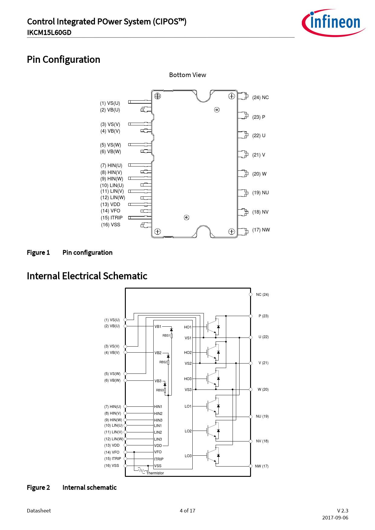

Pages / Page17 / 4 — Control. Integrated. POwer. System. (CIPOS™). IKCM15L60GD. Pin. …
Control. Integrated. POwer. System. (CIPOS™). IKCM15L60GD. Pin. Configuration. Bottom. View. (24). NC. (1). VS(U). (2). VB(U). (23). P. (3). VS(V). (4). VB(V)
Control Integrated POwer System (CIPOS™) IKCM15L60GD Pin Configuration Bottom View (24) NC (1) VS(U) (2) VB(U) (23) P (3) VS(V) (4) VB(V)
Control Integrated POwer System (CIPOS™) IKCM15L60GD Pin Configuration Bottom View (24) NC (1) VS(U) (2) VB(U) (23) P (3) VS(V) (4) VB(V) (22) U (5) VS(W) (6) VB(W) (21) V (7) HIN(U) (8) HIN(V) (20) W (9) HIN(W) (10) LIN(U) (11) LIN(V) (19) NU (12) LIN(W) (13) VDD (14) VFO (18) NV (15) ITRIP (16) VSS (17) NW Figure 1 Pin configuration Internal Electrical Schematic NC (24) P (23) (1) VS(U) (2) VB(U) VB1 HO1 RBS1 VS1 U (22) (3) VS(V) (4) VB(V) VB2 HO2 RBS2 VS2 V (21) (5) VS(W) HO3 (6) VB(W) VB3 RBS3 VS3 W (20) (7) HIN(U) HIN1 LO1 (8) HIN(V) HIN2 NU (19) (9) HIN(W) HIN3 (10) LIN(U) LIN1 (11) LIN(V) LIN2 LO2 (12) LIN(W) LIN3 NV (18) (13) VDD VDD (14) VFO VFO LO3 (15) ITRIP ITRIP (16) VSS VSS NW (17) Thermistor Figure 2 Internal schematic Datasheet 4 of 17 V 2.3 2017-09-06 Document Outline Table of contents CIPOS™ Control Integrated POwer System Features Target Applications Description System Configuration Pin Configuration Internal Electrical Schematic Pin Assignment Pin Description HIN(U, V, W) and LIN(U, V, W) (Low side and high side control pins, Pin 7 - 12) VFO (Fault-output and NTC, Pin 14) ITRIP (Over current detection function, Pin 15) VDD, VSS (Low side control supply and reference, Pin 13, 16) VB(U, V, W) and VS(U, V, W) (High side supplies, Pin 1 - 6) NW, NV, NU (Low side emitter, Pin 17 - 19) W, V, U (High side emitter and low side collector, Pin 20 - 22) P (Positive bus input voltage, Pin 23) Absolute Maximum Ratings Module Section Inverter Section Control Section Recommended Operation Conditions Static Parameters Dynamic Parameters Bootstrap Parameters Thermistor Mechanical Characteristics and Ratings Circuit of a Typical Application Switching Times Definition Electrical characteristic Package Outline Revision history
