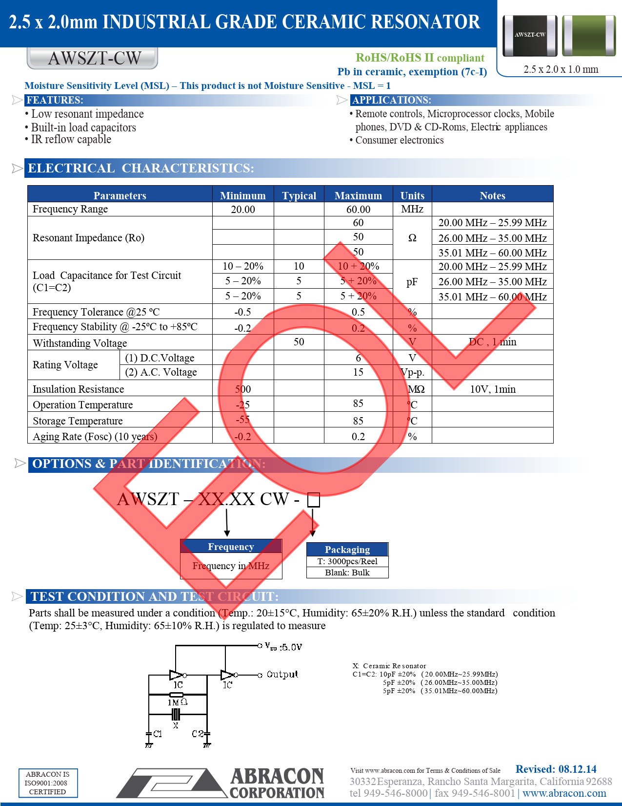

| Manufacturer | Abracon |
| Description | Ceramic resonator 25 MHz SMD |
| Pages / Page | 3 / 1 — 2.5 x 2.0mm INDUSTRIAL GRADE CER. AMIC RESONATOR. AWSZT-CW. RoHS/RoHS II … |
| File Format / Size | PDF / 1.3 Mb |
2.5 x 2.0mm INDUSTRIAL GRADE CER. AMIC RESONATOR. AWSZT-CW. RoHS/RoHS II compliant. Pb in ceramic, exemption (7c-I)
2.5 x 2.0mm INDUSTRIAL GRADE CER AMIC RESONATOR AWSZT-CW
AWSZT-CW
RoHS/RoHS II compliant Pb in ceramic, exemption (7c-I)
2.5 x 2.0 x 1.0 mm
Moisture Sensitivity Level (MSL) – This product is not Moisture Sensitive - MSL = 1 FEATURES: APPLICATIONS:
• Low resonant impedance • Remote controls, Microprocessor clocks, Mobile • Built-in load capacitors phones, DVD & CD-Roms, Electric appliances • IR reflow capable • Consumer electronics
ELECTRICAL CHARACTERISTICS: Parameters Minimum Typical Maximum Units Notes
Frequency Range 20.00 60.00 MHz 60 20.00 MHz – 25.99 MHz Resonant Impedance (Ro) 50 Ω 26.00 MHz – 35.00 MHz 50 35.01 MHz – 60.00 MHz 10 – 20% 10 10 + 20% 20.00 MHz – 25.99 MHz Load Capacitance for Test Circuit (C1=C2) 5 – 20% 5 5 + 20% pF 26.00 MHz – 35.00 MHz 5 – 20% 5 5 + 20% 35.01 MHz – 60.00 MHz Frequency Tolerance @25 ºC -0.5 0.5 % Frequency Stability @ -25ºC to +85ºC -0.2 0.2 % Withstanding Voltage 50 V DC , 1 min Rating Voltage (1) D.C.Voltage 6 V (2) A.C. Voltage 15 Vp-p. Insulation Resistance 500 MΩ 10V, 1min Operation Temperature -25 85 ºC Storage Temperature -55 85 ºC Aging Rate (Fosc) (10 years) -0.2 0.2 %
OPTIONS & PART IDENTIFICATION:
AWSZT – XX.XX CW -
Frequency Packaging
T: 3000pcs/Reel EOL Frequency in MHz Blank: Bulk
TEST CONDITION AND TEST CIRCUIT:
Parts shall be measured under a condition (Temp.: 20±15°C, Humidity: 65±20% R.H.) unless the standard condition (Temp: 25±3°C, Humidity: 65±10% R.H.) is regulated to measure X: Ceramic Re sonator C1=C2: 10pF ±20% ( 20.00MHz~25.99MHz) 5pF ±20% ( 26.00MHz~35.00MHz) 5pF ±20% ( 35.01MHz~60.00MHz) Visit www.abracon.com for Terms & Conditions of Sale
Revised: 08.12.14
ABRACON IS ISO9001:2008 30332 Esperanza, Rancho Santa Margarita, California 92688 CERTIFIED R tel 949-546-8000 | fax 949-546-8001 | www.abracon.com
