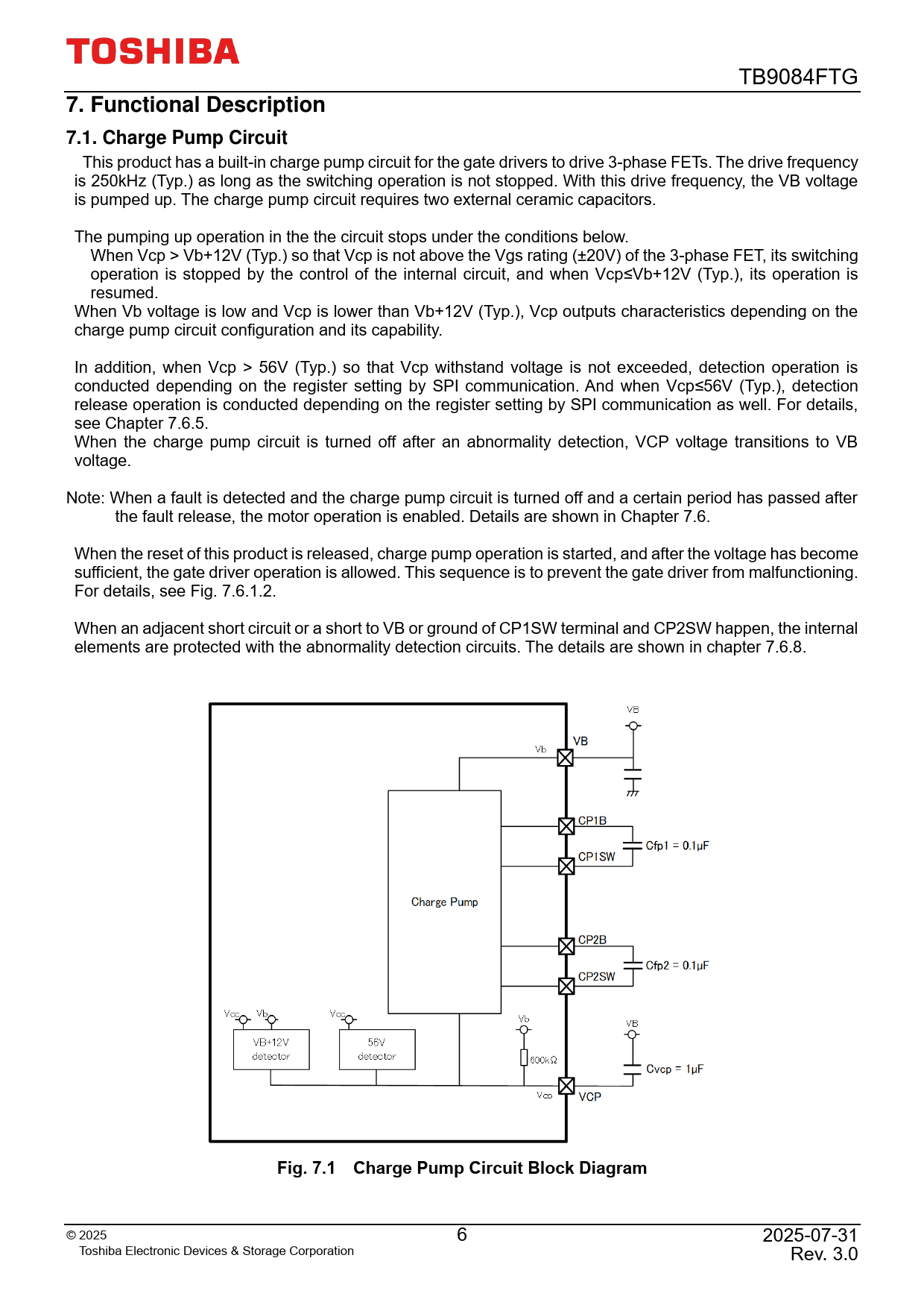

7. Functional Description 7.1. Charge Pump Circuit
This product has a built-in charge pump circuit for the gate drivers to drive 3-phase FETs. The drive frequency is 250kHz (Typ.) as long as the switching operation is not stopped. With this drive frequency, the VB voltage is pumped up. The charge pump circuit requires two external ceramic capacitors. The pumping up operation in the the circuit stops under the conditions below. When Vcp > Vb+12V (Typ.) so that Vcp is not above the Vgs rating (±20V) of the 3-phase FET, its switching operation is stopped by the control of the internal circuit, and when Vcp≤Vb+12V (Typ.), its operation is resumed. When Vb voltage is low and Vcp is lower than Vb+12V (Typ.), Vcp outputs characteristics depending on the charge pump circuit configuration and its capability. In addition, when Vcp > 56V (Typ.) so that Vcp withstand voltage is not exceeded, detection operation is conducted depending on the register setting by SPI communication. And when Vcp≤56V (Typ.), detection release operation is conducted depending on the register setting by SPI communication as wel . For details, see Chapter 7.6.5. When the charge pump circuit is turned off after an abnormality detection, VCP voltage transitions to VB voltage. Note: When a fault is detected and the charge pump circuit is turned off and a certain period has passed after the fault release, the motor operation is enabled. Details are shown in Chapter 7.6. When the reset of this product is released, charge pump operation is started, and after the voltage has become sufficient, the gate driver operation is allowed. This sequence is to prevent the gate driver from malfunctioning. For details, see Fig. 7.6.1.2. When an adjacent short circuit or a short to VB or ground of CP1SW terminal and CP2SW happen, the internal elements are protected with the abnormality detection circuits. The details are shown in chapter 7.6.8.
Fig. 7.1 Charge Pump Circuit Block Diagram
