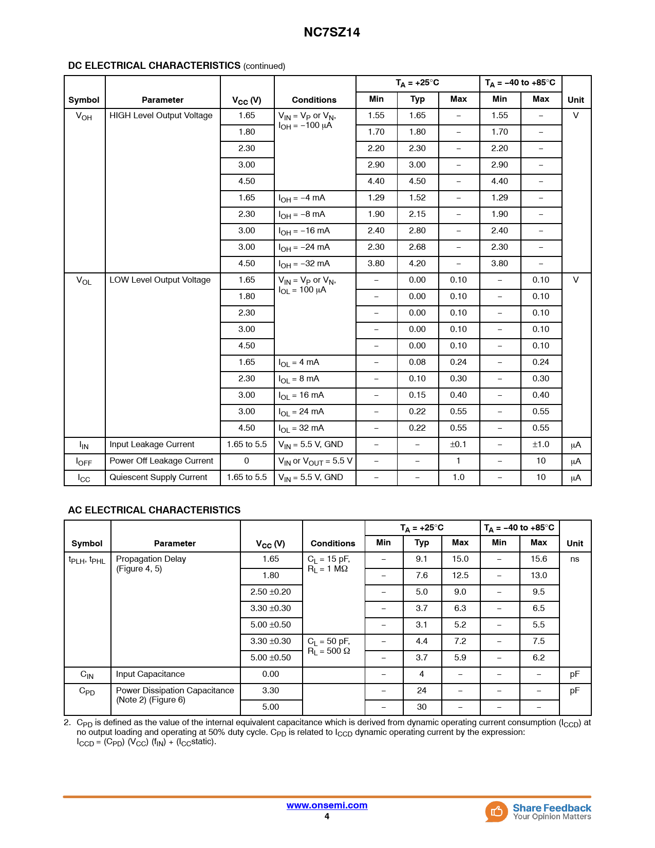

DescriptionTinyLogic UHS Inverter with Schmitt Trigger Input

NC7SZ14. DC ELECTRICAL CHARACTERISTICS. TA = +25. TA = −40 to +85. Symbol. Parameter. VCC (V). Conditions. Min. Typ. Max. Unit
NC7SZ14 DC ELECTRICAL CHARACTERISTICS TA = +25 TA = −40 to +85 Symbol Parameter VCC (V) Conditions Min Typ Max Unit
(continued)
TA = +25
C TA = −40 to +85
C Symbol Parameter VCC (V) Conditions Min Typ Max Min Max Unit
VOH HIGH Level Output Voltage 1.65 VIN = VP or VN, 1.55 1.65 − 1.55 − V IOH = −100 mA 1.80 1.70 1.80 − 1.70 − 2.30 2.20 2.30 − 2.20 − 3.00 2.90 3.00 − 2.90 − 4.50 4.40 4.50 − 4.40 − 1.65 IOH = −4 mA 1.29 1.52 − 1.29 − 2.30 IOH = −8 mA 1.90 2.15 − 1.90 − 3.00 IOH = −16 mA 2.40 2.80 − 2.40 − 3.00 IOH = −24 mA 2.30 2.68 − 2.30 − 4.50 IOH = −32 mA 3.80 4.20 − 3.80 − VOL LOW Level Output Voltage 1.65 VIN = VP or VN, − 0.00 0.10 − 0.10 V IOL = 100 mA 1.80 − 0.00 0.10 − 0.10 2.30 − 0.00 0.10 − 0.10 3.00 − 0.00 0.10 − 0.10 4.50 − 0.00 0.10 − 0.10 1.65 IOL = 4 mA − 0.08 0.24 − 0.24 2.30 IOL = 8 mA − 0.10 0.30 − 0.30 3.00 IOL = 16 mA − 0.15 0.40 − 0.40 3.00 IOL = 24 mA − 0.22 0.55 − 0.55 4.50 IOL = 32 mA − 0.22 0.55 − 0.55 IIN Input Leakage Current 1.65 to 5.5 VIN = 5.5 V, GND − − ±0.1 − ±1.0 mA IOFF Power Off Leakage Current 0 VIN or VOUT = 5.5 V − − 1 − 10 mA ICC Quiescent Supply Current 1.65 to 5.5 VIN = 5.5 V, GND − − 1.0 − 10 mA
AC ELECTRICAL CHARACTERISTICS TA = +25
C TA = −40 to +85
tPLH, tPHL Propagation Delay 1.65 CL = 15 pF, − 9.1 15.0 − 15.6 ns (Figure 4, 5) RL = 1 MW 1.80 − 7.6 12.5 − 13.0 2.50 ±0.20 − 5.0 9.0 − 9.5 3.30 ±0.30 − 3.7 6.3 − 6.5 5.00 ±0.50 − 3.1 5.2 − 5.5 3.30 ±0.30 CL = 50 pF, − 4.4 7.2 − 7.5 RL = 500 W 5.00 ±0.50 − 3.7 5.9 − 6.2 CIN Input Capacitance 0.00 − 4 − − − pF CPD Power Dissipation Capacitance 3.30 − 24 − − − pF (Note 2) (Figure 6) 5.00 − 30 − − − 2. CPD is defined as the value of the internal equivalent capacitance which is derived from dynamic operating current consumption (ICCD) at no output loading and operating at 50% duty cycle. CPD is related to ICCD dynamic operating current by the expression: ICCD = (CPD) (VCC) (fIN) + (ICCstatic).
