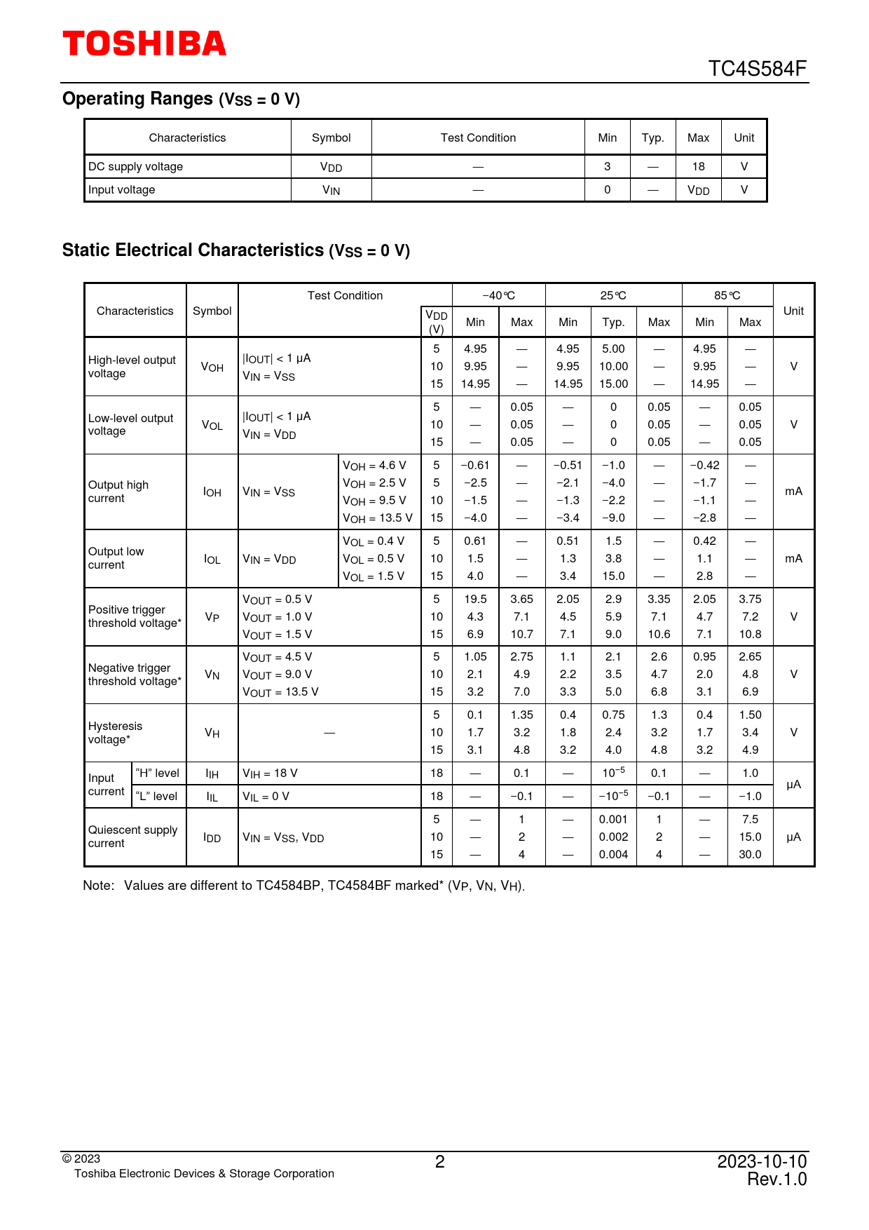

Operating Ranges (VSS = 0 V). Static Electrical Characteristics (VSS = 0 V)
Operating Ranges (VSS = 0 V) Static Electrical Characteristics (VSS = 0 V)
TC4S584F
TC4S584F
Characteristics Symbol Test Condition Min Typ. Max Unit DC supply voltage VDD ― 3 ― 18 V Input voltage VIN ― 0 ― VDD V
Test Condition −40°C 25°C 85°C Characteristics Symbol Unit V DD (V) Min Max Min Typ. Max Min Max 5 4.95 ― 4.95 5.00 ― 4.95 ― High-level output |IOUT| < 1 μA V 10 9.95 ― 9.95 10.00 ― 9.95 ― V voltage OH VIN = VSS 15 14.95 ― 14.95 15.00 ― 14.95 ― 5 ― 0.05 ― 0 0.05 ― 0.05 Low-level output |IOUT| < 1 μA V 10 ― 0.05 ― 0 0.05 ― 0.05 V voltage OL VIN = VDD 15 ― 0.05 ― 0 0.05 ― 0.05 VOH = 4.6 V 5 −0.61 ― −0.51 −1.0 ― −0.42 ― Output high VOH = 2.5 V 5 −2.5 ― −2.1 −4.0 ― −1.7 ― I mA current OH VIN = VSS VOH = 9.5 V 10 −1.5 ― −1.3 −2.2 ― −1.1 ― VOH = 13.5 V 15 −4.0 ― −3.4 −9.0 ― −2.8 ― VOL = 0.4 V 5 0.61 ― 0.51 1.5 ― 0.42 ― Output low I V 10 1.5 ― 1.3 3.8 ― 1.1 ― mA current OL VIN = VDD OL = 0.5 V VOL = 1.5 V 15 4.0 ― 3.4 15.0 ― 2.8 ― VOUT = 0.5 V 5 19.5 3.65 2.05 2.9 3.35 2.05 3.75 Positive trigger V V 10 4.3 7.1 4.5 5.9 7.1 4.7 7.2 V threshold voltage* P OUT = 1.0 V VOUT = 1.5 V 15 6.9 10.7 7.1 9.0 10.6 7.1 10.8 VOUT = 4.5 V 5 1.05 2.75 1.1 2.1 2.6 0.95 2.65 Negative trigger V V 10 2.1 4.9 2.2 3.5 4.7 2.0 4.8 V threshold voltage* N OUT = 9.0 V VOUT = 13.5 V 15 3.2 7.0 3.3 5.0 6.8 3.1 6.9 5 0.1 1.35 0.4 0.75 1.3 0.4 1.50 Hysteresis V 10 1.7 3.2 1.8 2.4 3.2 1.7 3.4 V voltage* H ― 15 3.1 4.8 3.2 4.0 4.8 3.2 4.9 “H” Input level IIH VIH = 18 V 18 ― 0.1 ― 10−5 0.1 ― 1.0 μA current “L” level IIL VIL = 0 V 18 ― −0.1 ― −10−5 −0.1 ― −1.0 5 ― 1 ― 0.001 1 ― 7.5 Quiescent supply I 10 ― 2 ― 0.002 2 ― 15.0 μA current DD VIN = VSS, VDD 15 ― 4 ― 0.004 4 ― 30.0 Note: Values are different to TC4584BP, TC4584BF marked* (VP, VN, VH). © 2023 2 2023-10-10 Toshiba Electronic Devices & Storage Corporation Rev.1.0
