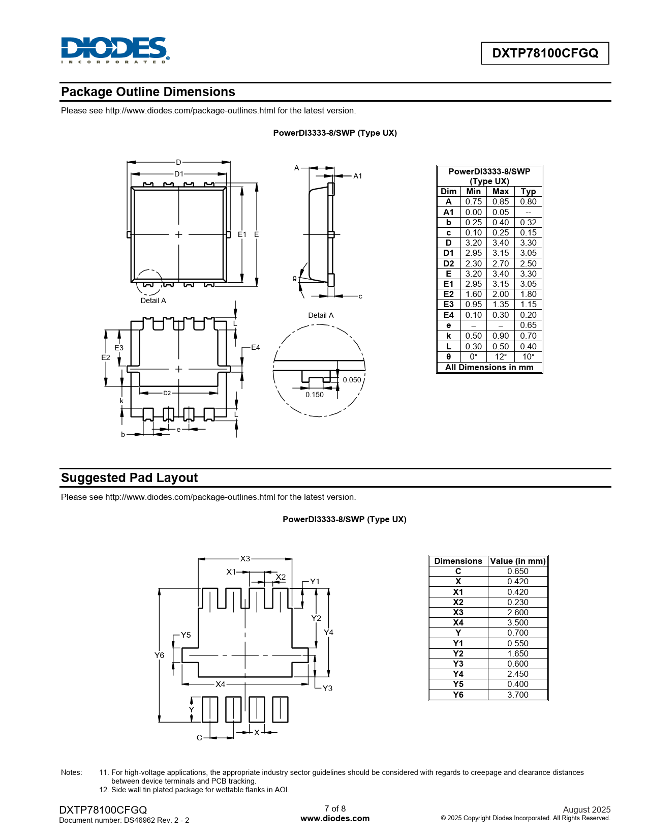

DXTP78100CFGQ. Package Outline Dimensions. PowerDI3333-8/SWP (Type UX). PowerDI3333-8/SWP. (Type UX). Dim Min Max Typ
DXTP78100CFGQ Package Outline Dimensions PowerDI3333-8/SWP (Type UX) PowerDI3333-8/SWP (Type UX) Dim Min Max Typ
Please see http://www.diodes.com/package-outlines.html for the latest version.
D A D1
PowerDI3333-8/SWP
A1
(Type UX) Dim Min Max Typ A
0.75 0.85 0.80
A1
0.00 0.05 --
b
0.25 0.40 0.32 E1 E
c
0.10 0.25 0.15
D
3.20 3.40 3.30
D1
2.95 3.15 3.05
D2
2.30 2.70 2.50
E
3.20 3.40 3.30 0
E1
2.95 3.15 3.05 c
E2
1.60 2.00 1.80 Detail A
E3
0.95 1.35 1.15 Detail A
E4
0.10 0.30 0.20 L
e
− − 0.65
k
0.50 0.90 0.70 E3 E4
L
0.30 0.50 0.40 E2
θ
0° 12° 10°
All Dimensions in mm
0.050 D2 0.150 k L e b
Suggested Pad Layout
X3
Dimensions Value (in mm)
X1
C
0.650 X2 Y1
X
0.420
X1
0.420
X2
0.230
X3
2.600 Y2
X4
3.500 Y5 Y4
Y
0.700
Y1
0.550 Y6
Y2
1.650
Y3
0.600
Y4
2.450 X4
Y5
0.400 Y3
Y6
3.700 Y X C Notes: 11. For high-voltage applications, the appropriate industry sector guidelines should be considered with regards to creepage and clearance distances between device terminals and PCB tracking. 12. Side wall tin plated package for wettable flanks in AOI. DXTP78100CFGQ 7 of 8 August 2025 Document number: DS46962 Rev. 2 - 2
