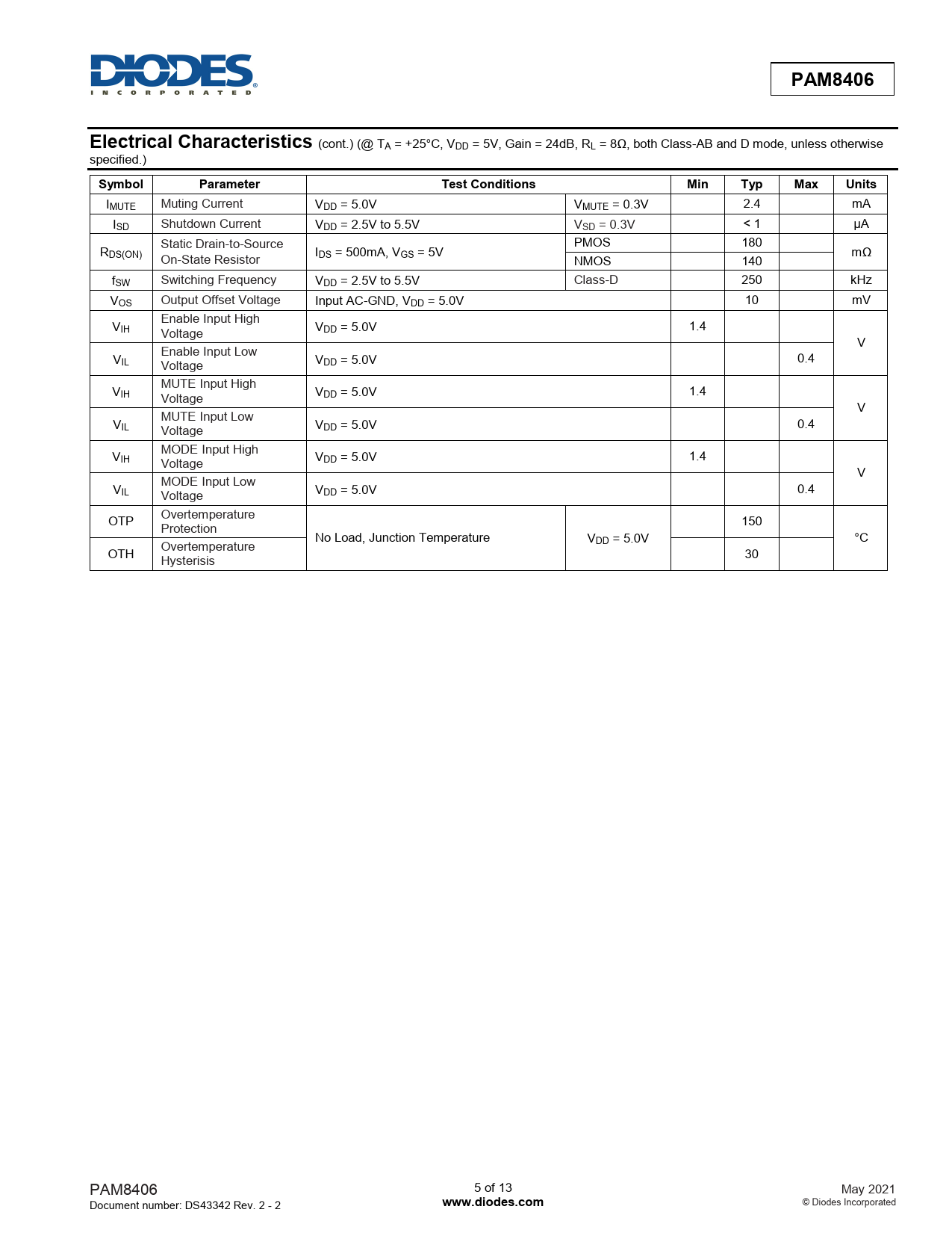

(cont.) (@ TA = +25°C, VDD = 5V, Gain = 24dB, RL = 8Ω, both Class-AB and D mode, unless otherwise specified.)
Symbol Parameter Test Conditions Min Typ Max Units
IMUTE Muting Current VDD = 5.0V VMUTE = 0.3V 2.4 mA ISD Shutdown Current VDD = 2.5V to 5.5V VSD = 0.3V < 1 µA Static Drain-to-Source PMOS 180 RDS(ON) On-State Resistor IDS = 500mA, VGS = 5V mΩ NMOS 140 fSW Switching Frequency VDD = 2.5V to 5.5V Class-D 250 kHz VOS Output Offset Voltage Input AC-GND, VDD = 5.0V 10 mV VIH Enable Input High Voltage VDD = 5.0V 1.4 V VIL Enable Input Low Voltage VDD = 5.0V 0.4 VIH MUTE Input High Voltage VDD = 5.0V 1.4 V VIL MUTE Input Low Voltage VDD = 5.0V 0.4 VIH MODE Input High Voltage VDD = 5.0V 1.4 V VIL MODE Input Low Voltage VDD = 5.0V 0.4 OTP Overtemperature Protection 150 No Load, Junction Temperature VDD = 5.0V °C OTH Overtemperature Hysterisis 30 PAM8406 5 of 13 May 2021 Document number: DS43342 Rev. 2 - 2
