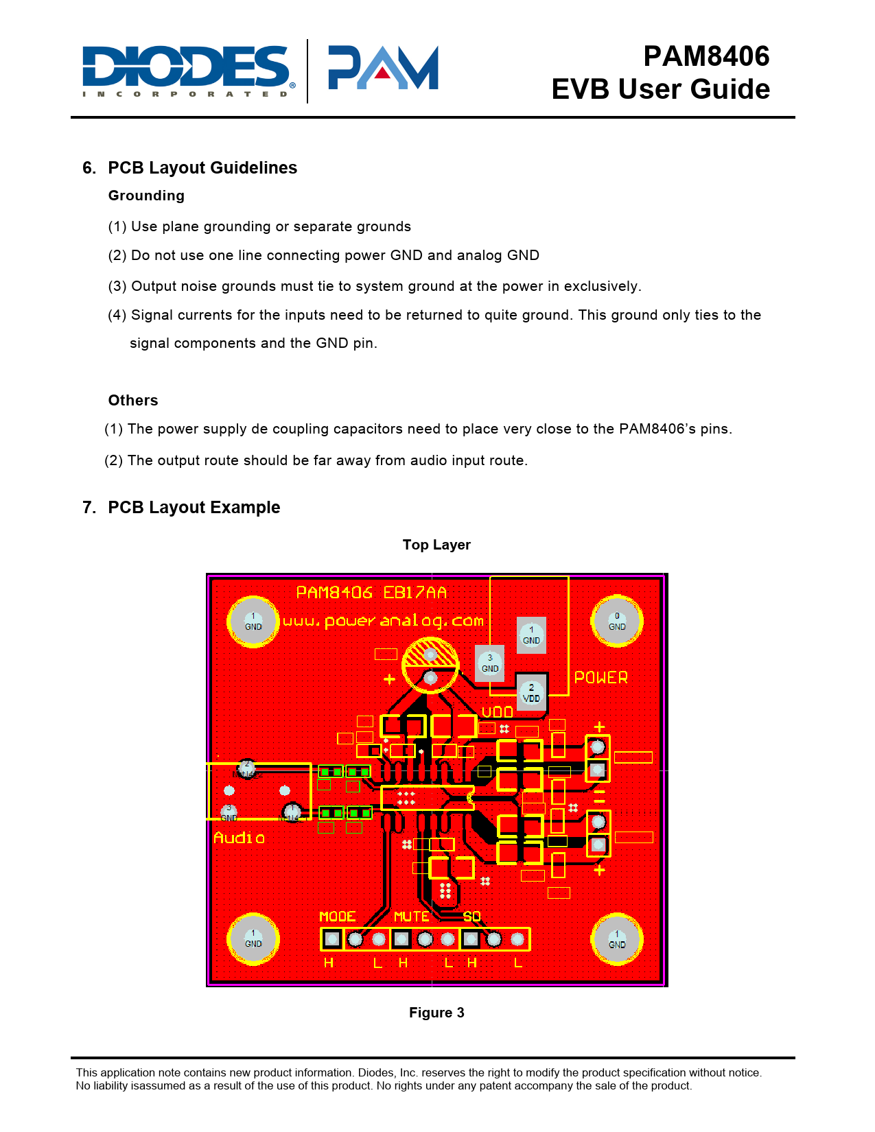

PAM8406. EVB User Guide. 6. PCB Layout Guidelines. Grounding. Others. 7. PCB Layout Example. Top Layer. Figure 3
PAM8406 EVB User Guide 6 PCB Layout Guidelines Grounding Others 7 PCB Layout Example Top Layer Figure 3
PAM8406 EVB User Guide 6. PCB Layout Guidelines Grounding
(1) Use plane grounding or separate grounds (2) Do not use one line connecting power GND and analog GND (3) Output noise grounds must tie to system ground at the power in exclusively. (4) Signal currents for the inputs need to be returned to quite ground. This ground only ties to the signal components and the GND pin.
Others
(1) The power supply de coupling capacitors need to place very close to the PAM8406’s pins. (2) The output route should be far away from audio input route.
7. PCB Layout Example Top Layer Figure 3
