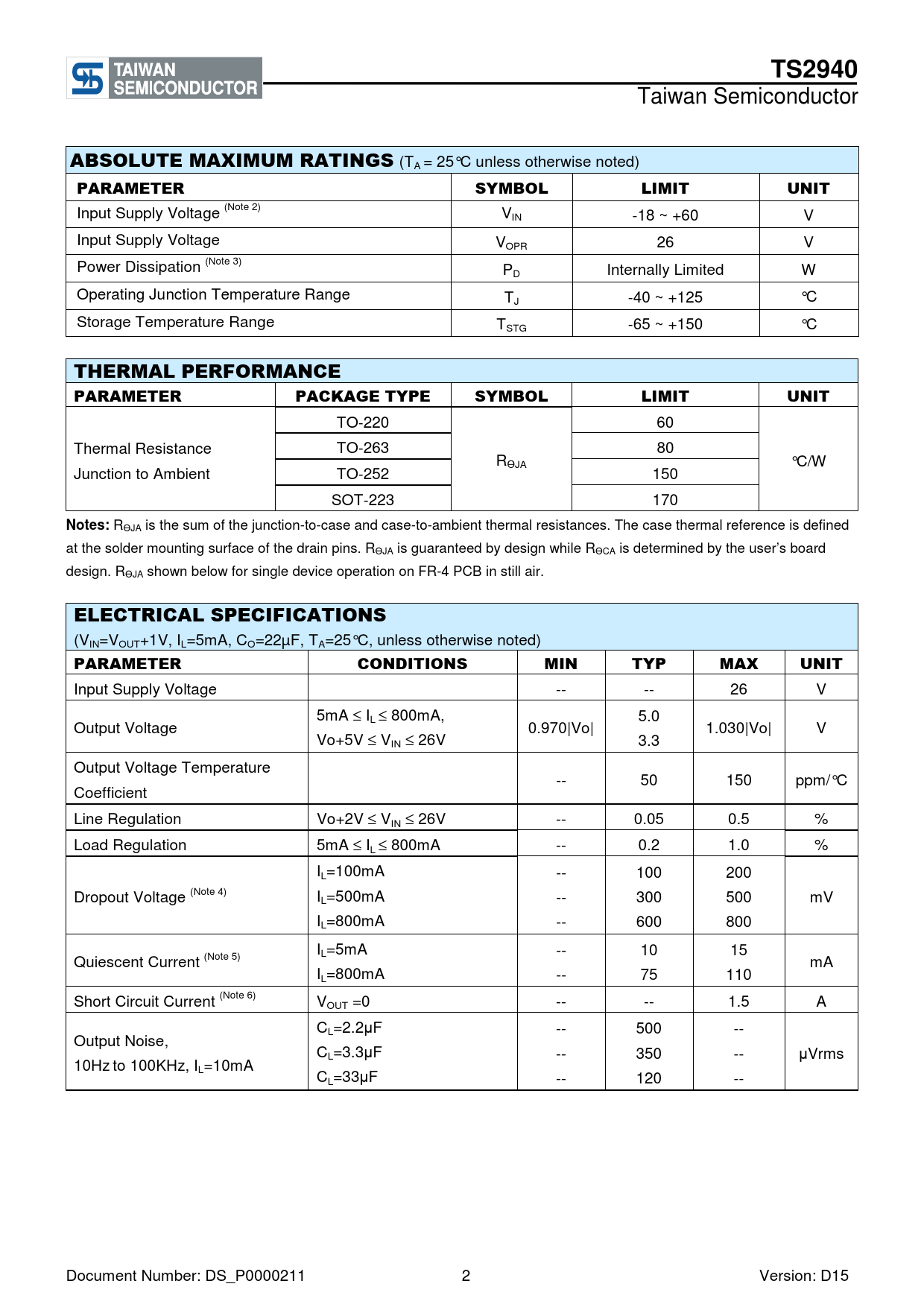

TS2940
Taiwan Semiconductor ABSOLUTE MAXIMUM RATINGS (TA = 25°C unless otherwise noted) PARAMETER SYMBOL LIMIT UNIT Input Supply Voltage (Note 2) VIN -18 ~ +60 V Input Supply Voltage VOPR 26 V Power Dissipation (Note 3) PD Internally Limited W Operating Junction Temperature Range TJ -40 ~ +125 °C Storage Temperature Range TSTG -65 ~ +150 °C THERMAL PERFORMANCE PARAMETER PACKAGE TYPE SYMBOL LIMIT UNIT TO-220 60 Thermal Resistance TO-263 80 RӨJA °C/W Junction to Ambient TO-252 150 SOT-223 170
Notes:
RӨJA is the sum of the junction-to-case and case-to-ambient thermal resistances. The case thermal reference is defined at the solder mounting surface of the drain pins. RӨJA is guaranteed by design while RӨCA is determined by the user’s board design. RӨJA shown below for single device operation on FR-4 PCB in still air. ELECTRICAL SPECIFICATIONS (VIN=VOUT+1V, IL=5mA, CO=22µF, TA=25°C, unless otherwise noted) PARAMETER CONDITIONS MIN TYP MAX UNIT Input Supply Voltage -- -- 26 V 5mA ≤ I ≤ L 800mA, 5.0 Output Voltage 0.970|Vo| 1.030|Vo| V Vo+5V ≤ VIN ≤ 26V 3.3 Output Voltage Temperature -- 50 150 ppm/°C Coefficient Line Regulation Vo+2V ≤ VIN ≤ 26V -- 0.05 0.5 % Load Regulation 5mA ≤ I ≤ L 800mA -- 0.2 1.0 % IL=100mA -- 100 200 Dropout Voltage (Note 4) IL=500mA -- 300 500 mV IL=800mA -- 600 800 IL=5mA -- 10 15 Quiescent Current (Note 5) mA IL=800mA -- 75 110 Short Circuit Current (Note 6) VOUT =0 -- -- 1.5 A CL=2.2µF -- 500 -- Output Noise, CL=3.3µF -- 350 -- µVrms 10Hz to 100KHz, IL=10mA CL=33µF -- 120 -- Document Number: DS_P0000211 2 Version: D15
