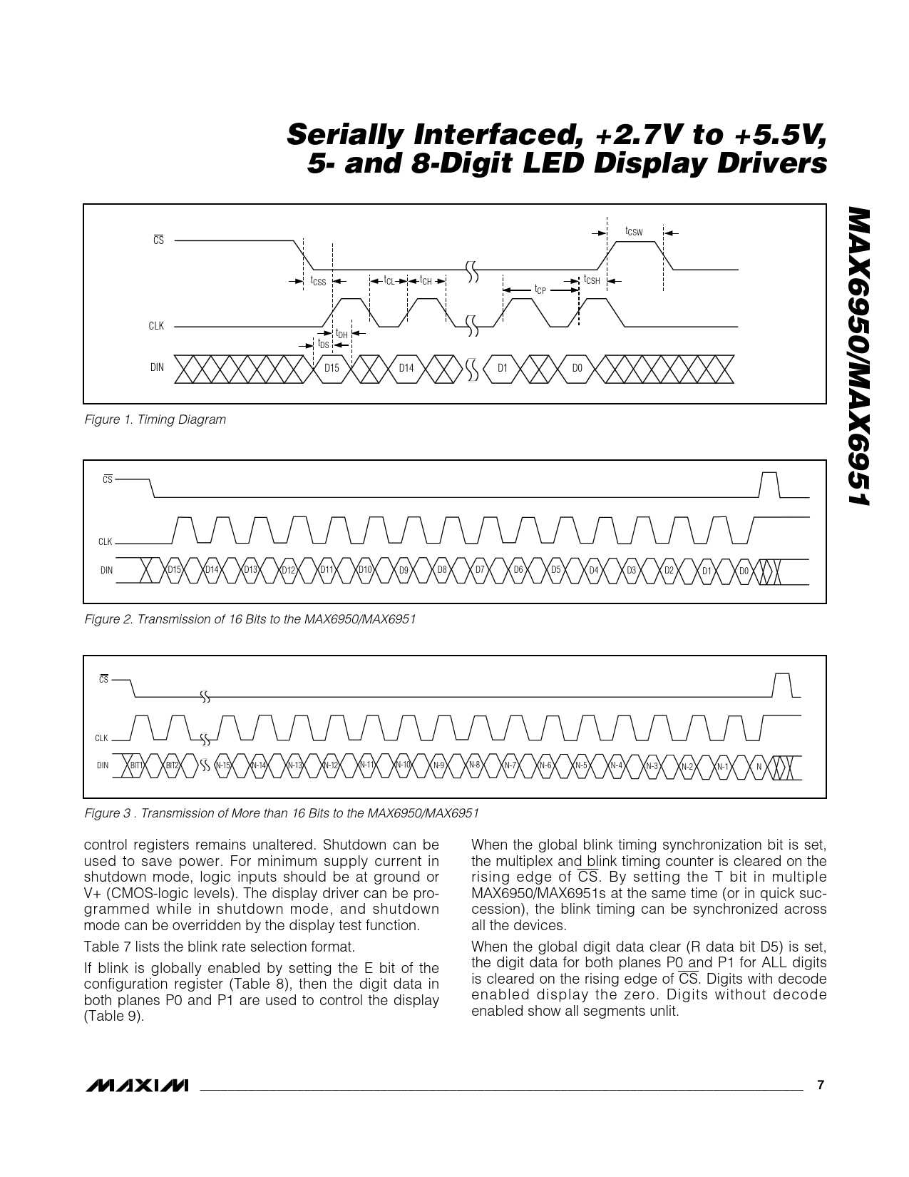

tCSW CS tCSS tCL tCH tCSH tCP CLK tDH tDS DIN D15 D14 D1 D0 Figure 1. Timing Diagram CS CLK DIN D15 D14 D13 D12 D11 D10 D9 D8 D7 D6 D5 D4 D3 D2 D1 D0 Figure 2. Transmission of 16 Bits to the MAX6950/MAX6951 CS CLK DIN BIT1 BIT2 N-15 N-14 N-13 N-12 N-11 N-10 N-9 N-8 N-7 N-6 N-5 N-4 N-3 N-2 N-1 N Figure 3 . Transmission of More than 16 Bits to the MAX6950/MAX6951 control registers remains unaltered. Shutdown can be When the global blink timing synchronization bit is set, used to save power. For minimum supply current in the multiplex and blink timing counter is cleared on the shutdown mode, logic inputs should be at ground or rising edge of CS. By setting the T bit in multiple V+ (CMOS-logic levels). The display driver can be pro- MAX6950/MAX6951s at the same time (or in quick suc- grammed while in shutdown mode, and shutdown cession), the blink timing can be synchronized across mode can be overridden by the display test function. all the devices. Table 7 lists the blink rate selection format. When the global digit data clear (R data bit D5) is set, If blink is globally enabled by setting the E bit of the the digit data for both planes P0 and P1 for ALL digits configuration register (Table 8), then the digit data in is cleared on the rising edge of CS. Digits with decode both planes P0 and P1 are used to control the display enabled display the zero. Digits without decode (Table 9). enabled show all segments unlit.
