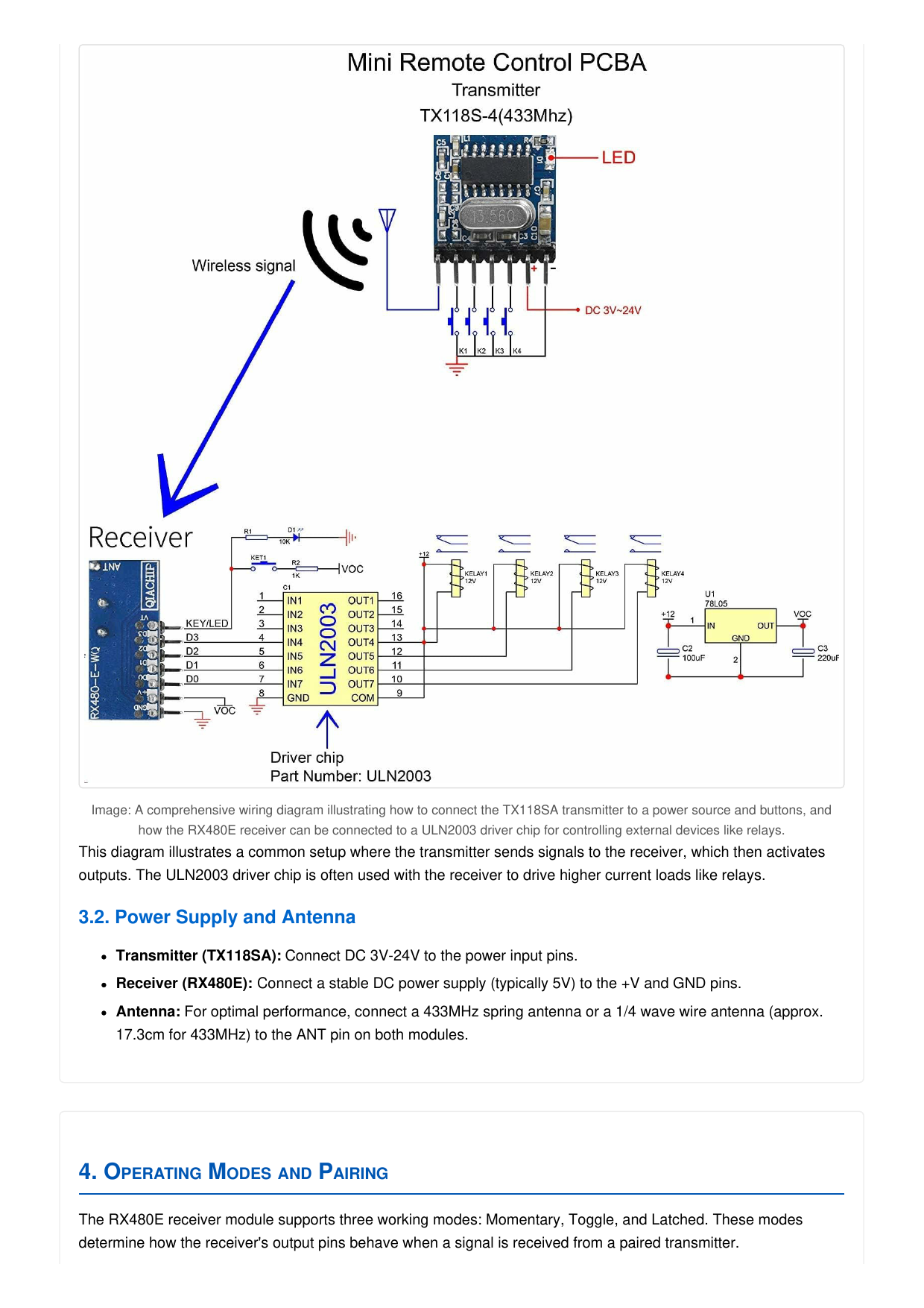

Image: A comprehensive wiring diagram illustrating how to connect the TX118SA transmitter to a power source and buttons, and how the RX480E receiver can be connected to a ULN2003 driver chip for controlling external devices like relays. This diagram illustrates a common setup where the transmitter sends signals to the receiver, which then activates outputs. The ULN2003 driver chip is often used with the receiver to drive higher current loads like relays.
3.2. Power Supply and Antenna Transmitter (TX118SA):
Connect DC 3V-24V to the power input pins.
Receiver (RX480E):
Connect a stable DC power supply (typically 5V) to the +V and GND pins.
Antenna:
For optimal performance, connect a 433MHz spring antenna or a 1/4 wave wire antenna (approx. 17.3cm for 433MHz) to the ANT pin on both modules.
