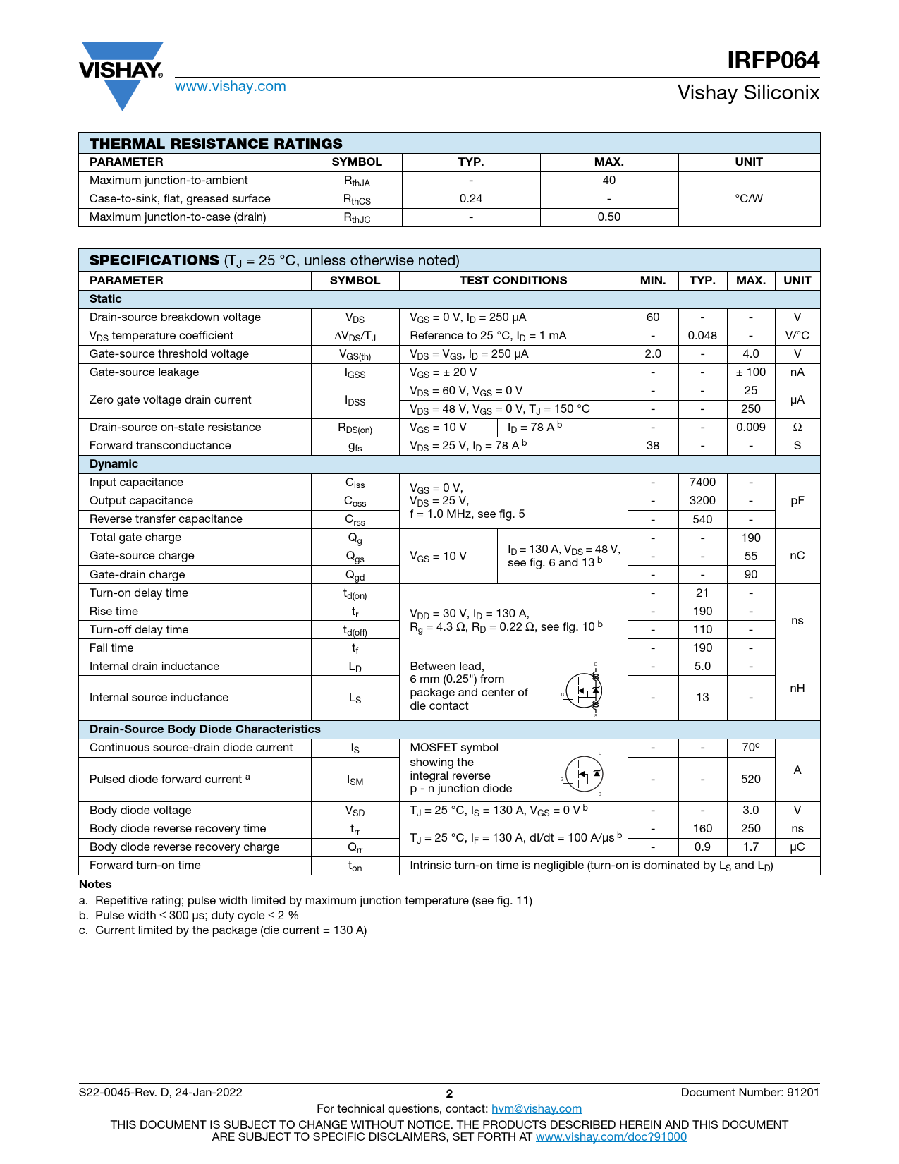

IRFP064
THERMAL RESISTANCE RATINGS PARAMETER SYMBOL TYP. MAX. UNIT
Maximum junction-to-ambient RthJA - 40 Case-to-sink, flat, greased surface RthCS 0.24 - °C/W Maximum junction-to-case (drain) RthJC - 0.50
SPECIFICATIONS
(TJ = 25 °C, unless otherwise noted)
PARAMETER SYMBOL TEST CONDITIONS MIN. TYP. MAX. UNIT Static
Drain-source breakdown voltage VDS VGS = 0 V, ID = 250 μA 60 - - V VDS temperature coefficient ΔVDS/TJ Reference to 25 °C, ID = 1 mA - 0.048 - V/°C Gate-source threshold voltage VGS(th) VDS = VGS, ID = 250 μA 2.0 - 4.0 V Gate-source leakage IGSS VGS = ± 20 V - - ± 100 nA VDS = 60 V, VGS = 0 V - - 25 Zero gate voltage drain current IDSS μA VDS = 48 V, VGS = 0 V, TJ = 150 °C - - 250 Drain-source on-state resistance RDS(on) VGS = 10 V ID = 78 A b - - 0.009 Ω Forward transconductance gfs VDS = 25 V, ID = 78 A b 38 - - S
Dynamic
Input capacitance Ciss V - 7400 - GS = 0 V, Output capacitance Coss VDS = 25 V, - 3200 - pF f = 1.0 MHz, see fig. 5 Reverse transfer capacitance Crss - 540 - Total gate charge Qg - - 190 I Gate-source charge Qgs V D = 130 A, VDS = 48 V, GS = 10 V - - 55 nC see fig. 6 and 13 b Gate-drain charge Qgd - - 90 Turn-on delay time td(on) - 21 - Rise time tr V - 190 - DD = 30 V, ID = 130 A, ns R Turn-off delay time t g = 4.3 Ω, RD = 0.22 Ω, see fig. 10 b d(off) - 110 - Fall time tf - 190 - Internal drain inductance L D D Between lead, - 5.0 - 6 mm (0.25") from package and center of nH Internal source inductance L G S - 13 - die contact S
Drain-Source Body Diode Characteristics
Continuous source-drain diode current IS MOSFET symbol - - 70c D showing the A integral reverse Pulsed diode forward current a I SM G - - 520 p - n junction diode S Body diode voltage VSD TJ = 25 °C, IS = 130 A, VGS = 0 V b - - 3.0 V Body diode reverse recovery time trr - 160 250 ns TJ = 25 °C, IF = 130 A, dI/dt = 100 A/μs b Body diode reverse recovery charge Qrr - 0.9 1.7 μC Forward turn-on time ton Intrinsic turn-on time is negligible (turn-on is dominated by LS and LD)
Notes
a. Repetitive rating; pulse width limited by maximum junction temperature (see fig. 11) b. Pulse width ≤ 300 μs; duty cycle ≤ 2 % c. Current limited by the package (die current = 130 A) S22-0045-Rev. D, 24-Jan-2022
