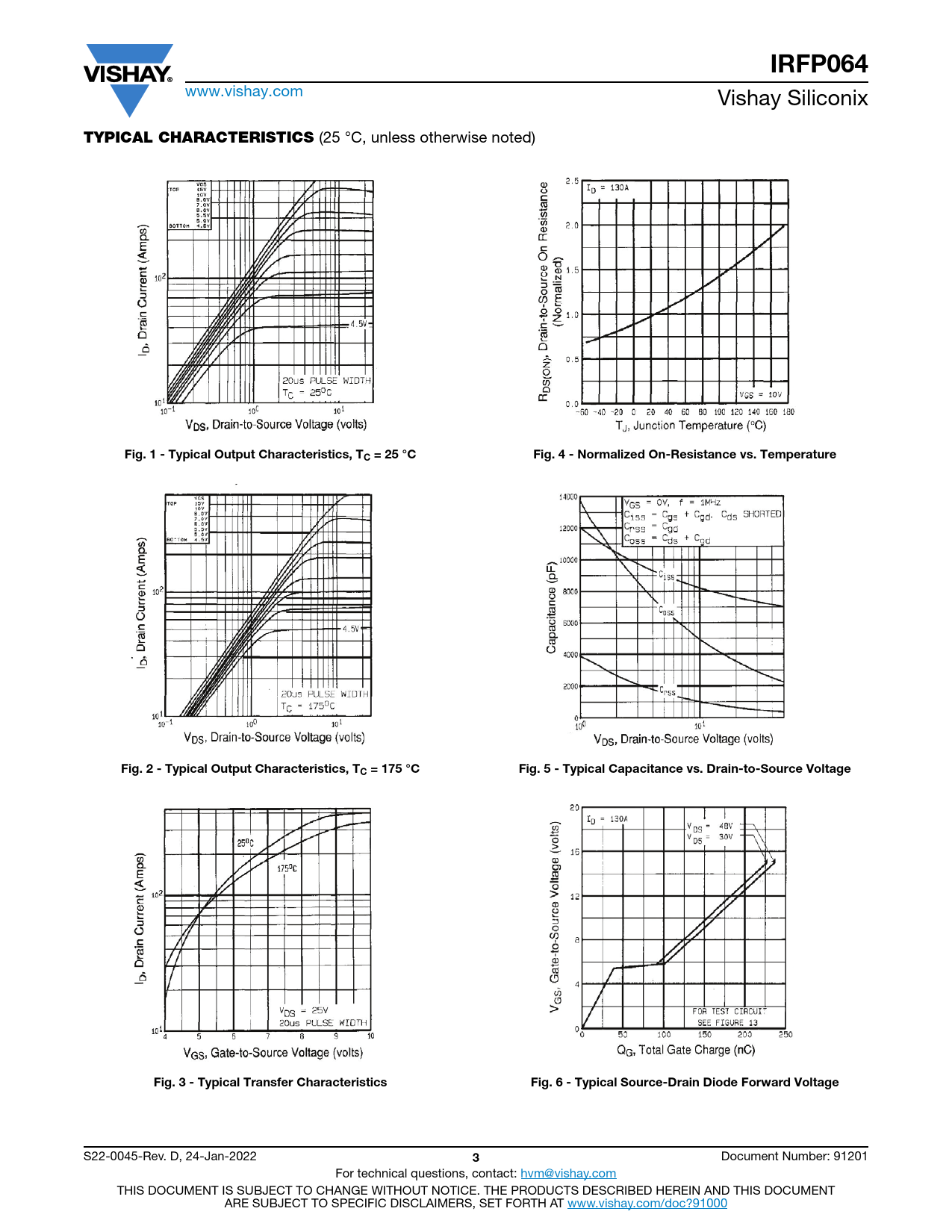

Pages / Page11 / 3 — IRFP064. TYPICAL CHARACTERISTICS. Fig. 1 - Typical Output …
IRFP064. TYPICAL CHARACTERISTICS. Fig. 1 - Typical Output Characteristics, TC = 25 °C
IRFP064 TYPICAL CHARACTERISTICS Fig 1 - Typical Output Characteristics, TC = 25 °C
IRFP064
(25 °C, unless otherwise noted)
Fig. 1 - Typical Output Characteristics, TC = 25 °C Fig. 4 - Normalized On-Resistance vs. Temperature Fig. 2 - Typical Output Characteristics, TC = 175 °C Fig. 5 - Typical Capacitance vs. Drain-to-Source Voltage Fig. 3 - Typical Transfer Characteristics Fig. 6 - Typical Source-Drain Diode Forward Voltage
