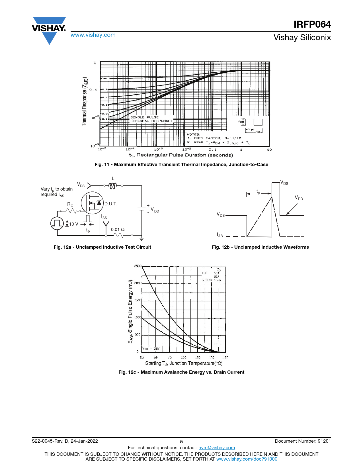

Pages / Page11 / 5 — IRFP064. Fig. 11 - Maximum Effective Transient Thermal Impedance, …
IRFP064. Fig. 11 - Maximum Effective Transient Thermal Impedance, Junction-to-Case
IRFP064 Fig 11 - Maximum Effective Transient Thermal Impedance, Junction-to-Case
IRFP064
L V VDS DS Vary tp to obtain t required I p AS VDD R D.U.T. G + V - DD V I DS AS 10 V t 0.01 p Ω IAS
Fig. 12a - Unclamped Inductive Test Circuit Fig. 12b - Unclamped Inductive Waveforms Fig. 12c - Maximum Avalanche Energy vs. Drain Current
