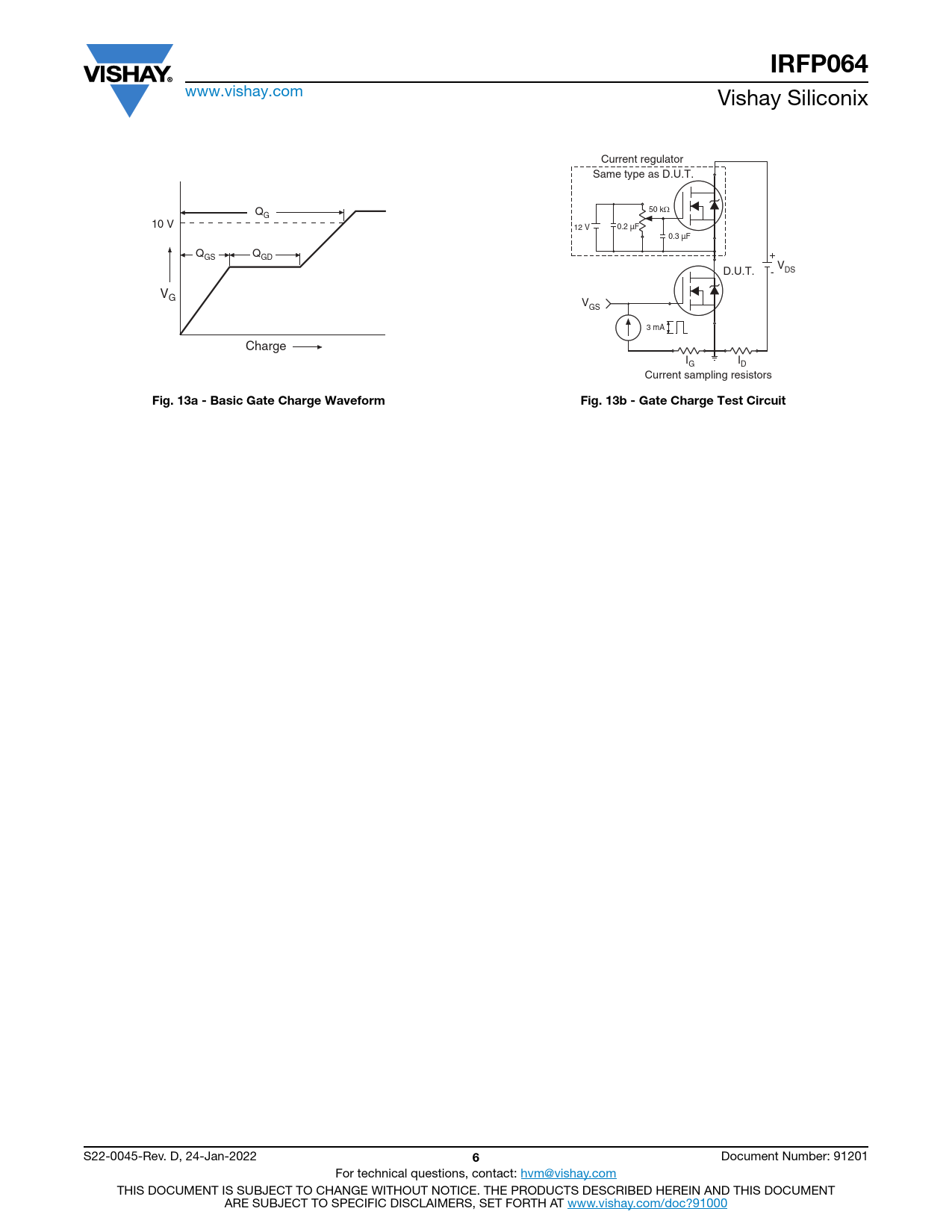

Pages / Page11 / 6 — IRFP064. Fig. 13a - Basic Gate Charge Waveform. Fig. 13b - Gate Charge …
IRFP064. Fig. 13a - Basic Gate Charge Waveform. Fig. 13b - Gate Charge Test Circuit
IRFP064 Fig 13a - Basic Gate Charge Waveform Fig 13b - Gate Charge Test Circuit
IRFP064
www.vishay.com Vishay Siliconix Current regulator Same type as D.U.T. Q 50 kΩ G 10 V 12 V 0.2 µF 0.3 µF Q Q GS GD + V D.U.T. DS - VG VGS 3 mA Charge I I G D Current sampling resistors
Fig. 13a - Basic Gate Charge Waveform Fig. 13b - Gate Charge Test Circuit
