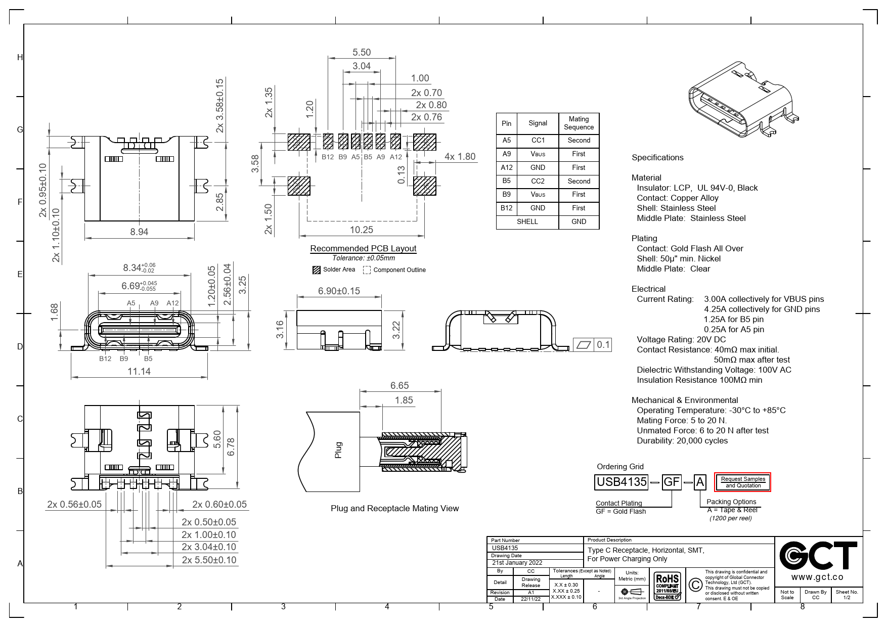

Datasheet USB4135 (GCT)
ManufacturerGCT
DescriptionType C USB Charging Connector
Pages / Page2 / 1 — www.gct.co
File Format / SizePDF / 177 Kb
www.gct.co
Datasheet USB4135 GCT
5.50 H 3.04 1.00 .15 5 2x 0.70 2x 0.80 2x 1.3 1.20 2x 0.76 Mating Pin Signal G Sequence 2x 3.58±0 A5 CC1 Second A9 VBUS First B12 B9 A5 B5 A9 A12 4x 1.80 Specifications A12 GND First .10 3.58 Material 0.13 B5 CC2 Second Insulator: LCP, UL 94V-0, Black B9 VBUS First Contact: Copper Alloy F 0 2.85 B12 GND First Shell: Stainless Steel .10 2x 0.95±0 Middle Plate: Stainless Steel SHELL GND 8.94 2x 1.5 10.25 Plating Recommended PCB Layout Contact: Gold Flash All Over 2x 1.10±0 Tolerance: ±0.05mm Shell: 50µ" min. Nickel 8.34+0.06 4 -0.02 5 Solder Area Component Outline Middle Plate: Clear E 6.69+0.045 -0.055 Electrical 3.25 6.90±0.15 Current Rating: 3.00A collectively for VBUS pins A5 A9 A12 1.20±0.0 2.56±0.0 4.25A collectively for GND pins 1.68 1.25A for B5 pin 0.25A for A5 pin 3.16 3.22 Voltage Rating: 20V DC D 0.1 Contact Resistance: 40mΩ max initial. B12 B9 B5 50mΩ max after test 11.14 Dielectric Withstanding Voltage: 100V AC Insulation Resistance 100MΩ min 6.65 1.85 Mechanical & Environmental Operating Temperature: -30°C to +85°C C Mating Force: 5 to 20 N. Unmated Force: 6 to 20 N after test Durability: 20,000 cycles 5.60 ug 6.78 Pl Ordering Grid Request Samples USB4135 GF A and Quotation B Packing Options Contact Plating 2x 0.56±0.05 2x 0.60±0.05 Plug and Receptacle Mating View A = Tape & Reel GF = Gold Flash (1200 per reel) 2x 0.50±0.05 2x 1.00±0.10 Part Number Product Description 2x 3.04±0.10 USB4135 Type C Receptacle, Horizontal, SMT, Drawing Date For Power Charging Only A 2x 5.50±0.10 21st January 2022 By CC Tolerances (Except as Noted) Units: This drawing is confidential and Length Angle
www.gct.co
Drawing Metric (mm) copyright of Global Connector Detail Release X.X ± 0.30 C Technology, Ltd (GCT). This drawing must not be copied X.XX ± 0.25 Revision - A1 or disclosed without written Not to Drawn By Sheet No. X.XXX ± 0.10 3rd Angle Projection Date 22/11/22 consent. E & OE Scale CC 1/2 1 2 3 4 5 6 7 8
