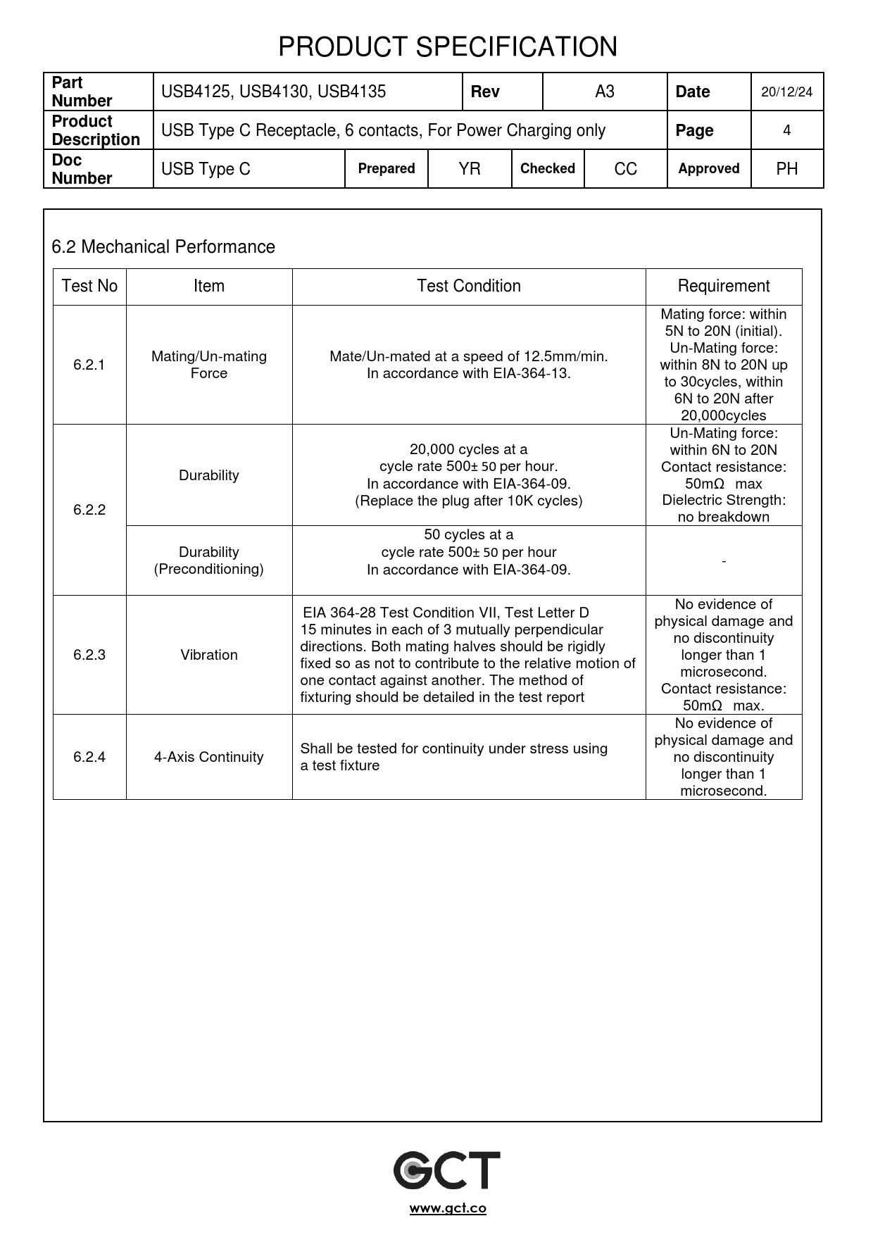

PRODUCT SPECIFICATION
Part
USB4125, USB4130, USB4135
Rev
A3
Date
20/12/24
Number Product
USB Type C Receptacle, 6 contacts, For Power Charging only
Page
4
Description Doc
USB Type C
Prepared
YR
Checked
CC
Approved
PH
Number
6.2 Mechanical Performance Test No Item Test Condition Requirement Mating force: within 5N to 20N (initial). Un-Mating force: Mating/Un-mating Mate/Un-mated at a speed of 12.5mm/min. 6.2.1 within 8N to 20N up Force In accordance with EIA-364-13. to 30cycles, within 6N to 20N after 20,000cycles Un-Mating force: 20,000 cycles at a within 6N to 20N cycle rate 500± 50 per hour. Contact resistance: Durability In accordance with EIA-364-09. 50mΩ max (Replace the plug after 10K cycles) Dielectric Strength: 6.2.2 no breakdown 50 cycles at a Durability cycle rate 500± 50 per hour - (Preconditioning) In accordance with EIA-364-09. No evidence of EIA 364-28 Test Condition VII, Test Letter D physical damage and 15 minutes in each of 3 mutually perpendicular no discontinuity directions. Both mating halves should be rigidly 6.2.3 Vibration longer than 1 fixed so as not to contribute to the relative motion of microsecond. one contact against another. The method of Contact resistance: fixturing should be detailed in the test report 50mΩ max. No evidence of physical damage and Shall be tested for continuity under stress using 6.2.4 4-Axis Continuity no discontinuity a test fixture longer than 1 microsecond.
