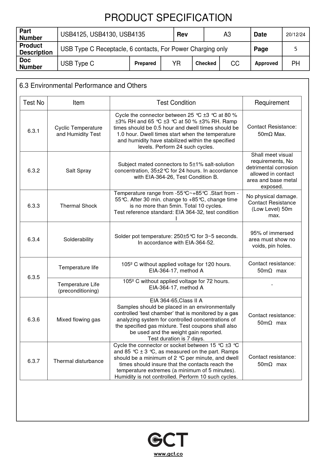

PRODUCT SPECIFICATION
Part
USB4125, USB4130, USB4135
Rev
A3
Date
20/12/24
Number Product
USB Type C Receptacle, 6 contacts, For Power Charging only
Page
5
Description Doc
USB Type C
Prepared
YR
Checked
CC
Approved
PH
Number
6.3 Environmental Performance and Others Test No Item Test Condition Requirement Cycle the connector between 25 °C ±3 °C at 80 % ±3% RH and 65 °C ±3 °C at 50 % ±3% RH. Ramp Cyclic Temperature times should be 0.5 hour and dwell times should be Contact Resistance: 6.3.1 and Humidity Test 1.0 hour. Dwell times start when the temperature 50mΩ Max. and humidity have stabilized within the specified levels. Perform 24 such cycles. Shall meet visual requirements, No Subject mated connectors to 5±1% salt-solution detrimental corrosion 6.3.2 Salt Spray concentration, 35±2°C for 24 hours. In accordance allowed in contact with EIA-364-26, Test Condition B. area and base metal exposed. Temperature range from -55°C~+85°C .Start from - No physical damage. 55°C. After 30 min. change to +85°C, change time Contact Resistance 6.3.3 Thermal Shock is no more than 5min. Total 10 cycles. (Low Level) 50m Test reference standard: EIA 364-32, test condition max. I 95% of immersed Solder pot temperature: 250±5°C for 3~5 seconds. 6.3.4 Solderability area must show no In accordance with EIA-364-52. voids, pin holes. 105º C without applied voltage for 120 hours. Contact resistance: Temperature life EIA-364-17, method A 50mΩ max 6.3.5 105º C without applied voltage for 72 hours. Temperature Life - EIA-364-17, method A (preconditioning) EIA 364-65,Class II A Samples should be placed in an environmentally controlled ‘test chamber’ that is monitored by a gas Contact resistance: 6.3.6 Mixed flowing gas analyzing system for controlled concentrations of 50mΩ max the specified gas mixture. Test coupons shall also be used and the weight gain reported. Test duration is 7 days. Cycle the connector or socket between 15 °C ±3 °C and 85 °C ± 3 °C, as measured on the part. Ramps should be a minimum of 2 °C per minute, and dwell Contact resistance: 6.3.7 Thermal disturbance times should insure that the contacts reach the 50mΩ max temperature extremes (a minimum of 5 minutes). Humidity is not controlled. Perform 10 such cycles.
