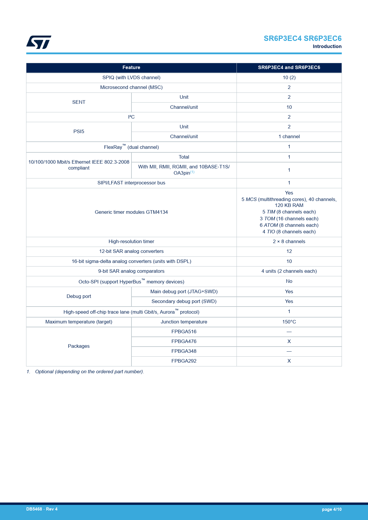

SR6P3EC4 SR6P3EC6. Introduction. Feature. SR6P3EC4 and SR6P3EC6. DB5468. Rev 4. page 4/10
SR6P3EC4 SR6P3EC6 Introduction Feature SR6P3EC4 and SR6P3EC6 DB5468 Rev 4 page 4/10
link to page 4 link to page 8 link to page 9 link to page 9 link to page 8 link to page 9
SPIQ (with LVDS channel) 10 (2) Microsecond channel (MSC) 2 Unit 2 SENT Channel/unit 10 I²C 2 Unit 2 PSI5 Channel/unit 1 channel FlexRay™ (dual channel) 1 Total 1 10/100/1000 Mbit/s Ethernet IEEE 802.3-2008 compliant With MII, RMII, RGMII, and 10BASE-T1S/ 1 OA3pin(1) SIPI/LFAST interprocessor bus 1 Yes 5 MCS (multithreading cores), 40 channels, 120 KB RAM Generic timer modules GTM4134 5 TIM (8 channels each) 3 TOM (16 channels each) 6 ATOM (8 channels each) 4 TIO (8 channels each) High-resolution timer 2 × 8 channels 12-bit SAR analog converters 12 16-bit sigma-delta analog converters (units with DSPL) 10 9-bit SAR analog comparators 4 units (2 channels each) Octo-SPI (support HyperBus™ memory devices) No Main debug port (JTAG+SWD) Yes Debug port Secondary debug port (SWD) Yes High-speed off-chip trace lane (multi Gbit/s, Aurora™ protocol) 1 Maximum temperature (target) Junction temperature 150°C FPBGA516 — FPBGA476 X Packages FPBGA348 — FPBGA292 X 1. Optional (depending on the ordered part number).
