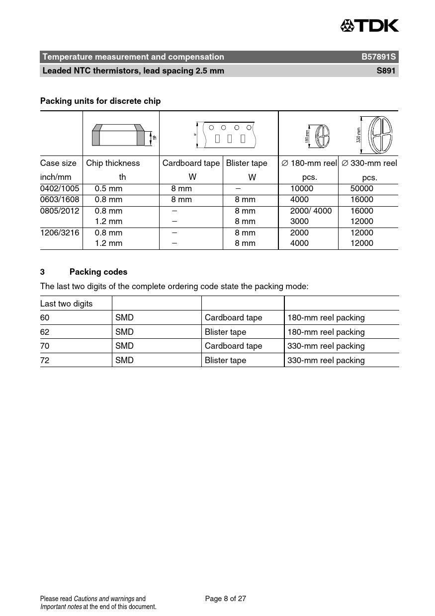

Temperature measurement and compensation. B57891S. Leaded NTC thermistors, lead spacing 2.5 mm. S891
Temperature measurement and compensation B57891S Leaded NTC thermistors, lead spacing 2.5 mm S891
Temperature measurement and compensation B57891S Leaded NTC thermistors, lead spacing 2.5 mm S891 Packing units for discrete chip
Case size Chip thickness Cardboard tape Blister tape ∅ 180-mm reel ∅ 330-mm reel inch/mm th W W pcs. pcs. 0402/1005 0.5 mm 8 mm 10000 50000 0603/1608 0.8 mm 8 mm 8 mm 4000 16000 0805/2012 0.8 mm 8 mm 2000/ 4000 16000 1.2 mm 8 mm 3000 12000 1206/3216 0.8 mm 8 mm 2000 12000 1.2 mm 8 mm 4000 12000
3 Packing codes
The last two digits of the complete ordering code state the packing mode: Last two digits 60 SMD Cardboard tape 180-mm reel packing 62 SMD Blister tape 180-mm reel packing 70 SMD Cardboard tape 330-mm reel packing 72 SMD Blister tape 330-mm reel packing Please read Cautions and warnings and Page 8 of 27 Important notes at the end of this document. Document Outline Cover
