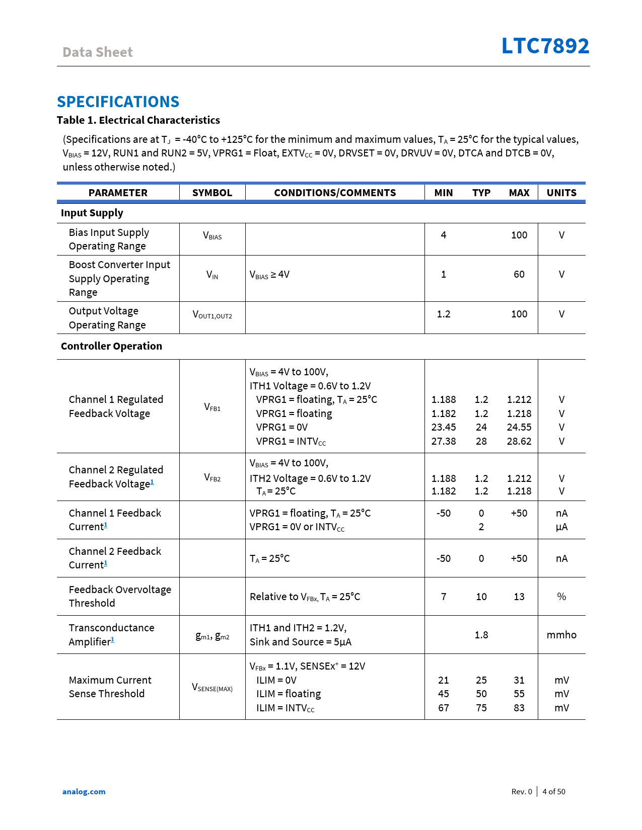

Data Sheet. LTC7892. SPECIFICATIONS Table 1. Electrical Characteristics. PARAMETER. SYMBOL. CONDITIONS/COMMENTS. MIN. TYP. MAX. UNITS
Data Sheet LTC7892 SPECIFICATIONS Table 1 Electrical Characteristics PARAMETER SYMBOL CONDITIONS/COMMENTS MIN TYP MAX UNITS
link to page 8 link to page 8 link to page 8 link to page 8
Data Sheet LTC7892 SPECIFICATIONS Table 1. Electrical Characteristics
(Specifications are at TJ = -40°C to +125°C for the minimum and maximum values, TA = 25°C for the typical values, VBIAS = 12V, RUN1 and RUN2 = 5V, VPRG1 = Float, EXTVCC = 0V, DRVSET = 0V, DRVUV = 0V, DTCA and DTCB = 0V, unless otherwise noted.)
PARAMETER SYMBOL CONDITIONS/COMMENTS MIN TYP MAX UNITS Input Supply
Bias Input Supply VBIAS 4 100 V Operating Range Boost Converter Input Supply Operating VIN VBIAS ≥ 4V 1 60 V Range Output Voltage VOUT1,OUT2 1.2 100 V Operating Range
Controller Operation
VBIAS = 4V to 100V, ITH1 Voltage = 0.6V to 1.2V Channel 1 Regulated VPRG1 = floating, T 1.188 1.2 1.212 V V A = 25°C Feedback Voltage FB1 VPRG1 = floating 1.182 1.2 1.218 V VPRG1 = 0V 23.45 24 24.55 V VPRG1 = INTVCC 27.38 28 28.62 V V Channel 2 Regulated BIAS = 4V to 100V, V Feedback Voltage
1
FB2 ITH2 Voltage = 0.6V to 1.2V 1.188 1.2 1.212 V TA = 25°C 1.182 1.2 1.218 V Channel 1 Feedback VPRG1 = floating, T -50 0 +50 nA A = 25°C Current
1
VPRG1 = 0V or INTVCC 2 µA Channel 2 Feedback T Current
1
A = 25°C -50 0 +50 nA Feedback Overvoltage Relative to V Threshold FBx, TA = 25°C 7 10 13 % Transconductance ITH1 and ITH2 = 1.2V, g 1.8 mmho Amplifier
1
m1, gm2 Sink and Source = 5µA VFBx = 1.1V, SENSEx+ = 12V Maximum Current ILIM = 0V 21 25 31 mV V Sense Threshold SENSE(MAX) ILIM = floating 45 50 55 mV ILIM = INTVCC 67 75 83 mV
