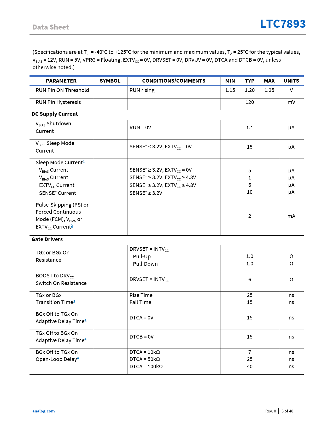

Data Sheet LTC7893
(Specifications are at TJ = -40°C to +125°C for the minimum and maximum values, TA = 25°C for the typical values, VBIAS = 12V, RUN = 5V, VPRG = Floating, EXTVCC = 0V, DRVSET = 0V, DRVUV = 0V, DTCA and DTCB = 0V, unless otherwise noted.)
PARAMETER SYMBOL CONDITIONS/COMMENTS MIN TYP MAX UNITS
RUN Pin ON Threshold RUN rising 1.15 1.20 1.25 V RUN Pin Hysteresis 120 mV
DC Supply Current
VBIAS Shutdown RUN = 0V 1.1 µA Current VBIAS Sleep Mode SENSE+ < 3.2V, EXTV Current CC = 0V 15 µA Sleep Mode Current
2
VBIAS Current SENSE+ ≥ 3.2V, EXTVCC = 0V 5 µA VBIAS Current SENSE+ ≥ 3.2V, EXTVCC ≥ 4.8V 1 µA EXTVCC Current SENSE+ ≥ 3.2V, EXTVCC ≥ 4.8V 6 µA SENSE+ Current SENSE+ ≥ 3.2V 10 µA Pulse-Skipping (PS) or Forced Continuous Mode (FCM), V 2 mA BIAS or EXTVCC Current
2 Gate Drivers
DRVSET = INTV TGx or BGx On CC 1.0 Ω Resistance Pull-Up Pull-Down 1.0 Ω BOOST to DRVCC DRVSET = INTV Switch On Resistance CC 6 Ω TGx or BGx Rise Time 25 ns Transition Time
3
Fall Time 15 ns BGx Off to TGx On DTCA = 0V 15 ns Adaptive Delay Time
4
TGx Off to BGx On DTCB = 0V 15 ns Adaptive Delay Time
4
BGx Off to TGx On DTCA = 10kΩ 7 ns Open-Loop Delay
4
DTCA = 50kΩ 25 ns DTCA = 100kΩ 40 ns
