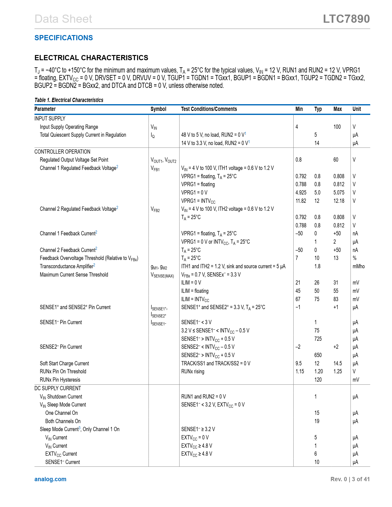

DescriptionLow IQ, Dual, 2-Phase Synchronous Step-Down Controller for GaN FETs in 40-Lead QFN (6mm x 6mm, Plastic Side Wettable) package
Pages / Page41 / 3 — LTC7890. SPECIFICATIONS. ELECTRICAL CHARACTERISTICS. Table 1. Electrical …
LTC7890. SPECIFICATIONS. ELECTRICAL CHARACTERISTICS. Table 1. Electrical Characteristics. Parameter. Symbol
LTC7890 SPECIFICATIONS ELECTRICAL CHARACTERISTICS Table 1 Electrical Characteristics Parameter Symbol
link to page 5 link to page 5 link to page 5 link to page 5 link to page 5 link to page 5 link to page 5 link to page 5 Data Sheet
TJ = −40°C to +150°C for the minimum and maximum values, TA = 25°C for the typical values, VIN = 12 V, RUN1 and RUN2 = 12 V, VPRG1 = floating, EXTVCC = 0 V, DRVSET = 0 V, DRVUV = 0 V, TGUP1 = TGDN1 = TGxx1, BGUP1 = BGDN1 = BGxx1, TGUP2 = TGDN2 = TGxx2, BGUP2 = BGDN2 = BGxx2, and DTCA and DTCB = 0 V, unless otherwise noted.
Table 1. Electrical Characteristics Parameter Symbol Test Conditions/Comments Min Typ Max Unit
INPUT SUPPLY Input Supply Operating Range VIN 4 100 V Total Quiescent Supply Current in Regulation IQ 48 V to 5 V, no load, RUN2 = 0 V1 5 μA 14 V to 3.3 V, no load, RUN2 = 0 V1 14 μA CONTROLLER OPERATION Regulated Output Voltage Set Point VOUT1, VOUT2 0.8 60 V Channel 1 Regulated Feedback Voltage2 VFB1 VIN = 4 V to 100 V, ITH1 voltage = 0.6 V to 1.2 V VPRG1 = floating, TA = 25°C 0.792 0.8 0.808 V VPRG1 = floating 0.788 0.8 0.812 V VPRG1 = 0 V 4.925 5.0 5.075 V VPRG1 = INTVCC 11.82 12 12.18 V Channel 2 Regulated Feedback Voltage2 VFB2 VIN = 4 V to 100 V, ITH2 voltage = 0.6 V to 1.2 V TA = 25°C 0.792 0.8 0.808 V 0.788 0.8 0.812 V Channel 1 Feedback Current2 VPRG1 = floating, TA = 25°C –50 0 +50 nA VPRG1 = 0 V or INTVCC, TA = 25°C 1 2 µA Channel 2 Feedback Current2 TA = 25°C –50 0 +50 nA Feedback Overvoltage Threshold (Relative to VFBx) TA = 25°C 7 10 13 % Transconductance Amplifier2 gM1, gM2 ITH1 and ITH2 = 1.2 V, sink and source current = 5 μA 1.8 mMho Maximum Current Sense Threshold VSENSE(MAX) VFBx = 0.7 V, SENSEx− = 3.3 V ILIM = 0 V 21 26 31 mV ILIM = floating 45 50 55 mV ILIM = INTVCC 67 75 83 mV SENSE1+ and SENSE2+ Pin Current ISENSE1+, SENSE1+ and SENSE2+ = 3.3 V, TA = 25°C −1 +1 μA ISENSE2+ SENSE1– Pin Current ISENSE1– SENSE1– < 3 V 1 μA 3.2 V ≤ SENSE1– < INTVCC – 0.5 V 75 μA SENSE1– > INTVCC + 0.5 V 725 μA SENSE2– Pin Current SENSE2– < INTVCC – 0.5 V –2 +2 μA SENSE2– > INTVCC + 0.5 V 650 μA Soft Start Charge Current TRACK/SS1 and TRACK/SS2 = 0 V 9.5 12 14.5 μA RUNx Pin On Threshold RUNx rising 1.15 1.20 1.25 V RUNx Pin Hysteresis 120 mV DC SUPPLY CURRENT VIN Shutdown Current RUN1 and RUN2 = 0 V 1 μA VIN Sleep Mode Current SENSE1− < 3.2 V, EXTVCC = 0 V One Channel On 15 µA Both Channels On 19 µA Sleep Mode Current3, Only Channel 1 On SENSE1– ≥ 3.2 V VIN Current EXTVCC = 0 V 5 µA VIN Current EXTVCC ≥ 4.8 V 1 µA EXTVCC Current EXTVCC ≥ 4.8 V 6 µA SENSE1– Current 10 µA
