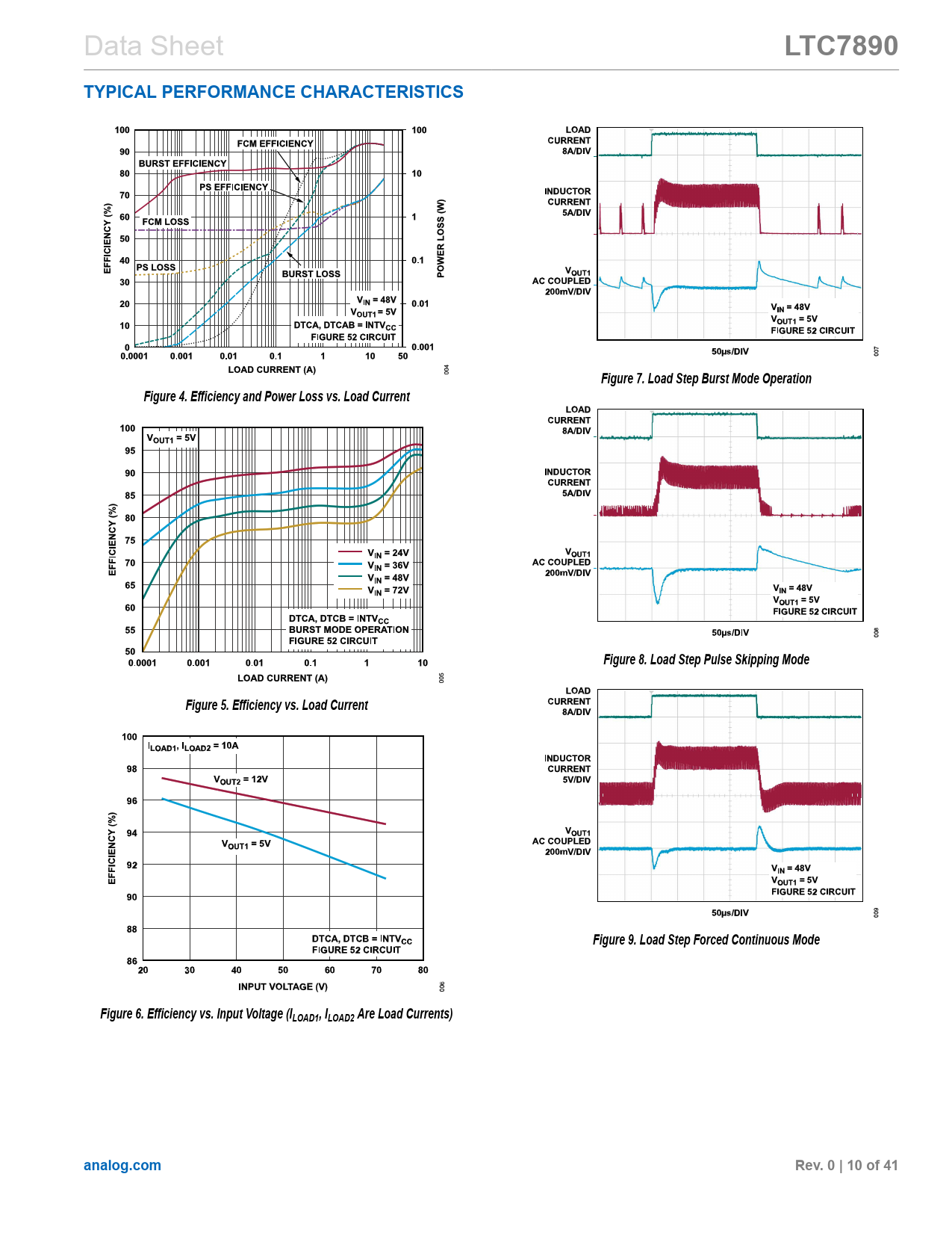

Pages / Page41 / 10 — LTC7890. TYPICAL PERFORMANCE CHARACTERISTICS. Figure 7. Load Step Burst …
LTC7890. TYPICAL PERFORMANCE CHARACTERISTICS. Figure 7. Load Step Burst Mode Operation
LTC7890 TYPICAL PERFORMANCE CHARACTERISTICS Figure 7 Load Step Burst Mode Operation
Data Sheet
LTC7890 TYPICAL PERFORMANCE CHARACTERISTICS Figure 7. Load Step Burst Mode Operation Figure 4. Efficiency and Power Loss vs. Load Current Figure 8. Load Step Pulse Skipping Mode Figure 5. Efficiency vs. Load Current Figure 9. Load Step Forced Continuous Mode Figure 6. Efficiency vs. Input Voltage (ILOAD1, ILOAD2 Are Load Currents) analog.com Rev. 0 | 10 of 41
